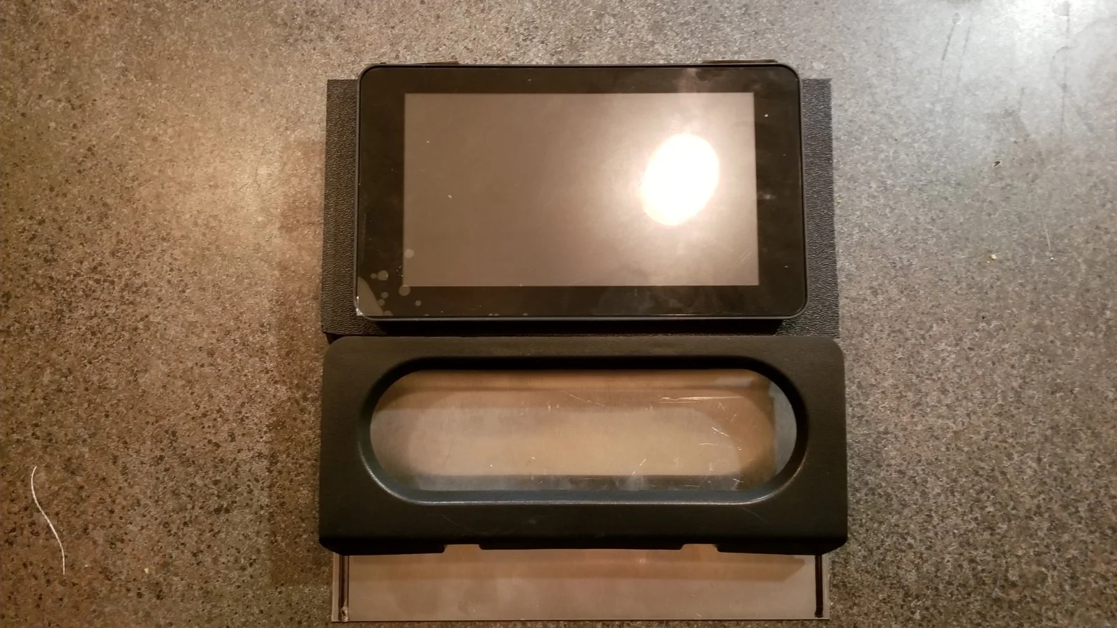

Working on the infotainment system with a 7" touch display. Of course custom install, looking for ideas this is version1 AC controls below screen with just enough room to maybe fit a 1/2 din eq under the ac controls.
I already bent the aluminum plate with my break, I quickly realized the break is much larger than useful on this project.... had to improvise for the second bend.

Do you need a console for mock up?
a91what
SendMeUrDataLog
Apr 6, 2011
10,733
6,716
214
Hillsborough county
Jul 21, 2019
#3,536
  • Jul 21, 2019
  • #3,536
It would not hurt, I have to leave next weekend.... damn work out of town

I had a TFT 7" screen in one of my mustangs for front and rear camera view...and video. It fit nicely in the factory radio and cubby location. Just made a frame with plastic and velcro held it.
