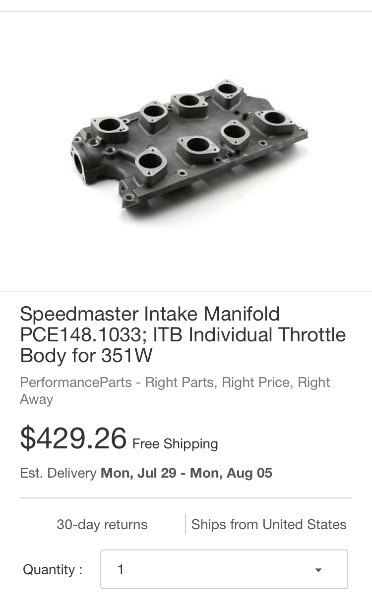

Hmm... apparently the itb will idle better and lower than a common plenum intake manifold. More cam acts tamer on ITB.
I am smiling inside.
So something like this for the lower and quad mini spool turbos for the upper.
Sounds wicked, shame the blower combination is going away. Always liked the way it turned out.
