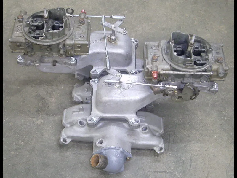

1)Hillborn (because it’s different and awesome)
Olivethefet said:
I think the Hillborn would look awesome under the hood.
Heil yeah!
You all know how cool it is
The Jolley High Rise is bad ass but most
Other options just don't have the visual appeal,
This might have worked in the 60s .......
LOL

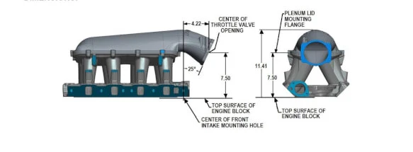

Just got done taking measurements, I have 13.75" of clearance from the china wall to the hood on the front of the block. with the 9.5" deck I will assume I lose 1.5" of this clearance.
Now lets figure out how tall that holley Hi-Ram is, https://www.holley.com/products/intakes/efi_manifolds/parts/300-242 ....
11.41" tall roughly over the distributor [ that i am not using]
I think it will fit with my current hood, and look very modern. With my LS coil packs mounted on the valve covers at first glance this may look like an LS.
BTW... this is way easier to add a turbo or vortec to in the future.
Reactions: stanglx2002, KZGUNS and General karthief

I for sure vote to go this route with the combo you are putting together, and we all know you will be adding more later in the future. This gives you that growth capability without needing to replace a bunch of parts.
It also adds to the unique factor as you dont see this on every car either. I remember when this intake came out and really wanted one on my car before the change of scope of the car.

I have chosen, it will be the holley hi ram with 92mm TB... all powder coated black for the win. this was an easy sell for me as all the sensors on my new MS3pro harness are GM connectors.
