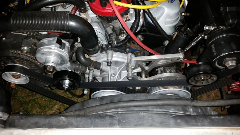

Got the headers on and re-pullied the sc. Man a 1.9" pull is tiny, put the stock alt bracket back on and used the aftermarket piece (with some modifications) as a mount for bracing of the SC mount. Pics to come it's too dark out now.
It has been awhile since I heard shorty headers, they sound kinda pingy..... I know my timing is good I verified it... weird maybe it's just me. used to longtubes.
On a side note, just blipping the throttle in the driveway saw 5psi. Lol that is promising.

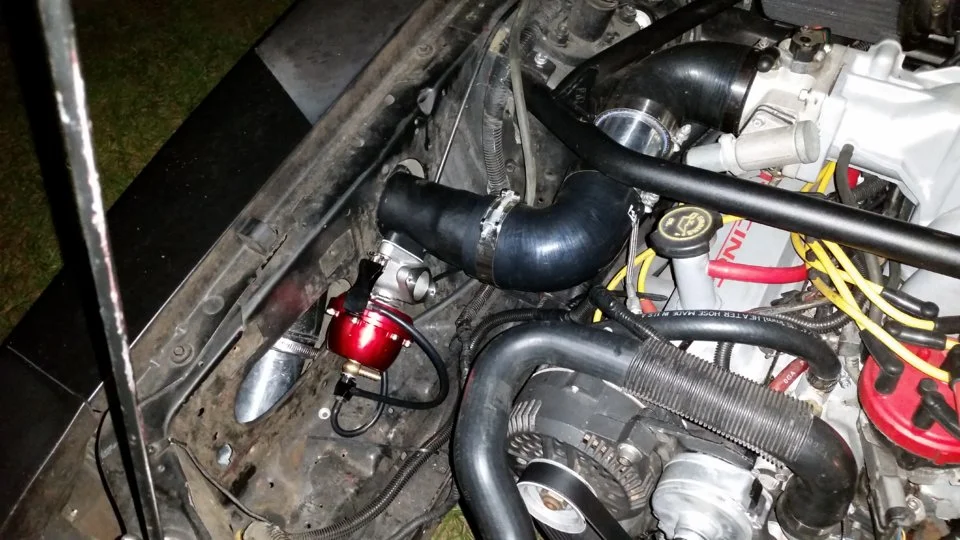

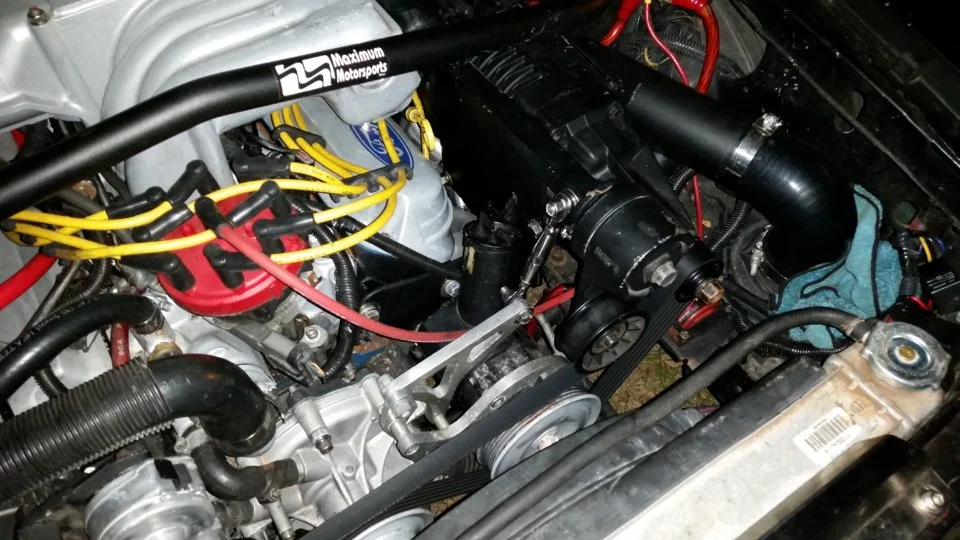

Got it figured out. The guy doing the tuning has no idea what he was doing........ and set stuff up wrong. So I fired me. Now I'm doing it myself. wait what....
Anywho she is running amazing, still tuning drove her around for 45mins today data logging.
Got the second tensioner in there and the wastegate, it works well although it is undersized (38mm) should have ordered a 45 or larger. Saw 5.6# of boost on the logger from my run today. That's my lowest boost setting, should see 11 full tilt but with belt slip maybe 9..
It is just rigged together right now while I get some issues worked out (wanted to make sure this setup worked before dishing out a lot of money) now I can move forward with confidence that this system will perform.
Pictures of my ghetto rigging soon no daylight left. Maybe even a video of the car running too.

this is rigged up for now but the concept works great. I plan on redoing all of this but for testing couplers are a cinch.
