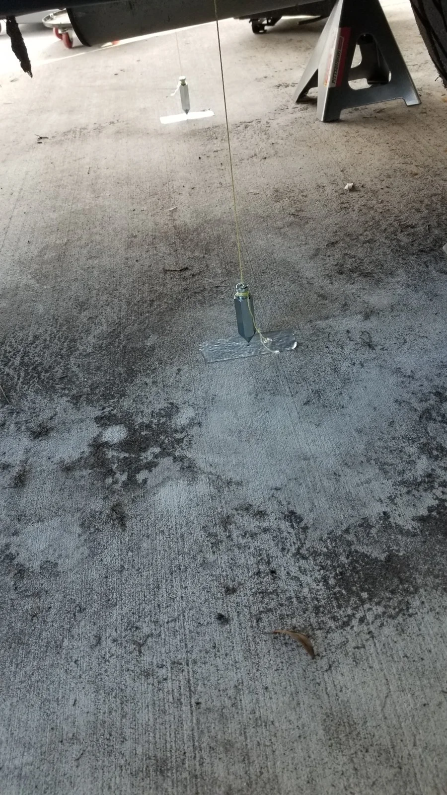

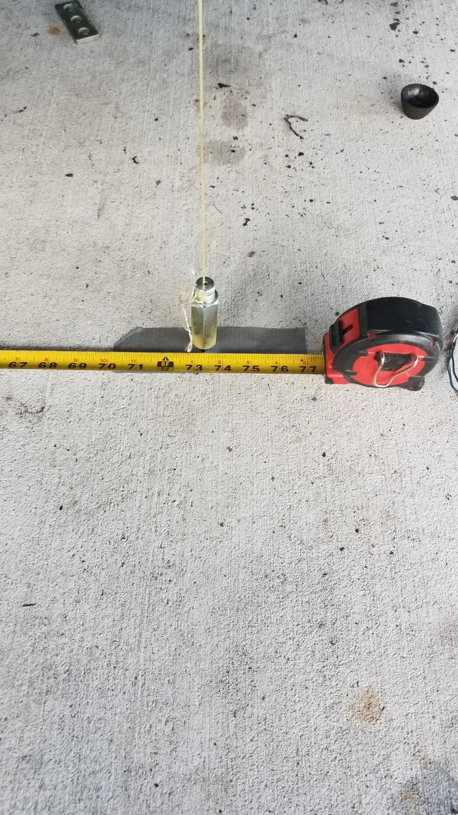

Today I started the task of squaring the k member. I first went and acquired 2 plumbbob, then I started with the rear control arm bolts.
Once they were marked on the ground I moved to the k member, there are two holes in the UPR kmember just forward of the rear most mounting bolts to hang the string from. Then I took my measurements..
The k is so close I dare not move it at all. Not bad for eyeballing.

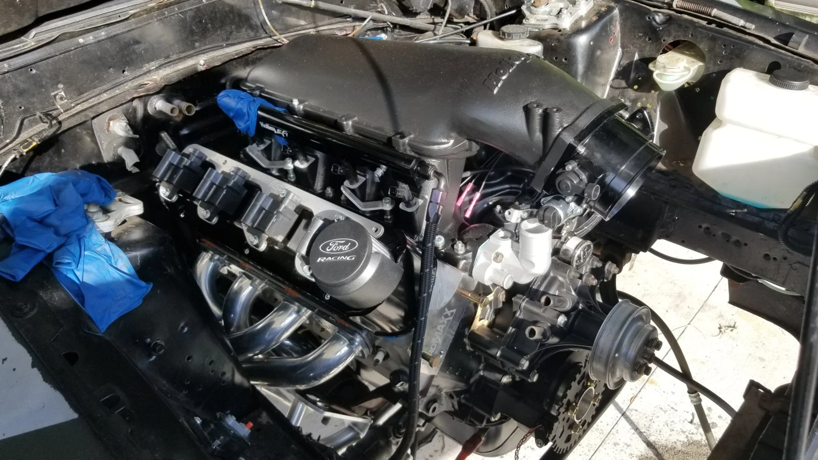

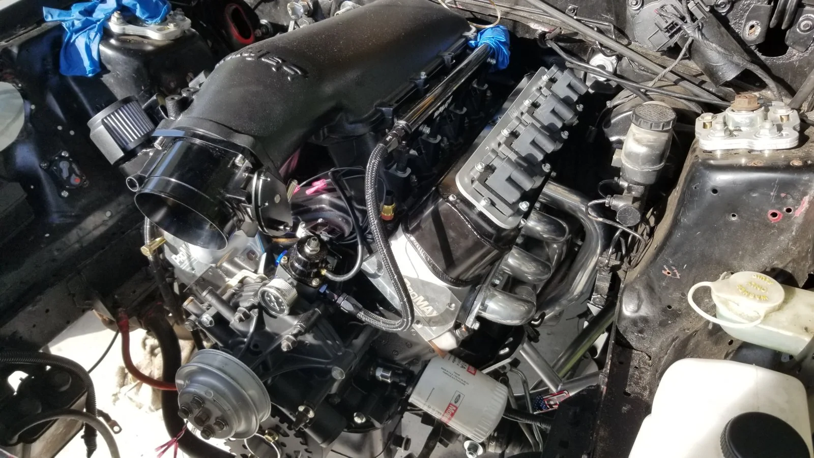

Only had a short time this morning to work on the car, I got the k-member swapped out but have not squared it in the car yet. The factory A arms worked out just fine and I only had a small bit of difficulty with the driver side arm getting it in place. Overall I would say a difficulty of 4 to swap the K out overall. I did space it down 3/8 of an inch and after removing the crown from the oil pan I have around 3/16 clearance. Should be adequate.
There is so much room around the engine its unreal... i can almost drop the header in with the engine in place, once i lift the engine the header will be cake.. so much so that i wish i had not cut the flange to separate the pipes.
