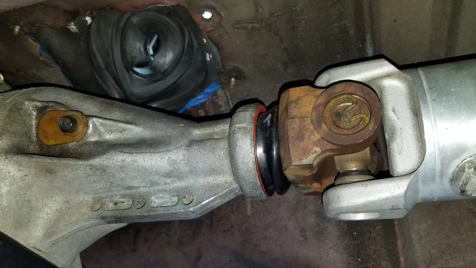

I am concerned the driveshaft is too long.... with the suspension loaded I only have a 1/4" of movement, I was barely able to get the driveshaft into place.. I think I will be ok but am looking for assurance, if not I will have to find a place to modify the DS.
I'm in the same place. In the old config, the drive shaft hung out about 1/2" ( maybe?) even that far out, I think the balancer ring compressed the rubber seal, at some part of the drive, and allowed it to leak. But I could get the driveshaft in/out with no problem. The driveshaft is in as deep as it goes at ride height weighted. Under accel or deceleration, the rear is either pulling up or nosing down, and in both instances pulling the d/s out of the trans.

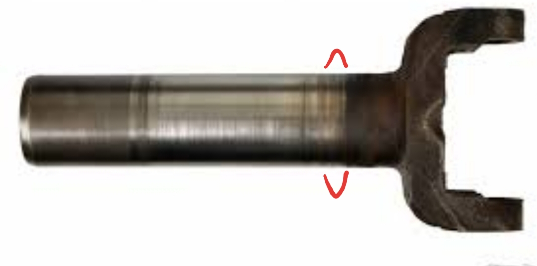

Hey look man....you've built some awesome stuff. Back in the day we used to modify our own drive shafts. Never had an issue....especially if its steel. Just grind the weld off the tube for the u joint flange. The u joint flange cup thingy slides inside the drive shaft. Usually, it can be pulled or tapped out with a medium hammer. Cut the shaft tube square. Clean the metal up and lay the shaft in angle iron to hold it straight. We would ratchet strap the angle iron to the shaft and tack weld...then finish weld. We would mark the orientation of the u joint to shaft before disassembly. Never had an issue with vibration.
I did not shorten my aluminum shaft that's on my car now myself. I had a place called Tex Welding outside of baltimore do it for me. I think they took 3/4 in. out of it. They didn't balance it and I have no issues with vibration. It's a Ford Racing driveshaft.
Could chop up a factory driveshaft to experiment with. I'm sure someone had one layin' around. Probably under a parts car convertible taking up space in their yard. Karthief may have something like that.
...or...get the pros to do it.
In actuality the driveshaft doesn't move that much. I shortened mine just to get the seal to ride in the same place when I put in my IRS. Didn't like how close it was to the u joint but a bunch of folks have no issue. The SRA moves more than IRS.
The control arm arch does move the rear away from the trans in full droop. During a hard launch the rear twists and pushes on the bushings making up some of that movement. You can usually see the wear pattern is on the yoke from the seal.
That should be the pattern from the seal lip

This is what I have right now with suspension loaded... not cool.

Not cool...and aluminum driveshaft....makes my long ars thread useless. That is a little scary. Is there any way to move the engine forward ? Maybe get an extra .5 from opening up the engine mount holes. That would also move the header .5 on the shaft. No bueno
