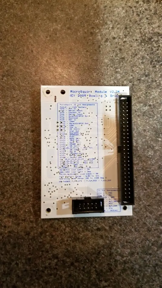

Tcu case is far to large for my liking.. so I am removing the micro module from the mainboard and placing it in a custom 3d printed case courtesy of DD-efi.com it will shrink the footprint of the tcu by 80%. I am excited, this will let me mount it virtually anywhere under the center console. The entire unit will fit in the palm of my hand and only be a smidge over an inch thick.

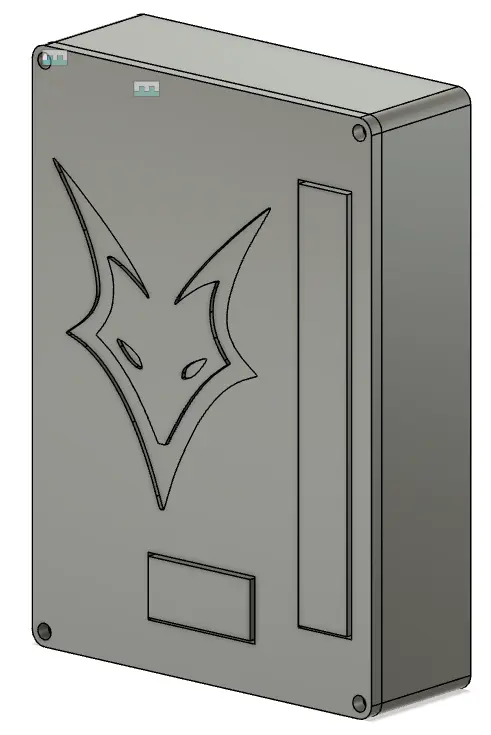

Current mock-up of the enclosure:

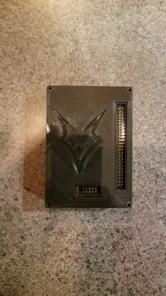

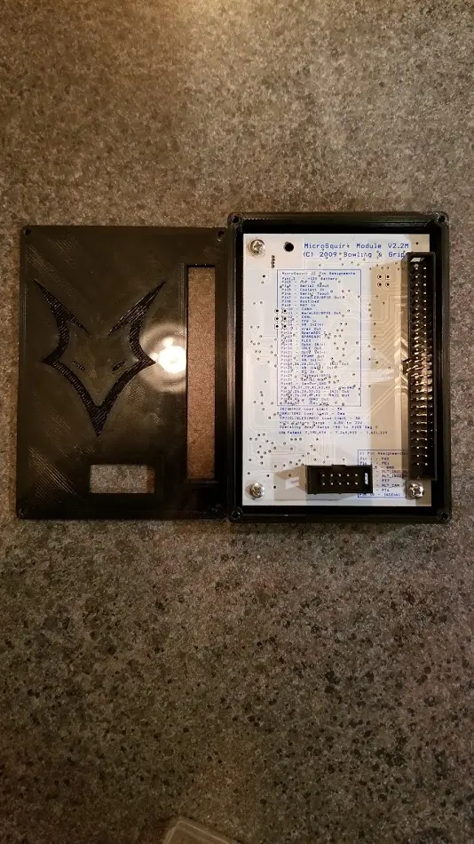

I have the TCU case and assembled it, I am currently working on the wiring harness. I will tell you soldering to a ribbon cable is a real pita!
I will post a picture of the completed harness when I get the weatherpack connectors in should be very soon.
and thanks again to @stanglx2002 and DD-EFI for making the custom TCU case possible.

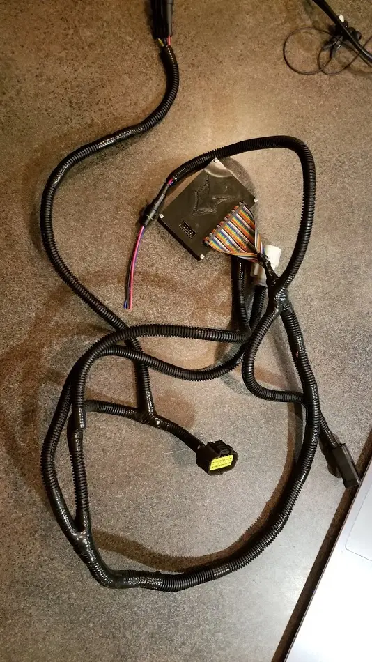

And the completed harness, all connections are soldered and I used weather pack connectors for everything. Harness is ready for installation, just need an OD cancel button and tie a relay for ground switch input for the Lock-up cancel from the brake switch.
For reference the TCU is smaller than my phone.

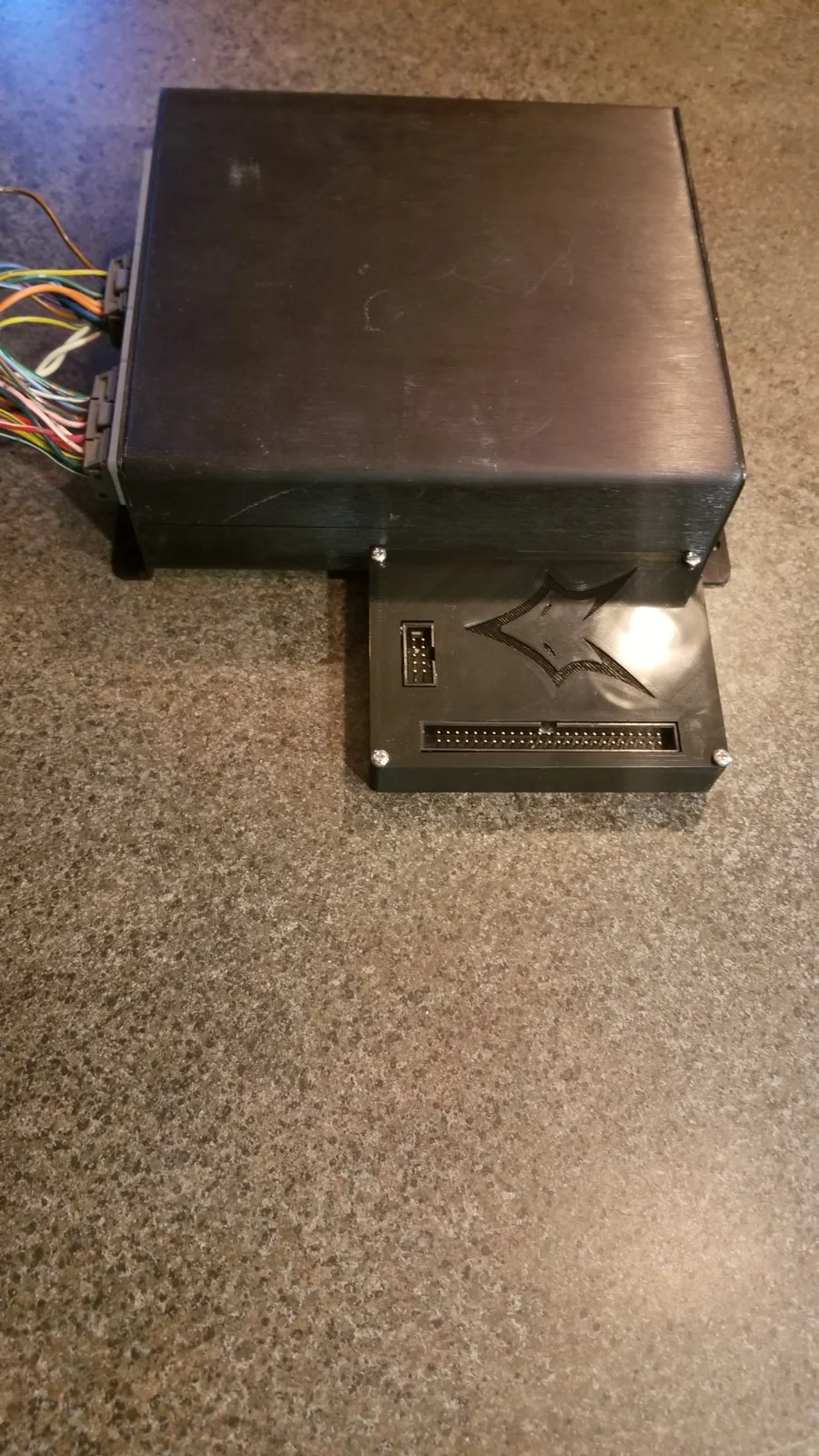

Look pretty... That case came out nice
Do you have a side-by-side of the old case to the new one?

Nov 1, 2019

wow what a difference!!!

The old case has a full board to build out transistor circuits ect.. along with a break out board for adding plugs for the stock harness. I just need the microsquirt module that runs the operation, it has on board circuits I am using to make this happen. So strip away all the extra and you have a module the size of a credit card.
