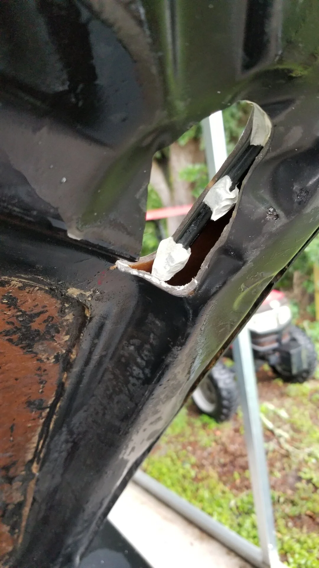

I also ordered a nice set of locking AeroCatch pins for my new hood, I managed to score a nice 4" cowl hood for cheap. I also found a coupe trunk lid, so that saves me a ton of bodywork on the current one.
They are nice, but a pain to install..you will be cutting through the top skin, and the substructure, but the cut on the underside has to be bigger than the top to allow you access to the holes that the bolts go through. And it all has to be done perfectly to match up to the pin location.
Not for the faint of heart.

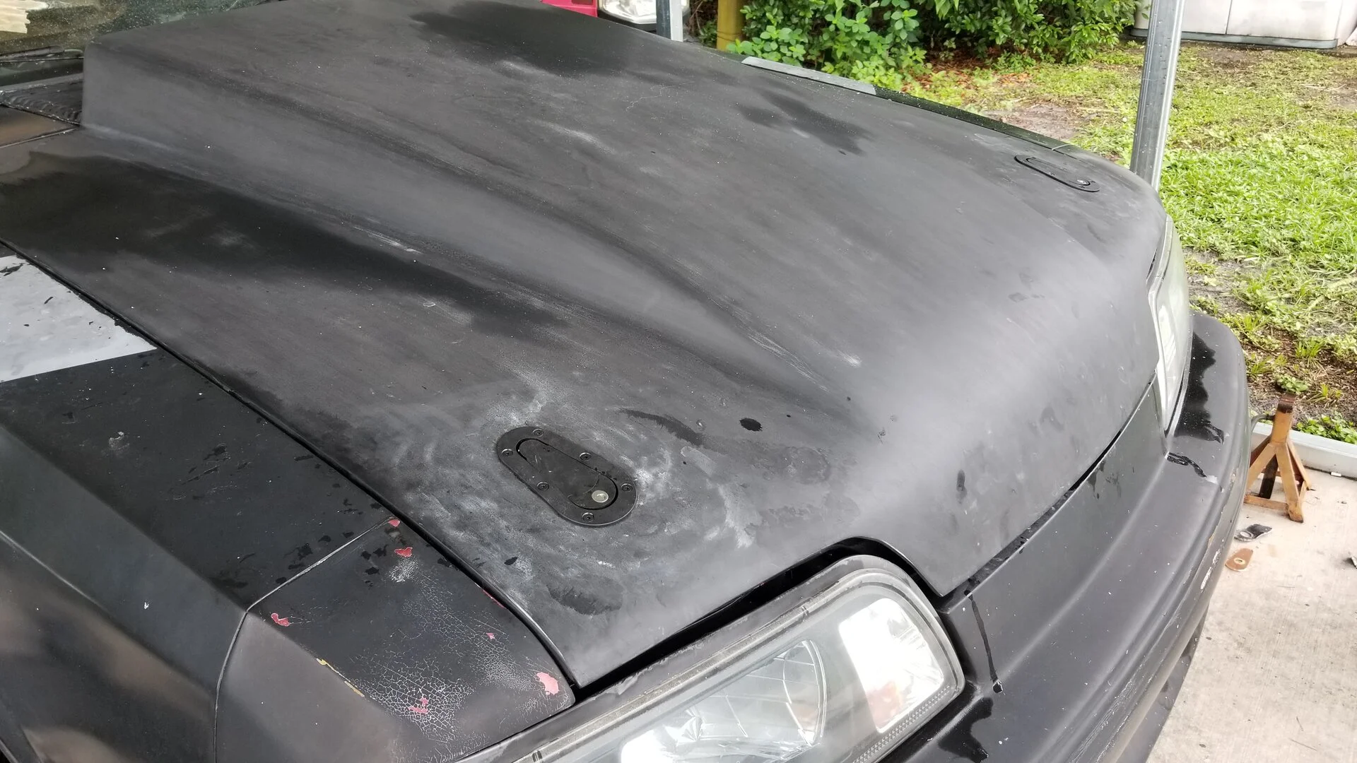

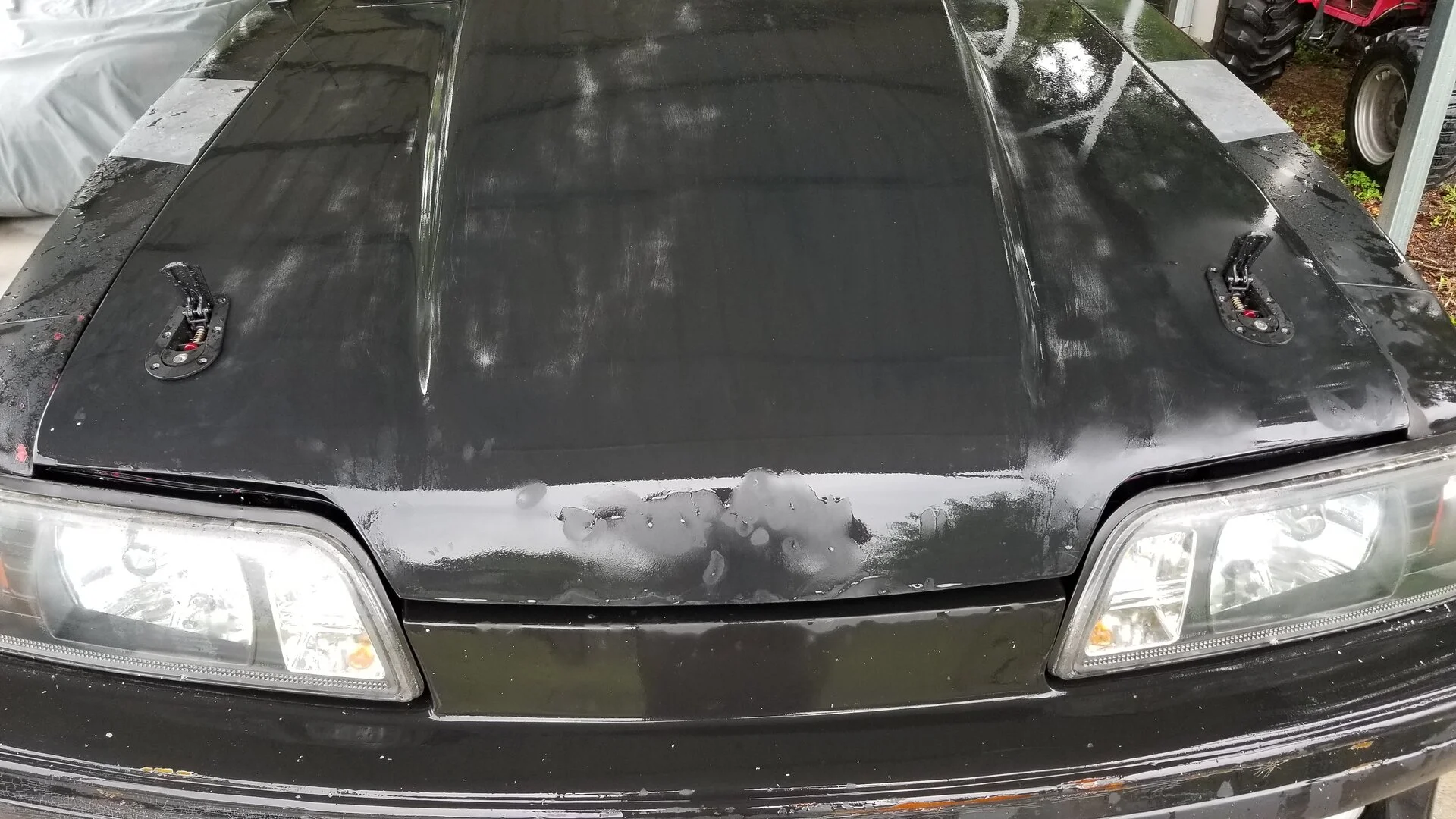

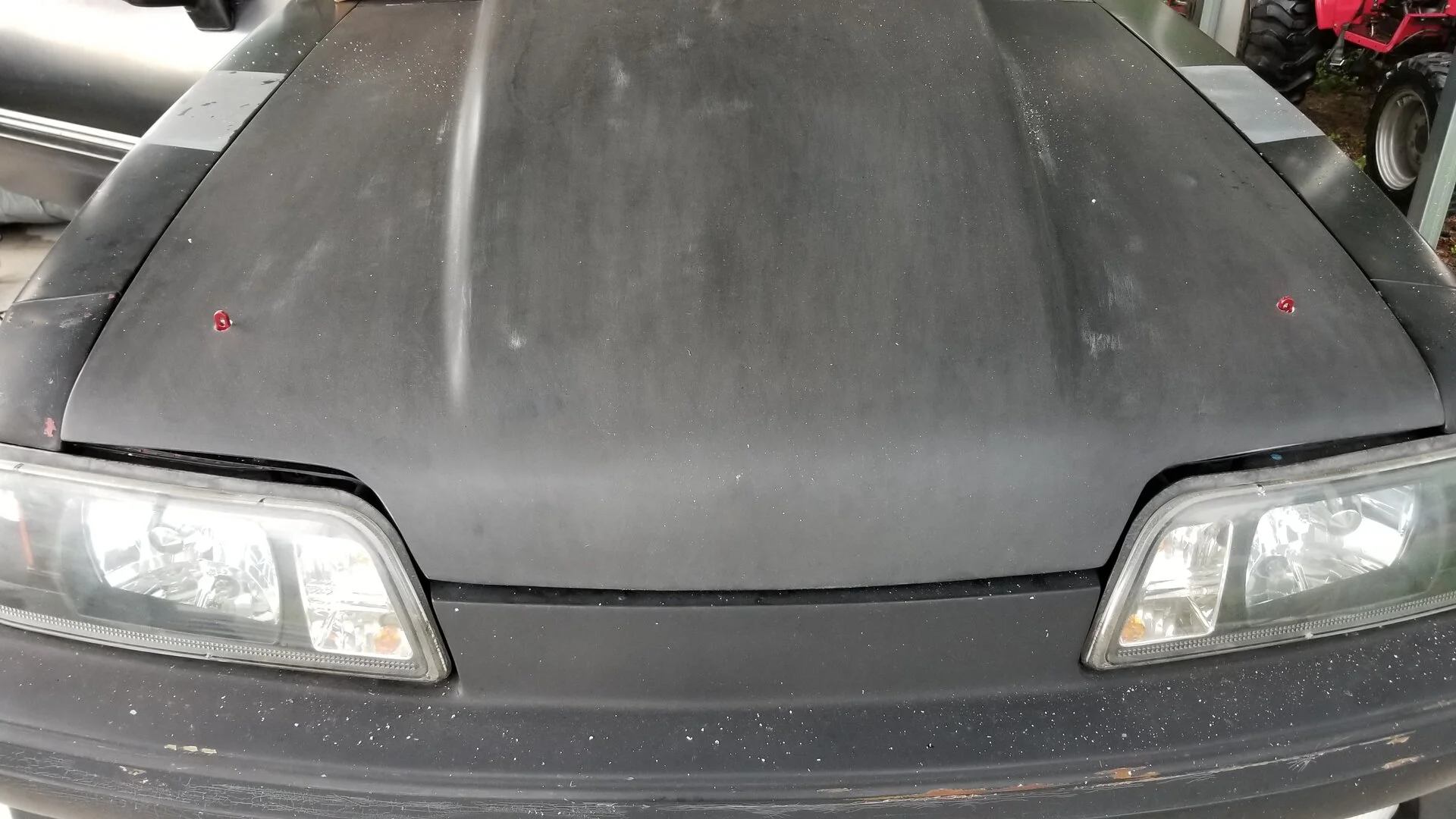

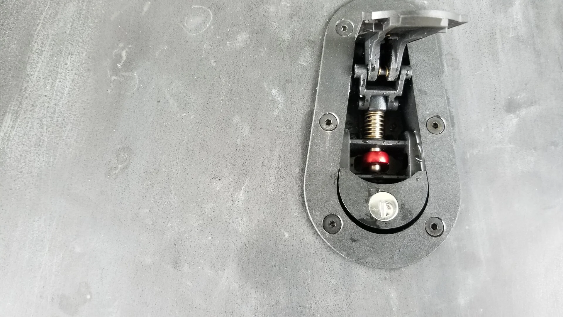

Get the pins installed and place a piece of tape on the underside of the hood, lower the hood onto the pins and apply silight pressure. This was all it took to get a useable mark for a pilot hole, once i verified that the pin was centered on the pilot I used a step bit to enlarge each side. I then lengthened the rods so I could latch the pins from the top side, I placed the backing ring onto the pin so it could be taped into place after measuring and adjusting both sides. Once the backing rings are taped on I simply removed the pins and used the rings as a template.
I then used that template to mark the hood with a sharpie and use a dremel cutoff wheel to cut the opening and test fit. I did some washing the dust was everywhere.
The pin is pretty deep so I was forced too cut the bottom side as well, I used a long carbide bit to reach through and cut the bottom. I then cleaned it all up with sandpaper rolls until it looked half decent. In this picture you can see the backing ring, I cut it to deal with the one problem area. This also allowed me to tape the nylocks into place and pop it into place inside the panel, the one screw got clearanced on the bottom and I used a supplied washer and nylock.
Final adjustment.
Job done, Now to clean up some wiring in the fenderwell areas and install the wheel liners.

And while it all goes easy-peasy for the rest of the Aero catch enthusiasts chiming in here, that pin location will/could change the minute you take a steel hood, cut those fasteners into the hood, then turn around and install lift struts. ( Gotta make sure the damn things are installed first.) Not gonna happen with a glass hood obviously, but it only has to be off a tiny bit to not fit nicely.

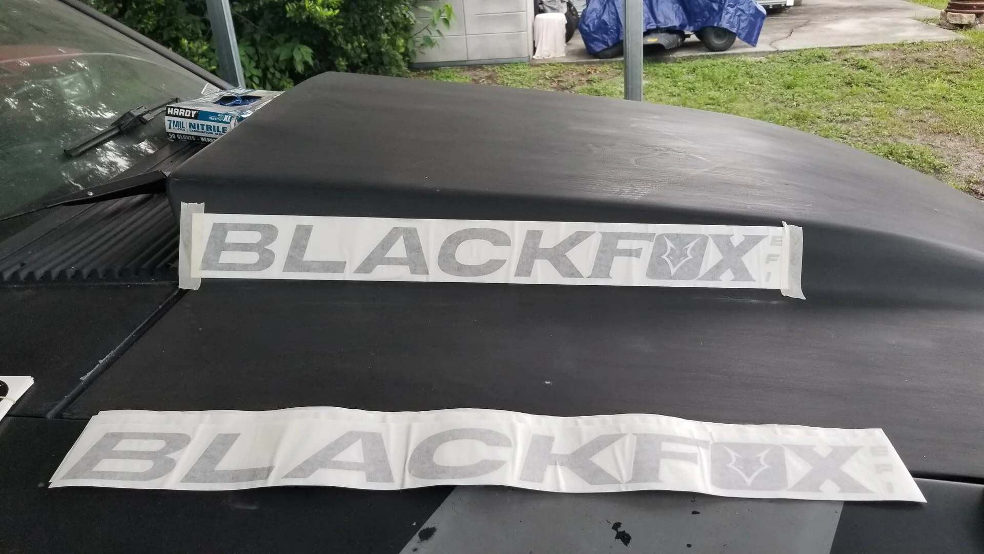

I ordered some stickers for the car.. looking for feedback. Personally I like them, in case your wondering yes it is a company name.

I like them.
