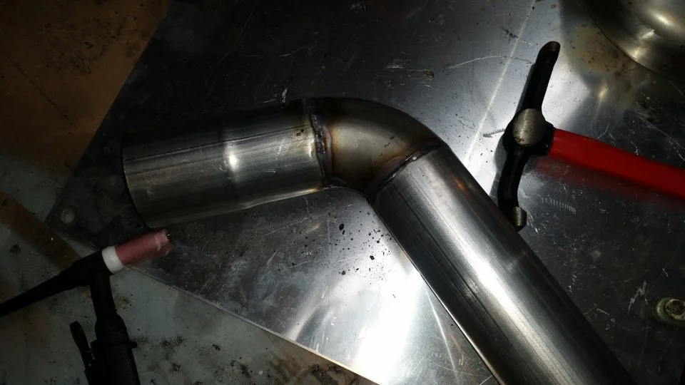

What a pita! If there is more than a 1/16 gap you have to be really careful of the weld dropping in, plenty of filler to keep the puddle cooled but moving.... I got this far today.

Pfft. Tig is easier than mig imo. But i spent three years doing it for a living. That was when George H. W. Bush was president though...

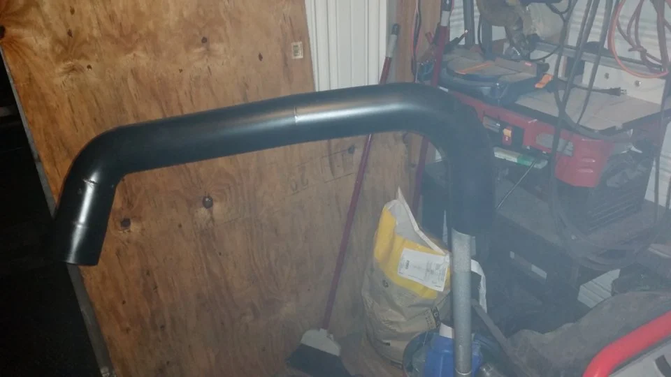

Got the turn in the passenger fender welded up.
this one took a lot less time and fitment was better.

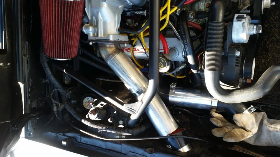

Ok so I got all of the piping done, it looks ok I guess. what it really need is a smaller intake. I will have some pics to post up tomorrow for now my wife is angry that I spent all day working on it and that it does not idle again....... lol figures
soo I have this surge issue, even with the iac unplugged to set base idle the car will idle steadyish for about 90seconds. then it will start to surge and eventually die. that tells me I must have a leak somewhere in the tubing or a previous issue has been brought to head. That I will have to figure out tomorrow.
I removed the pcv system and now I am seeing a lot of blow by..... ALOT! a constant spray of gasses coming out of the valve cover breather... :leghump: me man
30mins later.......
Engine only has 1200 miles on it since the last rebuild. I am not pulling it apart again.
I am going to put the tb back on the plenum and see what happens. I mean why would it idle like butter with it in the stock location and be such a bish ( what 10-15ft away)??? I think you see where I am going here, yup another bypass to bring the tb and plenum closer together.

Does anyone know what effect plenum volume has on an engine? I don't mean for power output I mean for wave reversion......
It seems from some reading that a larger plenum volume causes the air to "slow down" so to speak. So the pressure drop when a cylinder opens causes a back wave that aggregates the issue. Essentially I have created a massive plenum (11ft of 3" pipe + huge IC + cobra intake) I was wondering if some of you smarter than me guys can help here. Or if I can put in a short path bypass so the tb feeds the plenum almost directly when in idle conditions, otherwise I am gonna tear all this new :poo: out and put both tb back on...
