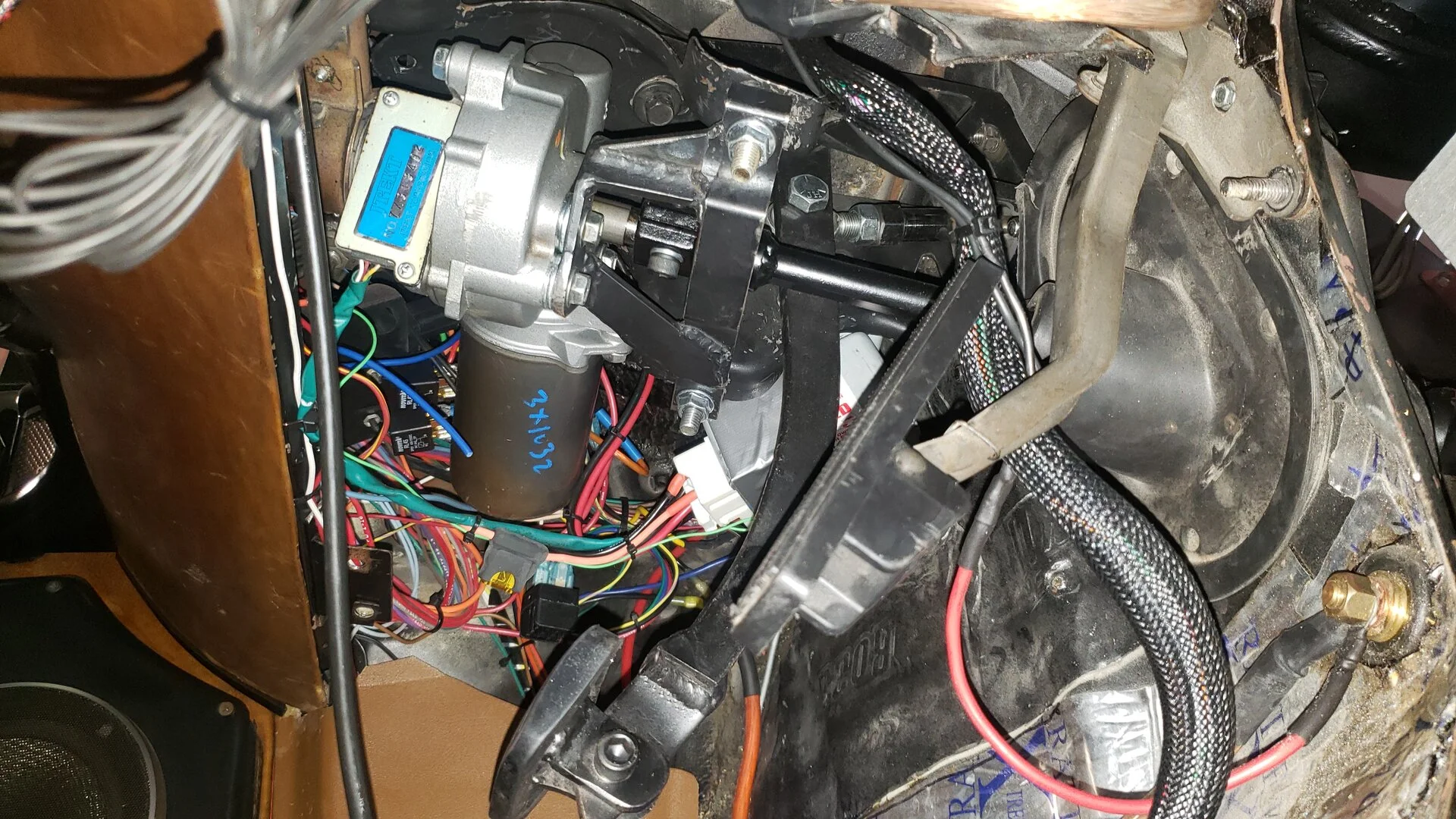

One other issue is that the breaks work fantastic.... so well that it wont turn the tires over with the breaks applied.. lol I am using a stock booster with the cobra MC, cobra rear disk and ATS front calipers... the pedal feel is very stiff like it has manual breaks @Mustang5L5 do I have the wrong recipe or ???

It might be the booster. That's a lot of piston surface area you are trying to push. The stock booster is probably not up to the task.

That's how they will feel with a stock fox booster. You need a 93 cobra booster or equivalent.

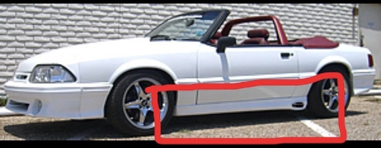

Be pretty neat to use the cut outs as air ducts to the turbos.
