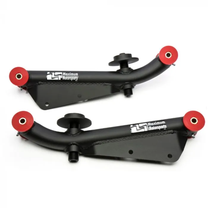

You’re an industrious kinda guy, why don’t you build yourself an adjustable spring pad that you can screw up to raise ride height like some of those aftermarket LCA’s that are out there?

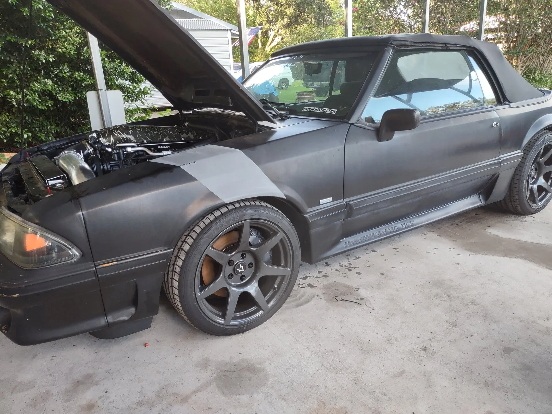

BTW the paint dont look to bad when its clean, this thing needs a bath
