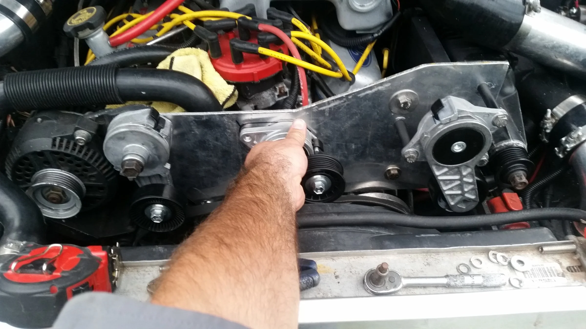

a91what
SendMeUrDataLog
Apr 6, 2011
10,733
6,716
214
Hillsborough county
May 20, 2016
#637
  • May 20, 2016
  • #637
OK back to reality....
I have to take the plate off and hole saw a 3" opening to offset the tensioner I found. I love that my wife works at advanced, I just walk in the back and open every box till I find something that looks like it might work.
That's a 6rib tensioner from a 03 focus 2.0
Reactions: krazedstang, A5literMan and Davedacarpainter

Ready to go. Only issue is it now takes 2 people to put a belt on the car! Lol I will have to drill a hole to put a screwdriver thru for at least 1 of the tensioners because God only graced me with 2 hands..... checked it out on the 2 step and she did great.as it is now the 4.6 tensioner does not move the way it is mounted.... oops too much angle tward the sc. It's OK though it acts as a manual tensioner.
