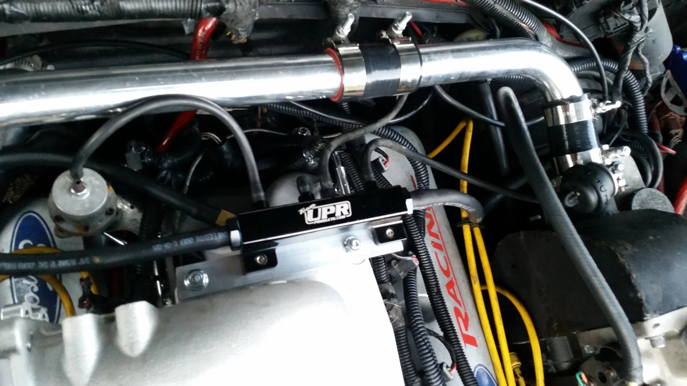

a91what said:
Oh and the IAT sensor will be going in the intake piping before the tb. I knew I ordered these bugs wrong 2 years ago for a reason.... lol.
any reason I can't feed all the vacuum loads with one block? (Including the brake booster)??
I have everything (including the FP regulator) sourced from a "Frank-N-Log" hanging directly off of the bottom my intake.
Boost ga, BOV, PWR brake booster, Vacuum modulator for the Trans, and FPR all tied into one piece of 1/2" pipe plumbed directly into Mike's BMW wannabe intake manifold.
Reactions: a91what

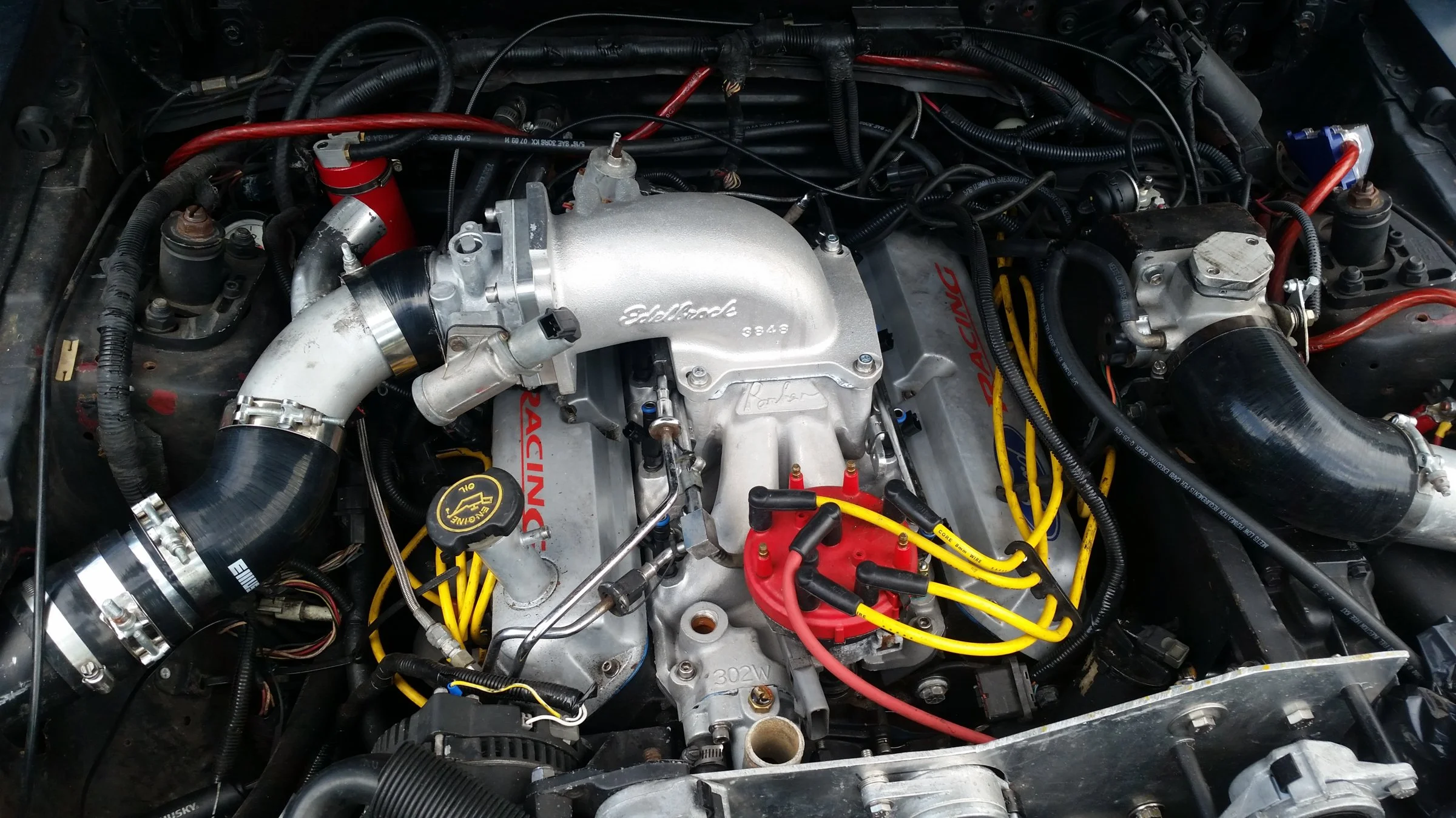

Okay so I got the new intake on and started Plumbing some things up. On the long list of things to do I need to change the fuel line crossovers right now they're too short finish routing in the bypass do the heater hoses set the distributor and before this is over I'd like to redo the feed-pipe to the throttle body it works but I'd like it to look better too awful lot of couplers and T clamps and one small space. I'm still waiting for my valve covers I have them already but they're at a friend's house he's polishing them for me

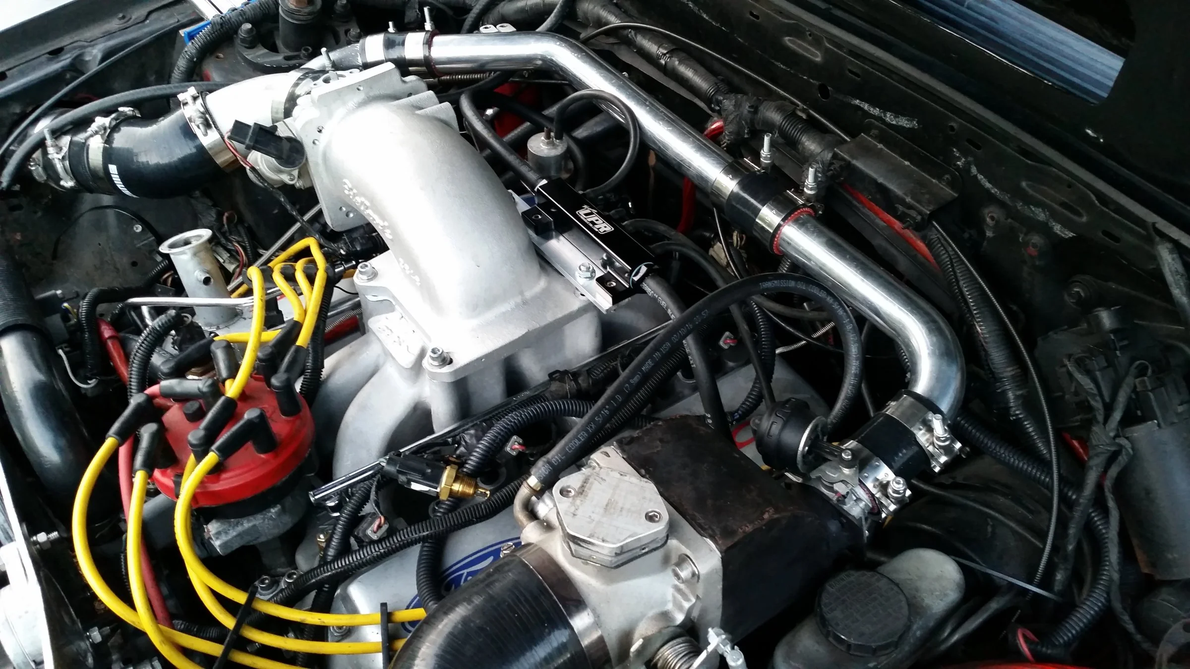

Got more done. Still have to redo the intake pipe, rebuild the blower, add the IAT sensor, new valve covers and an evacuation system and do general underhand cleanup wish I would have wire tucked this thing .... but it runs!
Even with those wires laying all over the engine, it's beautiful brother. Nice job!

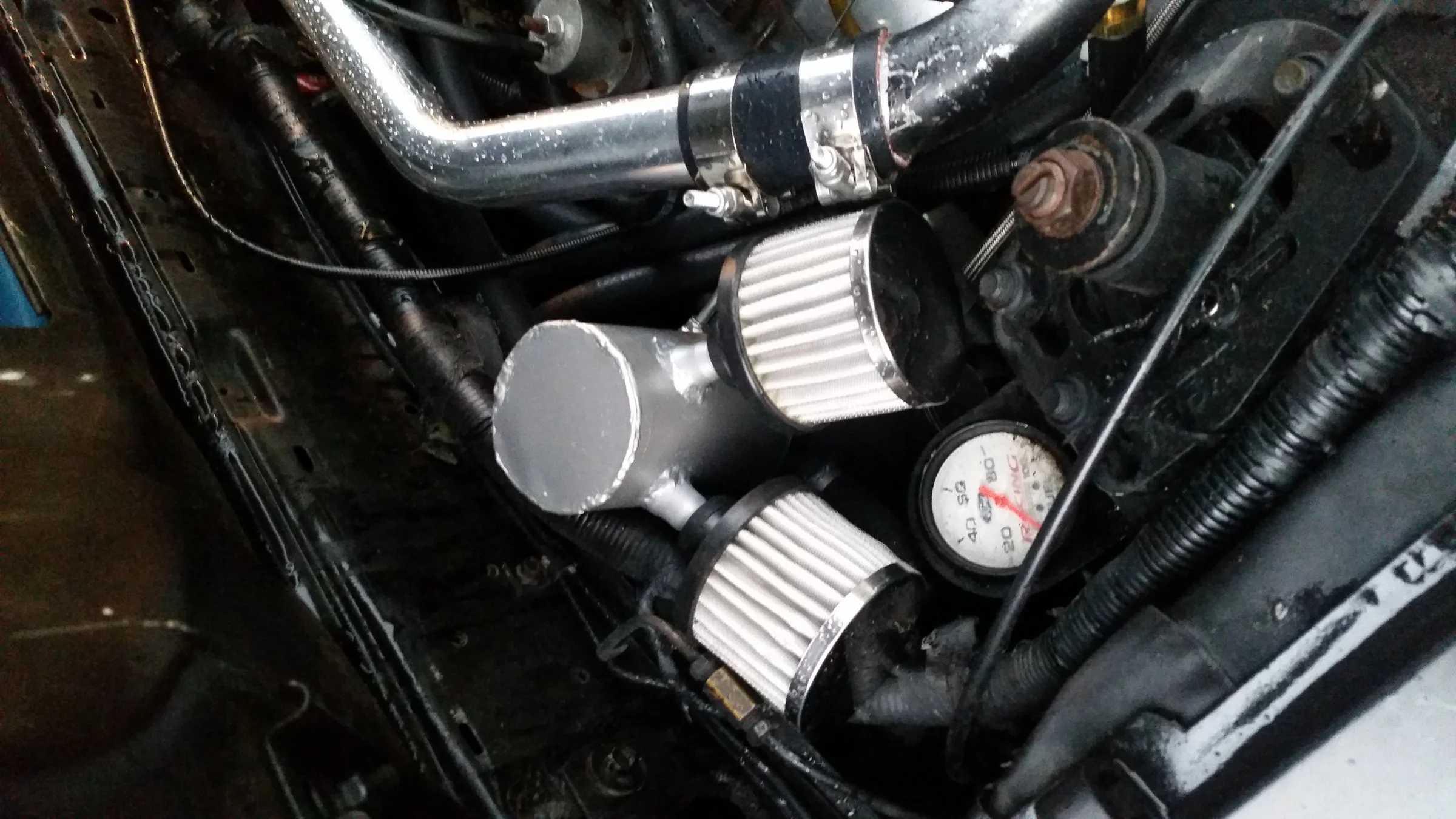

Got lots more done will give a larger update tomorrow with pics! It's mostly boring stuff.... cut-weld-fit,cut-weld-fit....... couldn't find that pesky hole saw that is hiding somewhere in my clutter for the MAT sensor bung.... put the new valve covers on, my placement of the supercharger requires it's removal to get at the plugs, wires and valve cover bolts..... go me.
I am going to attempt to make a vented catch can for the valve covers to breath into. I hear it now "why make one Steve? They are cheap" well.... uhhh.... cuz I wants to.

Make your catch can outta one of these.. Be pretty cool

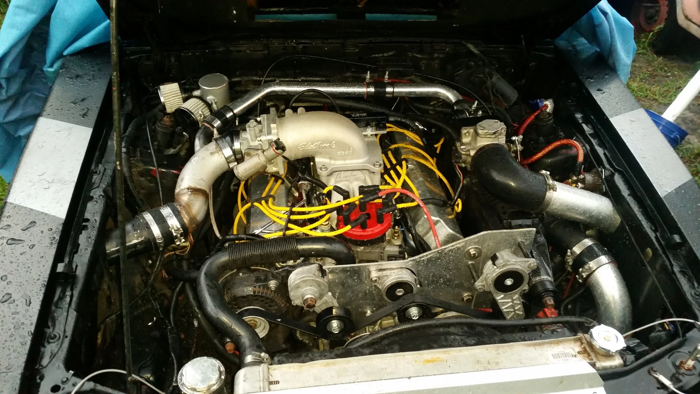

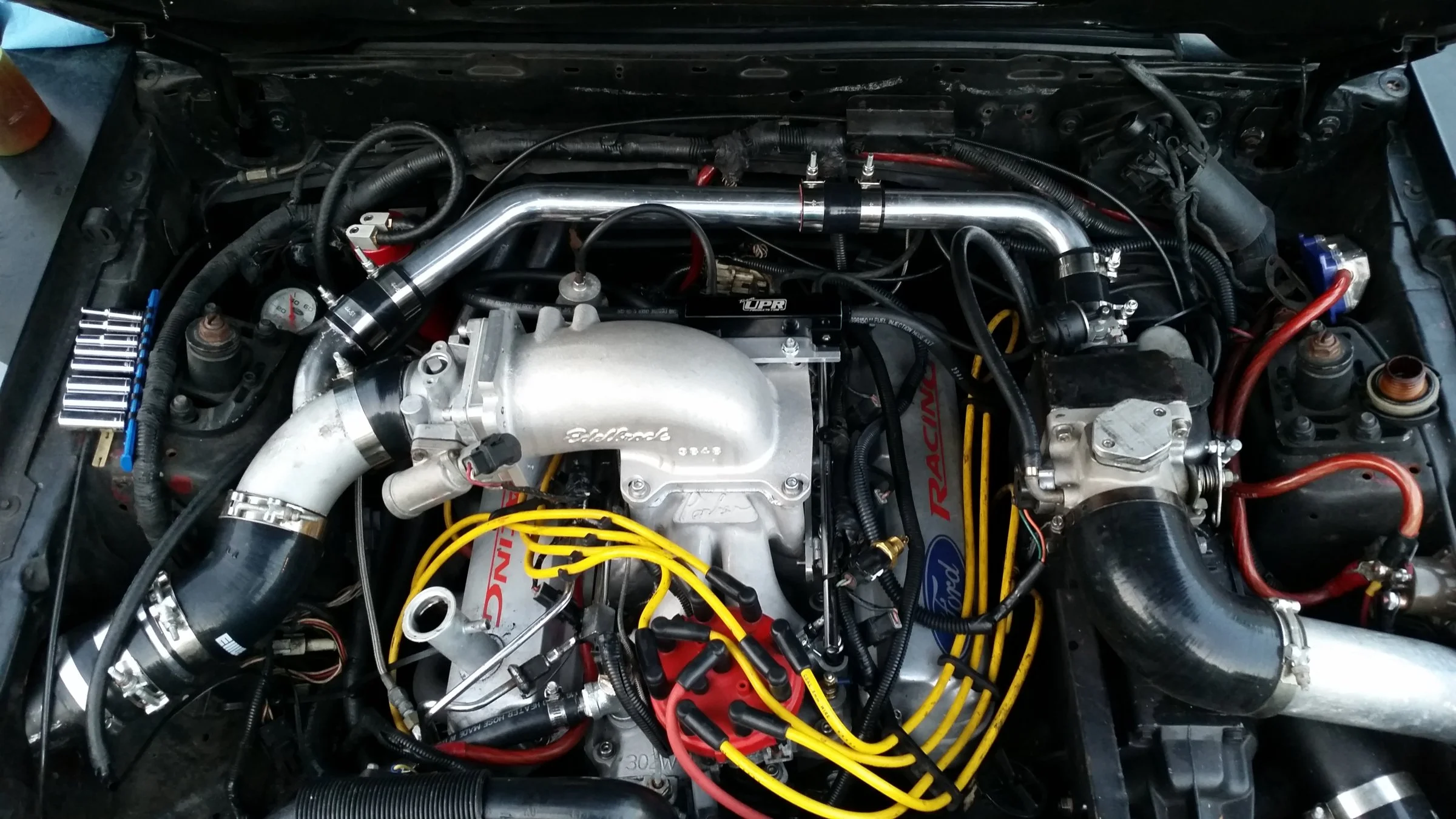

Okay so normally in one of these threads what you do is you post pictures of things and updates as you go and build well apparently I'm not very good at that what I end up doing is completing an entire project and then post pictures of the final outcome. So in saying that what I have for you here today are pictures of the final outcome of my catch can. The can consists of 12 inches of 3 inch exhaust tubing 4 half inch hose Barb's 1 pack of course steel wool various adapters for a drain petcock and some sheet metal for the ends. I have yet to test it because as soon as I got it installed the bottom fell out of the sky figures.
Frankenstang LIVES!!!! BWAHAAHAAHAAHAA!
