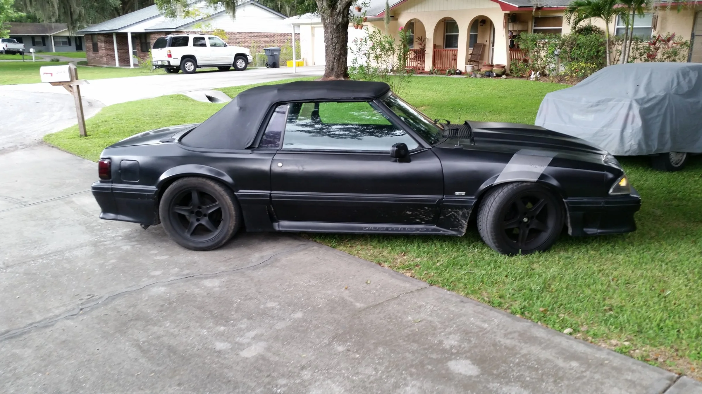

Control arms are done. PITA. Car sits much lower after we removed the spring isolators. The rear was sitting on the snubbed so that was removed as well.

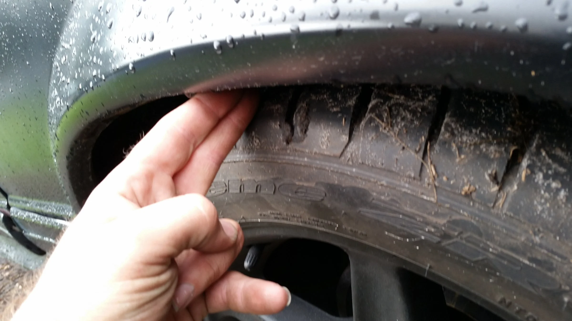

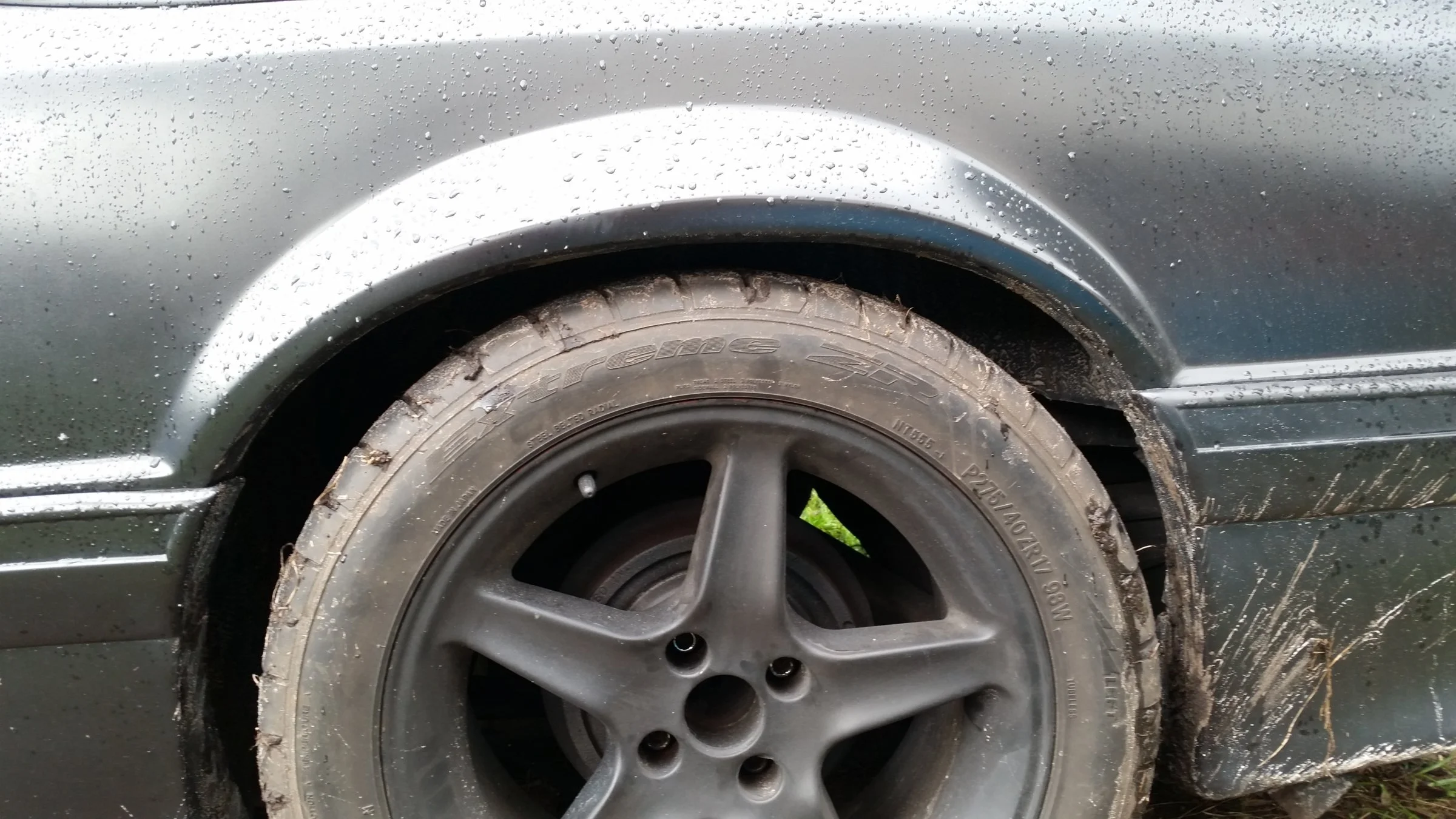

That sits crazy low. How's it drive? Whats you're wheel/tire combo? I'd cut my tires on my wells if I sat that low.
Drives amazing. Real smooth.
We did new shocks while we were in there, nothing wrong with the ones we pulled out but we already had it apart anyway.
Wheel is a cobra replica 4lug 17"
Nitto 555 275/40 zr17
this is a bit deceiving as the car is not on level ground the other side has about 3 fingers. With 2 people in the car and a spirited drive I didn't get any tire rub. We took our sweet time and got the rear end centered and square.
Reactions: A5literMan
Oh and on my drive home it was raining, not sure if it's all in my head or not but the car "feels" much more stable a lot less walk around in the back. The stock arms had a very nice set of energy suspension polyurethane bushings in it when it's dry and I can put my foot past 25% I'll let you know if there is any significant change.
