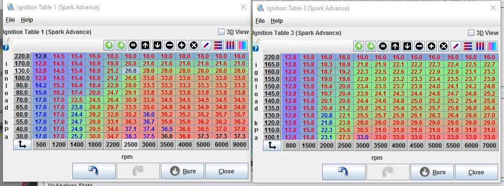

question for the boosted guys and racers... @hoopty5.0 @GroverDill @Boosted92LX
@madmike1157 @A5literMan @Decipha [I know you tune]
trying to redo my timing curves.... I'm not melting anything down or running hot, but everything I read says ive got too much timing in the motor under boost.... it loves the timing up until about 4krpm then [could just be the roots blower and cam] by 5k she is done. stops really pulling hard.
here are my tables. car is speed density
they are in kpa 100 is wot na. 130=4-5lbs 170=10lbs 220=17lbs
car has never seen more than 9psi, 2kto3.5k I average 9psi 3.5to4.5k=7.5 from 5k up 6psi
table on the right is my old boost advance table.... is it too aggressive?
on the left is my new table based on internet crap...

now I know there is a point where more timing will make less power.. I wonder if my cylinder pressures are too high and taking timing out up top [or along the entire curve] will produce a better MBT...

I'm useless on reading/understanding/tuning those tables. I have very little history on boosted motors. I will say that I know the cam is good to beyond 5k. The e cam has a normal sweet spot of around 5500 for a peak and capable of a little more before maxing.
I guess the easiest way to find out is just take a little timing out and see how the car responds. Especially if at the track, you would be able to have an accurate real world data point. It sure wouldn't hurt anything to take some out and see
My question would be... Is the valve springs up to the task? With the extra pressure from the blower I know this can be an issue. Btw did you get the package?
