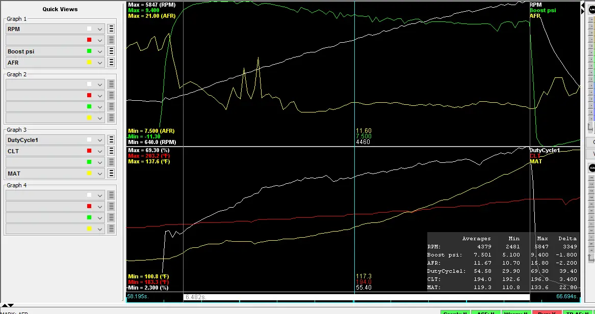

this is two separate charts but from the same pull/time. Top chart has RPM,BOOST,AFR
bottom chart has DUTY CYCLE, CLT, MAT (iat)
From this you can see the car was up too operating temp (red line bottom chart)
The MAT (iat) started at 100* by the top of 4th 130*
From testing the SC will make 12psi non-intercooled! But iat is up at 220*

Might be a good idea to consider having the M90 ported to get that efficiency rating up a little? The M90's are great little torque makers, but they do get hot. My last Allen kit used an "S Ported" Gen III M90 that I was over spinning to the tune of 9-10psi on a basically stock 4.6 PI engine and even through a 4R70W and IRS rear end it managed to put out 343RWHP/389RWT on a Mustang Dyno.
Now....granted, it was sporting an air to water intercooler, but the system wasn't very efficient. I was still seeing 210-220 degree ACT's by the end of the track.
What are your ACT's?
If you check back earlier in the thread I did Port the blower myself it's not nearly as nice as one of those s ported blowers but I did notice a difference in the amount of pressure it generated...
I believe I'm running a 1.9 inch pulley now I have some other size pulleys but I didn't see more than 5 PSI with a larger one however it would be interesting to take it with me and swap it out on the dyno and see what happens

How many lbs of boost were you making with that 1.9" pulley? I guarantee you're slipping that belt.
I had a 2.35" 8-rib on mine and without a little VHT on the belt, or pulley itself, it would slip like crazy
If you're seeing 130-degree's at the top of your pull, that ain't .
I think the problem you're having at this point, is that you either aren't spinning the blower fast enough, or you're slipping your current set up.
I would seriously consider running the blower on a separate accessory drive (if you aren't already) and run a larger crank pulley, instead of that tiny blower pulley. Vortech makes a nice 8" crank set up that'll get that blower moving and allow you to step up to a blower pulley with a little more surface area to it.

I would be forced to remake every bracket on the setup to do that, including a different radiator/fan setup... here is a pic of the front dress.there is plenty of wrap/tension on the belt for sure. And I'm running a larger crank pulley from a bronco, I believe it's just shy of 7"
I do get quite a bit of belt burn showing up under the hood. (Slippage would explain the weirdness on the data log)
