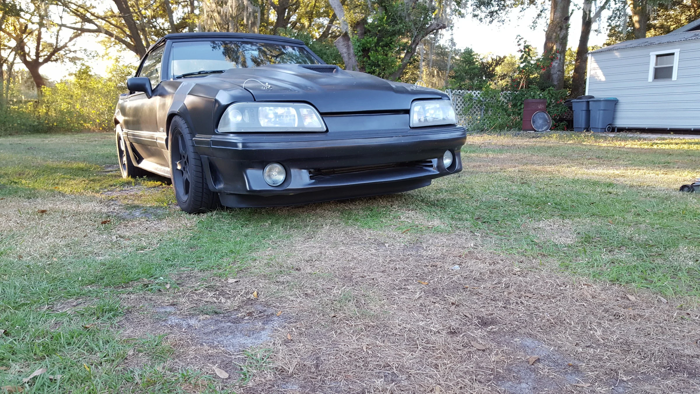

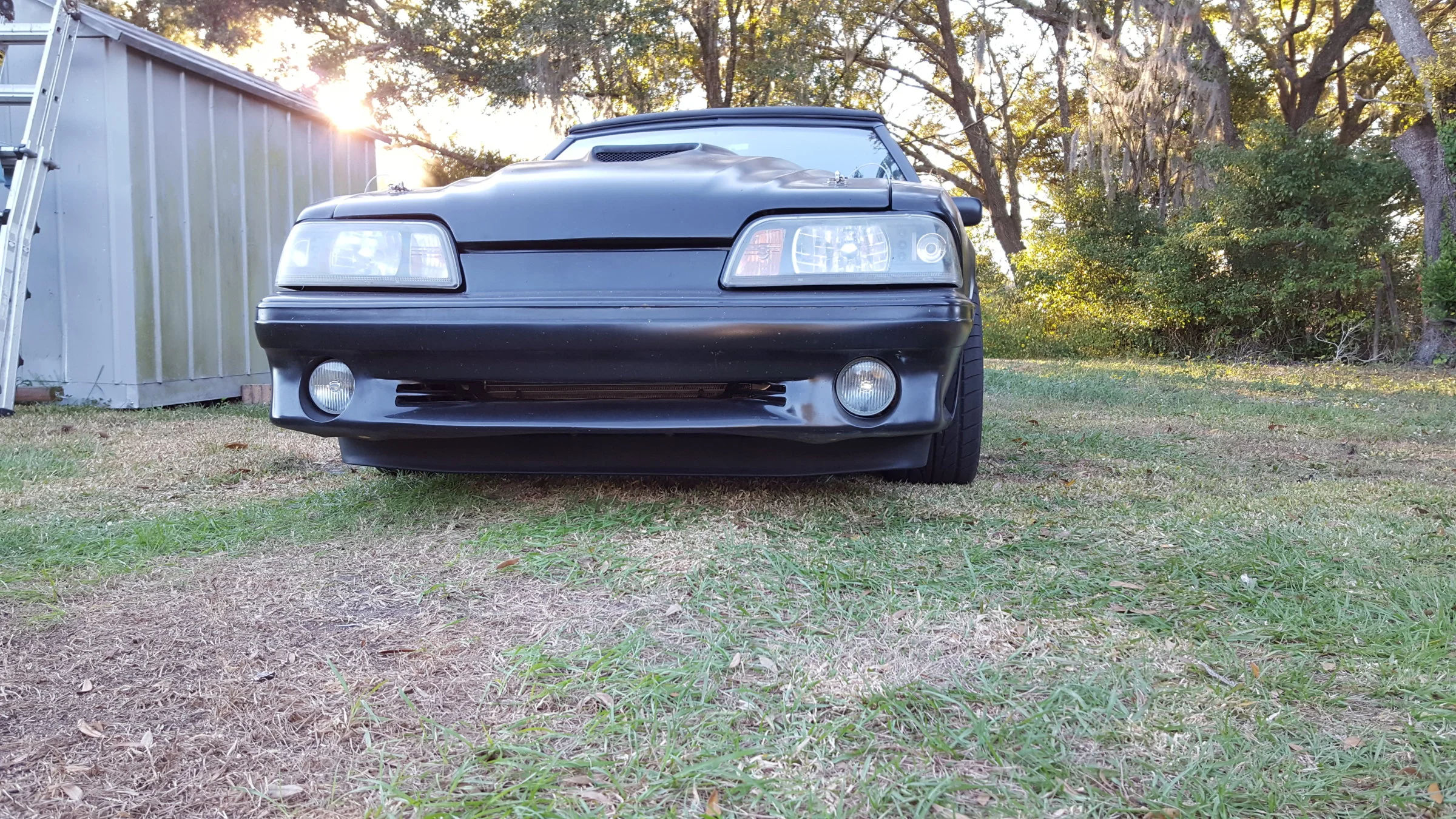

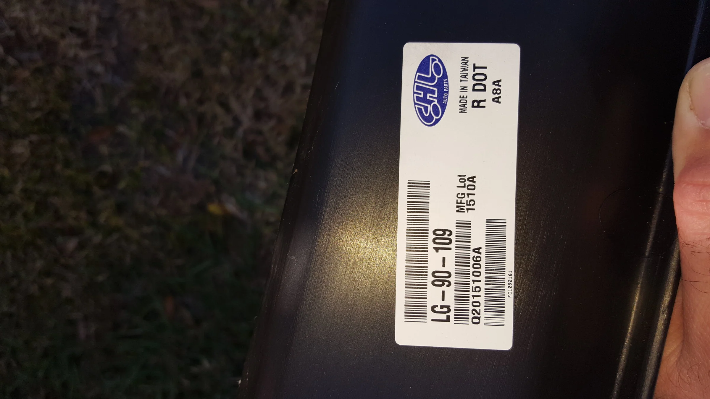

Amazing weather today! the high was 67* I spent every moment of it outside enjoying it.
So I spent 30mins doing a mod I have had waiting for a perfect day like today. The new air deflector!
So I started with this.this is from a Ranger I believe, cost is less than a stock deflector! 38$ at the front door...
So it takes some slight modification to make it fit, shaving excess material and re-drilling the mounting holes. I went the extra mile and added brackets to the fender aprons to hold it in place.
you can see a small rivet in this picture, a quick shot of trim paint will fix that.
I think it looks great only time will tell if it survives speed bumps.

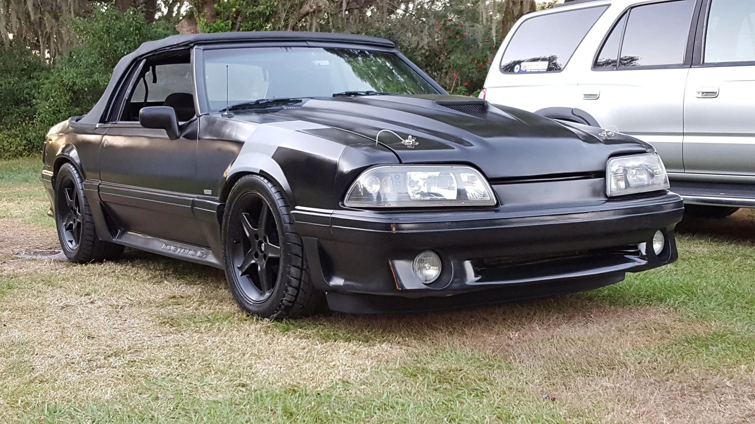

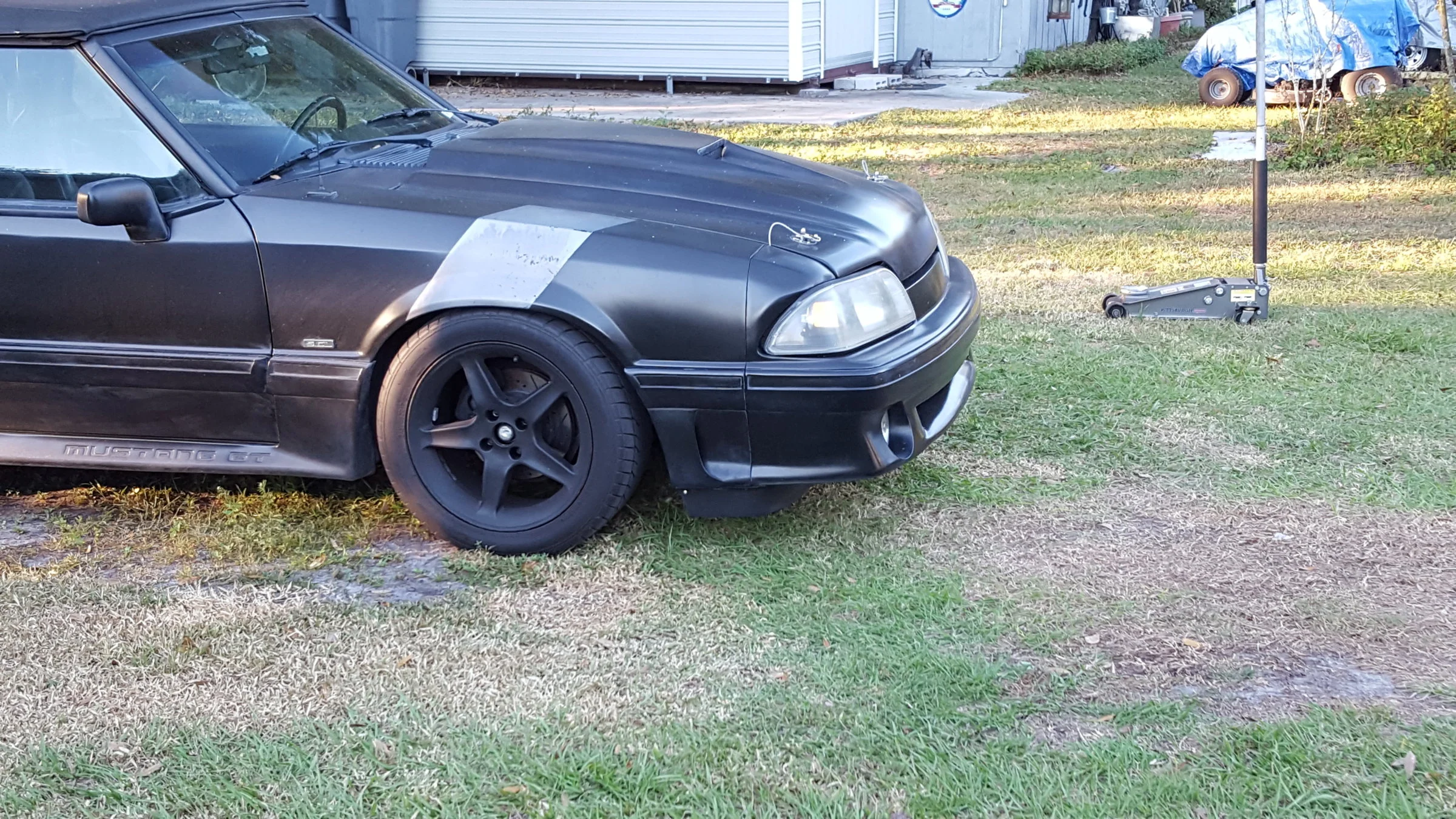

I cleaned and waxed the ish out of my 100$ paint job. redid the plastidip rocker stripes too turned out pretty good.
I love that I'm really close to the point where all I need to do is clean it and drive it.
Reactions: Boosted92LX, hoopty5.0 and Davedacarpainter

I think the grass is touching your air dam
That car is good lookin' ! Looks good and I like the air dam mod.
