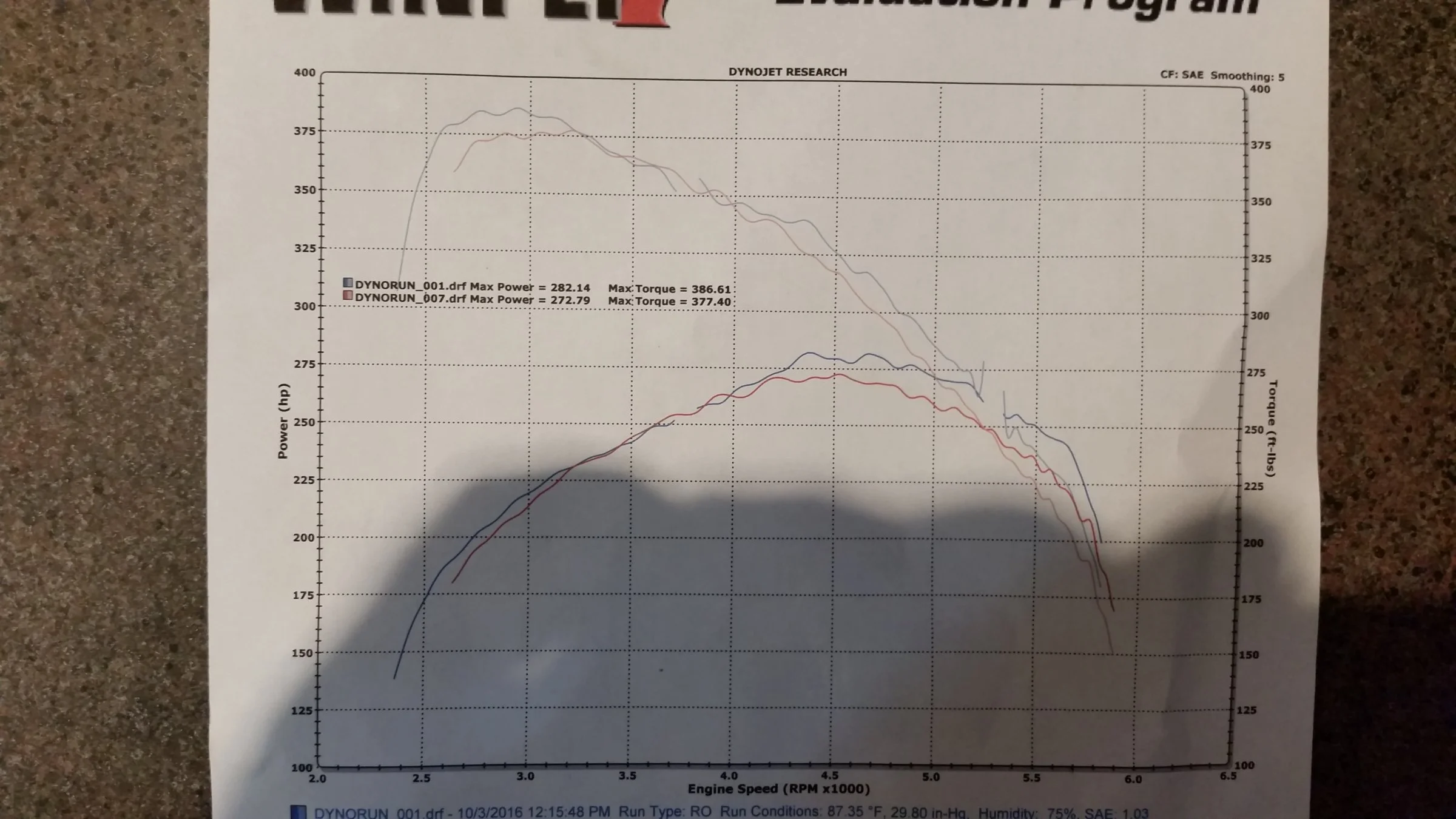

Currently has a t5 with 3.73 gears. Engine is done making power at 5k. My power band is from 2.5-5k for most area under the curve.
With the 3.73 I need to shift into 4th well before the finish in the 1/8. I'm hoping the 3.08 will let me stay in 3rd.
First and second are crazy short with the torque I'm making, I also want to lower the highway rpm so in town Im not spinning 2.5k in 4th at 45mph, and 2.5k in 5th at 70mph.

Too big of a step IMO....3.25's or there abouts?

I used a few rpm calculators before I made the decision. 3.73 to 3.08 is about 400rpm with a 28" tire.
Then,.......Why do it?
I went to the same calculator,..and I concur. About 400 RPM. It's the difference between 1811 RPM, and 2193 at 70 MPH.
Is 1811 RPM at 70MPH even in your torque range?
