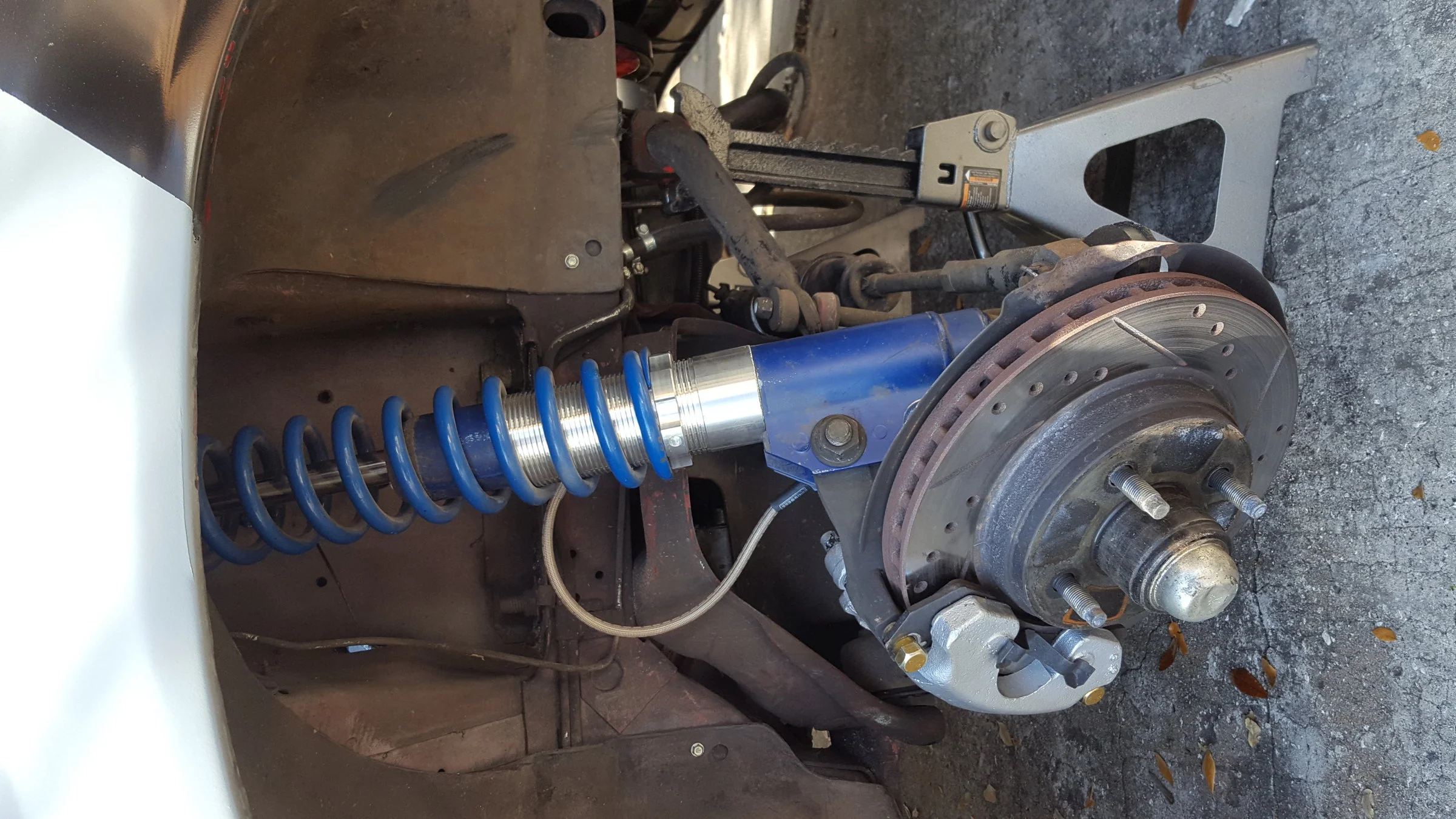

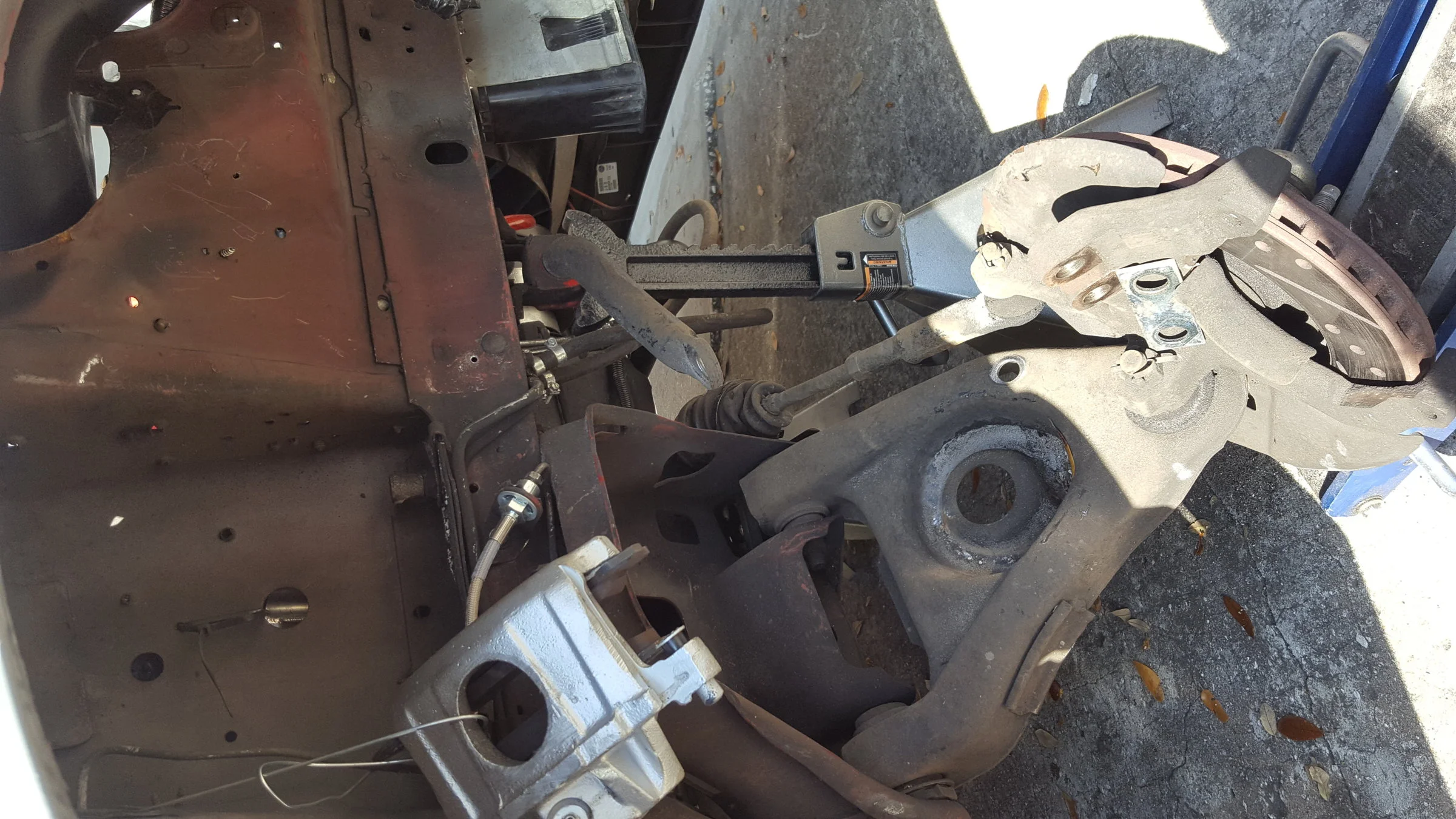

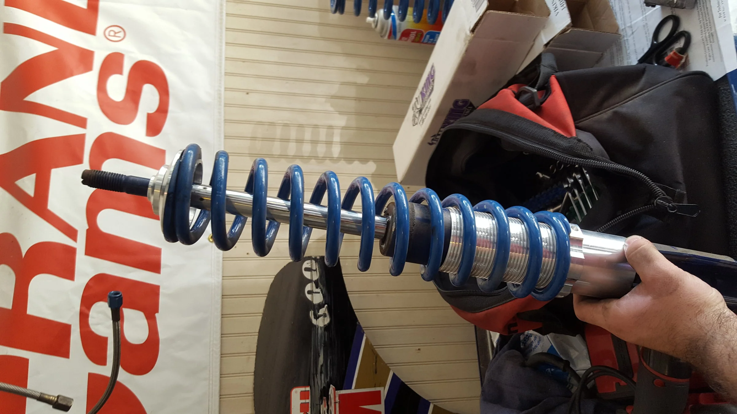

It's Monday again so as I promised here are some pictures of the coil over installation.
gutting the old chit.
here is my sideways picture of the assembled coil over assembly... we had to cut the dust cap off the strut. Then installation was pretty straight forward.
my world is on its side today....
Ready for final assembly, still needed to tighten everything up.
Why haven't I put these on before now? I'm stupid. That's why.
Car drives better rides better brakes better.... well it's just better.
I did lift the nose of the car up about 1/2 inch or so, now it doesn't bottom out when I hit the brakes hard.
