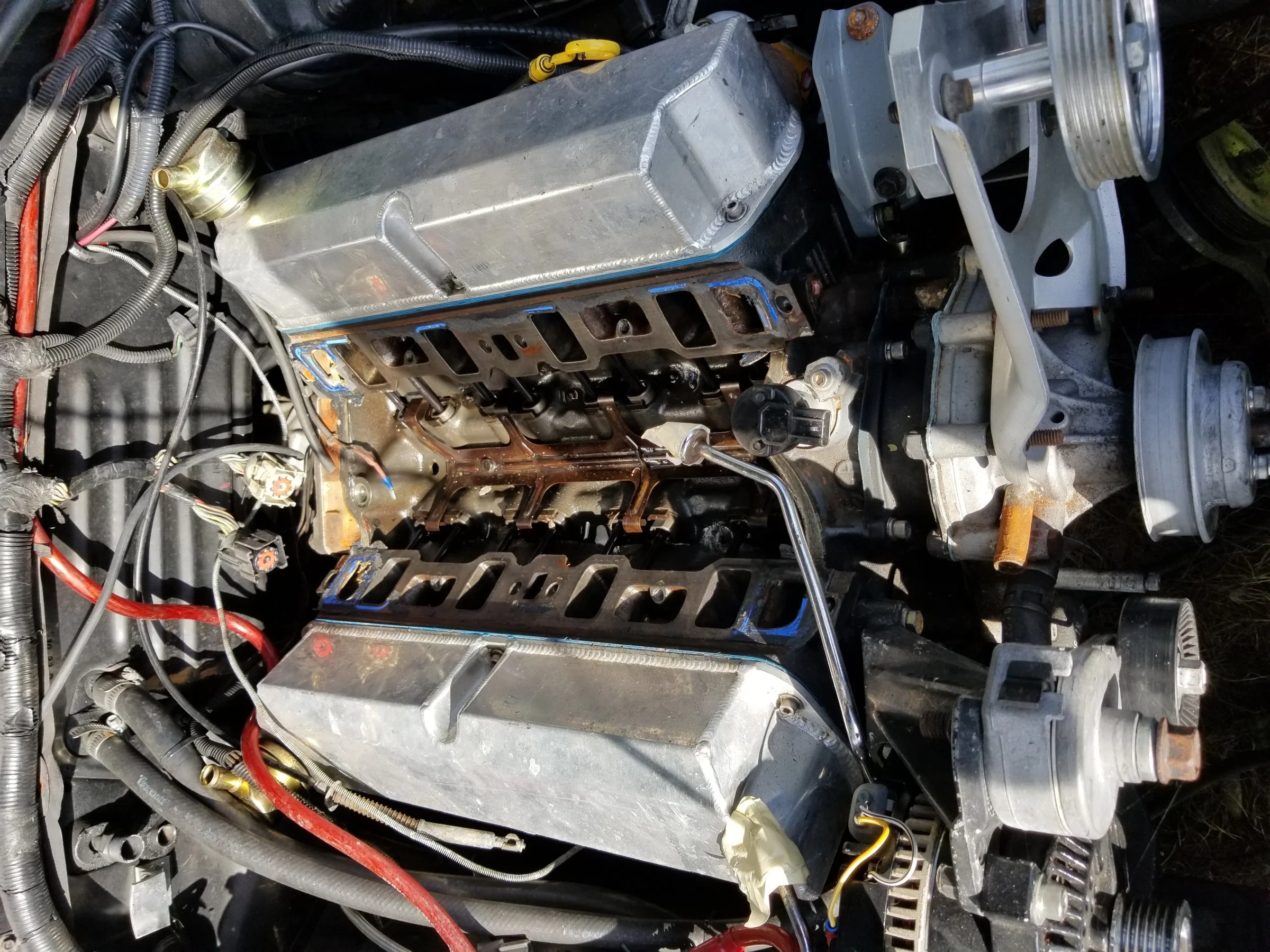

Jesus it's hot today. Not a single cloud in the sky, makes for a miserable morning in Florida when you want to work outside. it I'm putting the damb thing in the car and will deal with the rest later. I still have other things to work out like making sure the pulley alignment is correct and a snout support. Wiring, coil packs, ect. Ect.
This is where I got before I decided it was time for frosted flakes. now where did I put that gasket scraper?

a91what said:
Jesus it's hot today. Not a single cloud in the sky, makes for a miserable morning in Florida when you want to work outside. **** it I'm putting the damb thing in the car and will deal with the rest later. I still have other things to work out like making sure the pulley alignment is correct and a snout support. Wiring, coil packs, ect. Ect.
So, I see what looks like an exhaust routed ventilation system based on the VC breathers.. Are you using a Moroso Vac u pan system?

Thats a kirby rainbow vac system, just gotta change the bags once in a while
No they fed my oil catch can from the last system. I'm not sure what I will do with them now.

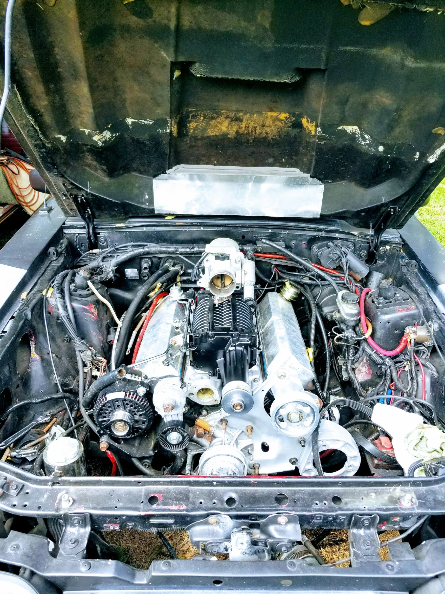

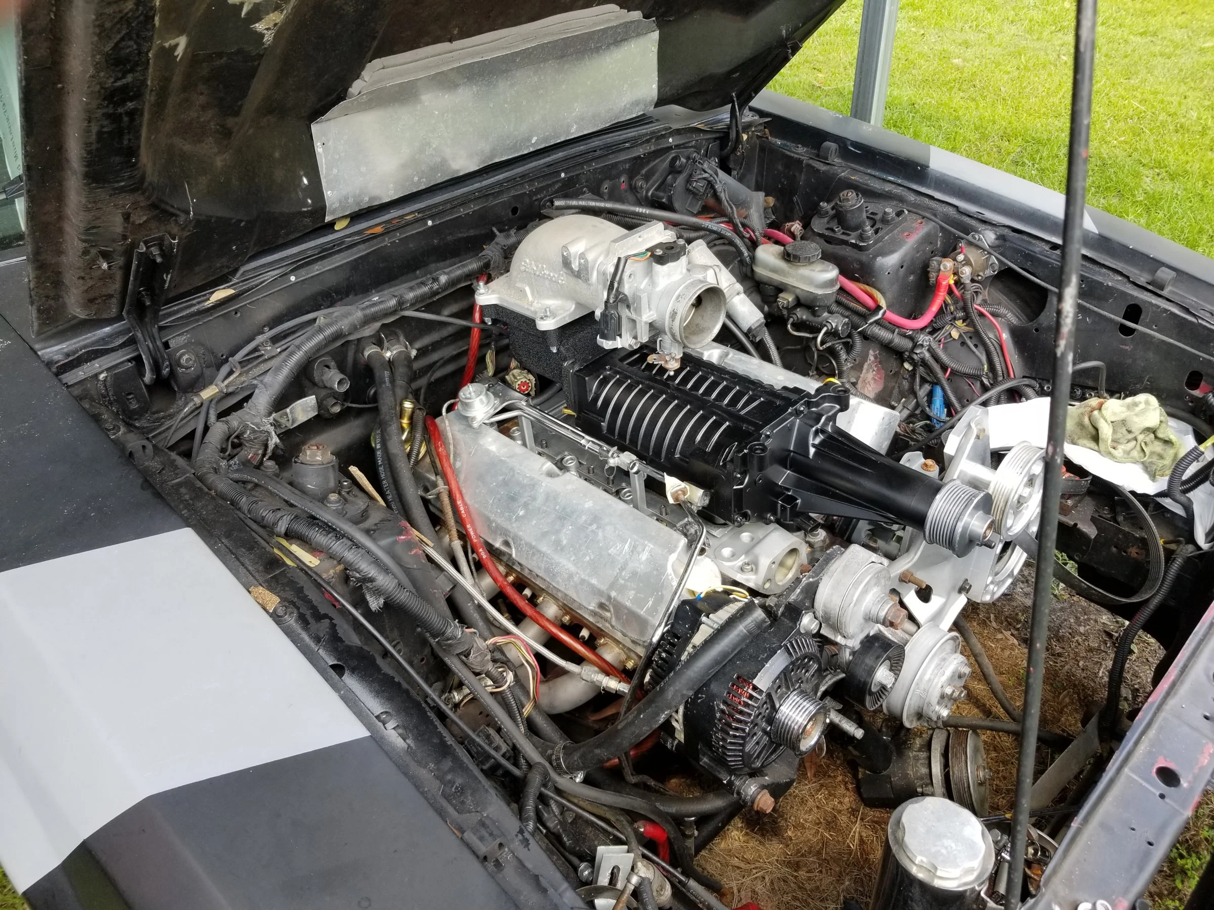

Here is a sneak peak. It's not permanent yet just wanted to see it.

Oh and the hood closes.
With all of.......... 1/16 clearance.
If I shave the plenum down where the top bolt boss is for an LS style throttle body (which then negates the ability to use a MUCH cheaper TB) I will have plenty of clearance.

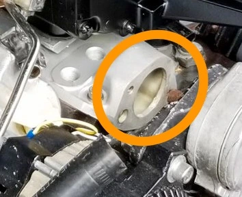

Will the thermostat housing fit in there?
Now there's a good question Chris, Steve?
Chris.....
He's the forum Eagle eye that single handily has caused more "Awwww shhhtt"
reactions than any other member here.

It will once the nitrous plate is added.

Great question! Here is another picture to judge from. from here it looks like it will fit just fine, tomorrow after I run some errands I will install/try to install the thermostat housing. Now the real issue is how I am going to fit the ect and hose fittings for the heater hose.. and I need a spot for the temp gauge. I'm sure it will all work out.
The belt alignment looks like it's friggin spot on, finally I measured something right.

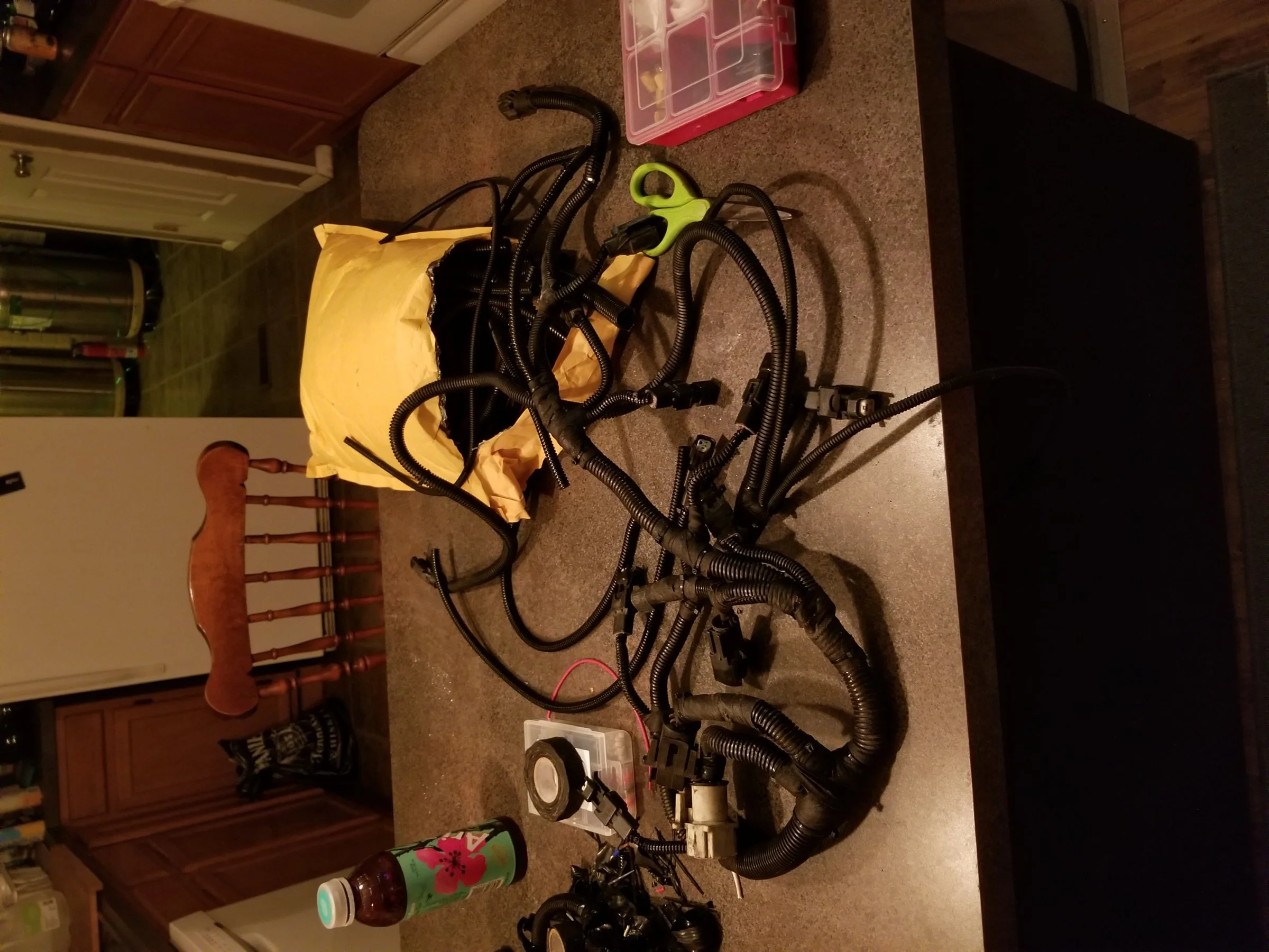

After the sun set yesterday I felt as though I needed to get something else done. So I drug the engine harness inside cleaned it up a bit and proceeded to replace loom and extend some of the wires. Here is how it came out. man new phone likes to take sideways puctures oh well.
