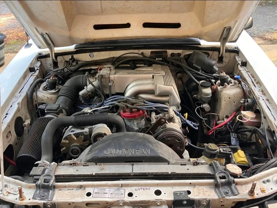

The air filter needs a shield to block fan wash from the radiator fan or do a CAI and move it to the inner fender.
Make sure the battery is a sealed unit as you do not want a battery that is vented in the car with you.
Biggest thing would be to take pictures of everything and post them. Brakes, dampers, more engine bay pics, etc.
