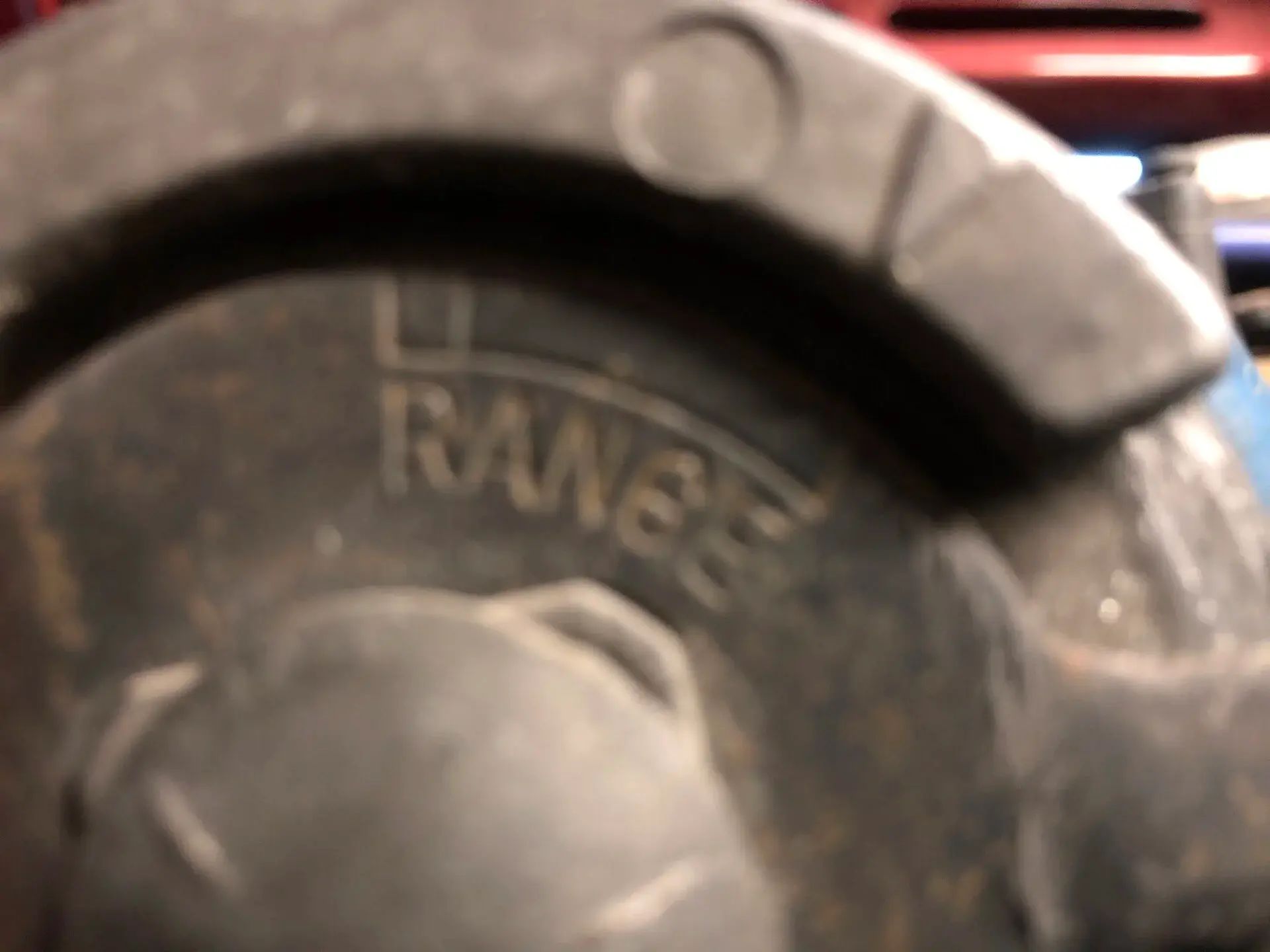

What puts the strain on the accessories is the tensioner. Where it is in the range on the front of it? Something like this:
Oh I had no idea that was on the front. I will look tomorrow. Plan on installing a new fuel pump tomorrow as well as an oil change

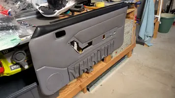

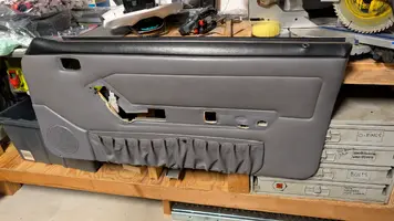

Did some things over the the last few days.

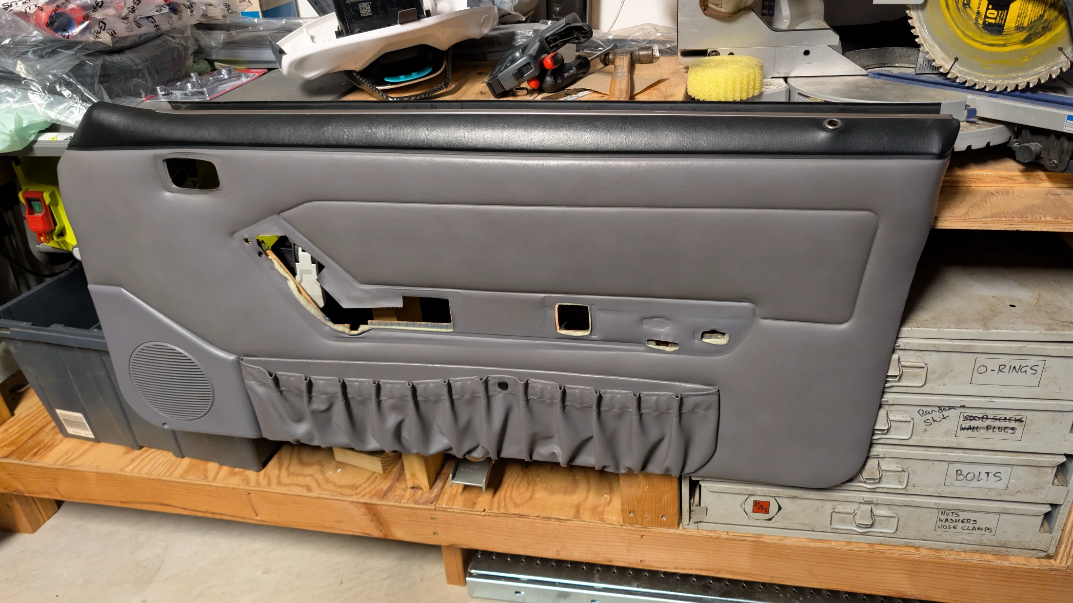

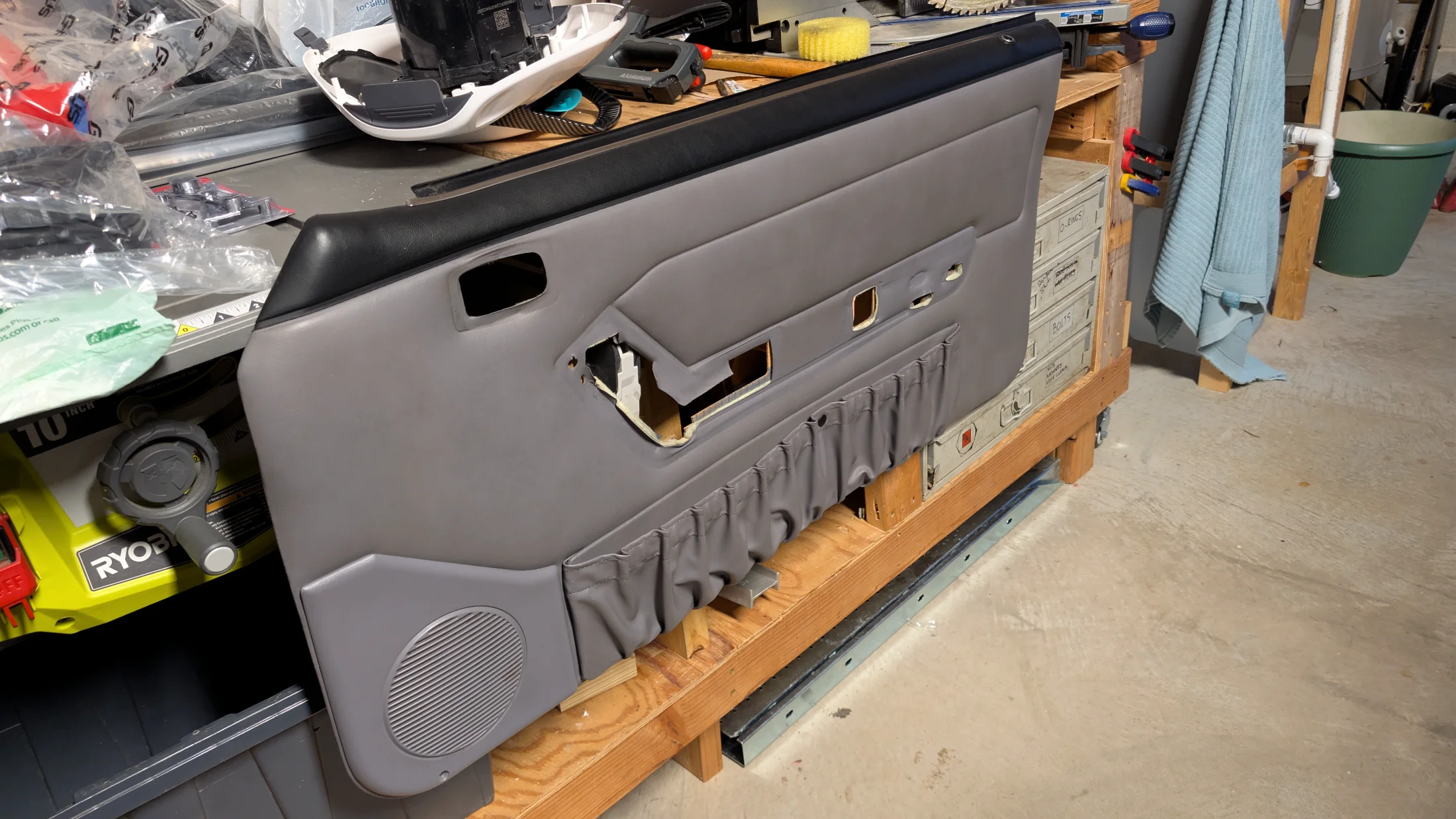

Took apart both doors and managed to get the passenger door open. Cleaned up both door cards and tightened the map pockets, these are in pretty good shape. Cleaned all door panel pieces also.
Replaced door lock actuators, outer door handle on the driver's side and got the :poo: LMR ones that stick out way too far. Smh will be getting new ones (Any recommendations?). Replaced all the little plastic pieces on the door locks.
Replaced driver's side window run channel (How fun that was) FML the outer window belt moulding. (Still gotta do this on the passenger side though)

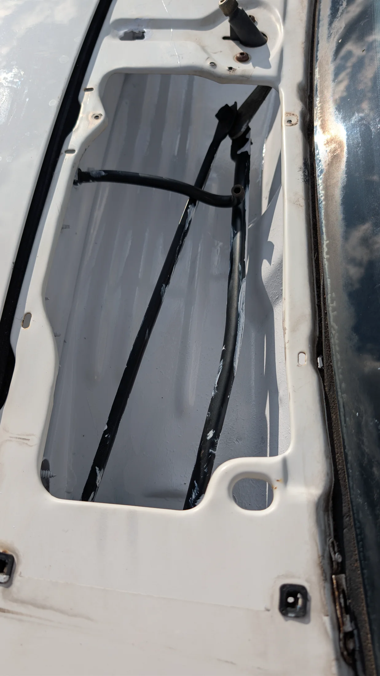

Took the cowl vent off to do some rust control in the box. Wire brushed, sanded, cleaned and painted with some rust prevention. Pretty good job I think. We'll see how it holds up over time. Gotta order a new grill as it was cut for gauge mounts.
Some progress not as much as I'd like though but it's something.

What's up y'all.
Have a great weekend y'all.

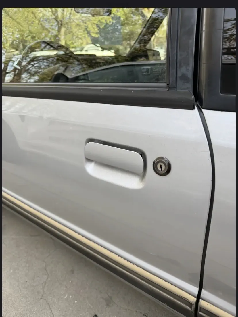

Lmr has low profile door handles. There is some pictures around here somewhere, I believe in one of the "rising from the ashes" threads.
Here is a picture of the LMR low profile handles courtesy of @skian00

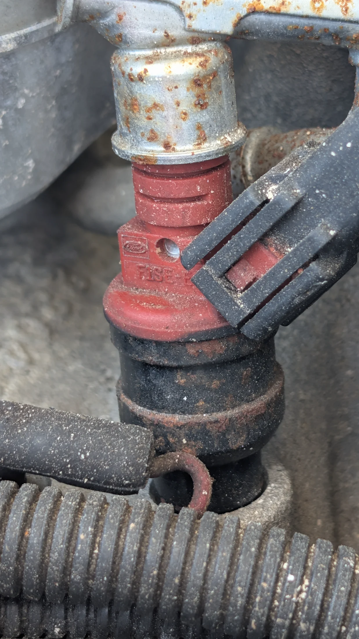

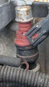

I like those. Are they the SVE ones. Kinda pricey if so. On another note. The fuel pump that I was given with the car is actually a 190lpr pump. My plan was to replace it today as I thought it was the 155lph. Would a 190 be fine with the mods that are done to the car already or should I just buy a 155.
Edit: Just took a picture of the fuel injectors. 30# if I'm not mistaken :oops:

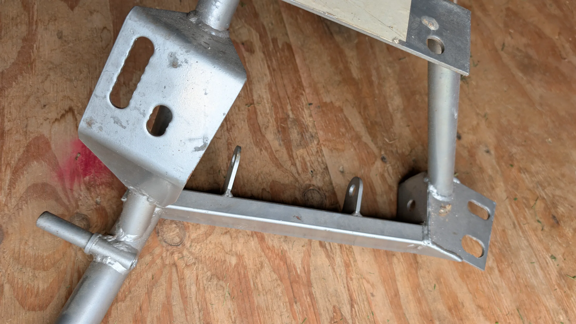

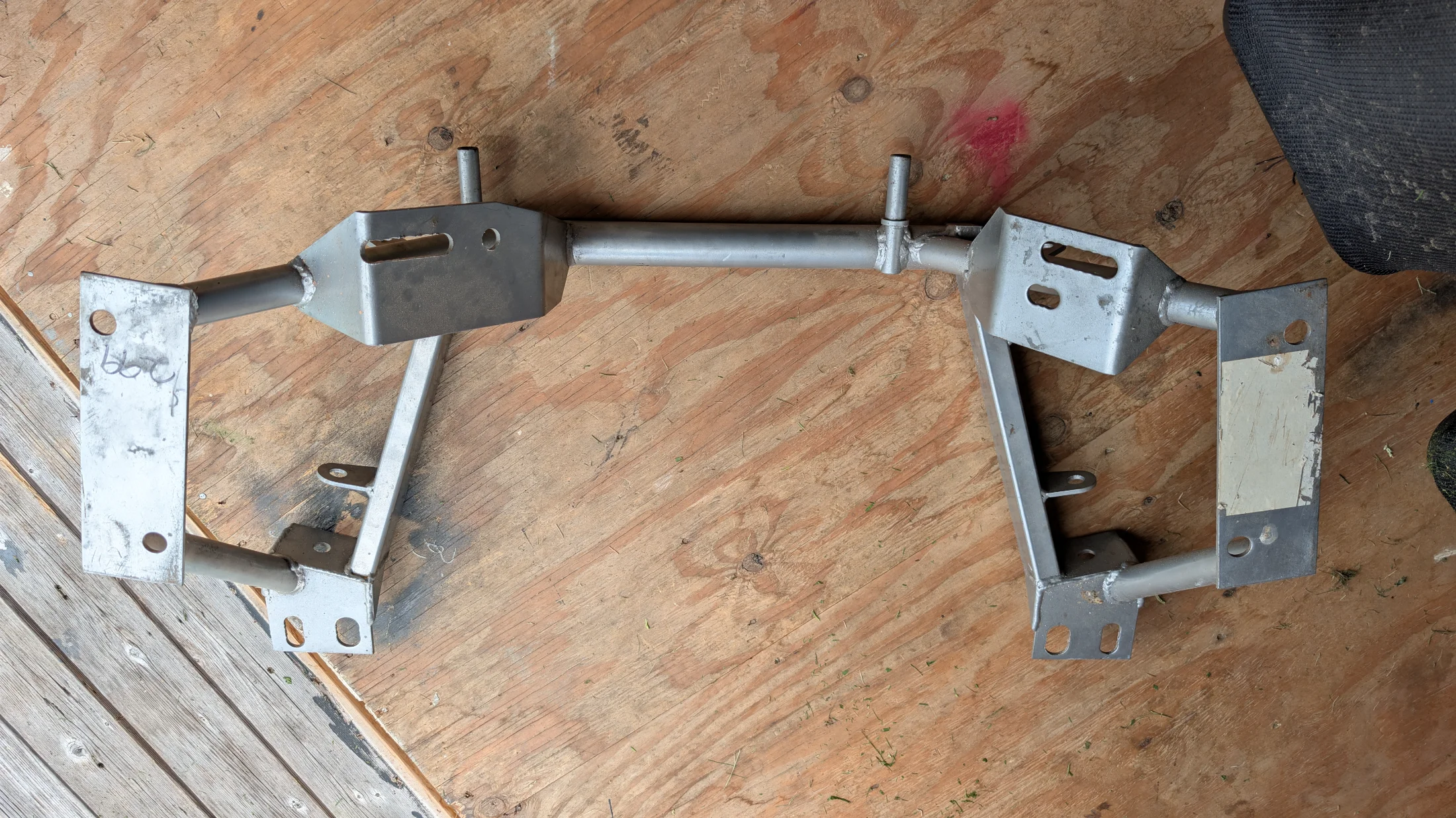

Not much progress on the fox as it's hotter than the devils butt crack out. But I do have a question. I was given a K member with the car when I purchased it. But my question is can any one ID the brand? Not sure what control arms or anything to buy for it.

Looks like its pretty old being it only has one slot for the motor mounts. If you use it I would suggest you clean those slots up as it looks like they just used a hole punch multiple times and never bothered cleaning up the peaks which will hose you when the motor drops in and the mounts hang on one.
Looks like an old design Granatelli (garbage) or UPR to me but I have never installed either one. UPR has always made decent parts so the whole hole punch thing makes me lean towards Granatelli but they were notorious for ripping Maximum Motorsports off and this k-member looks like it was going for a more drag racing application as its missing all kinds of gusset supports I would expect on a street car version.
Anyhow not must help so hopefully one of the other more knowledgeable members will post up.

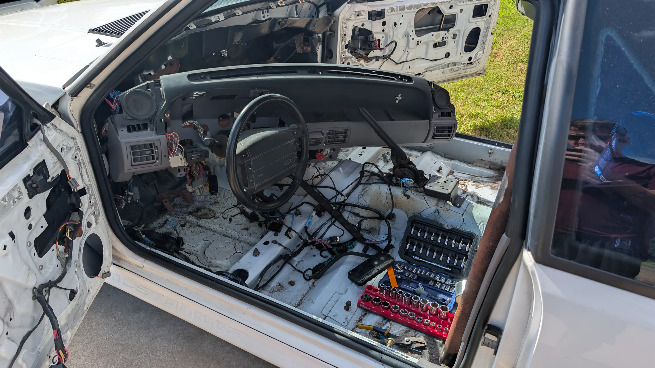

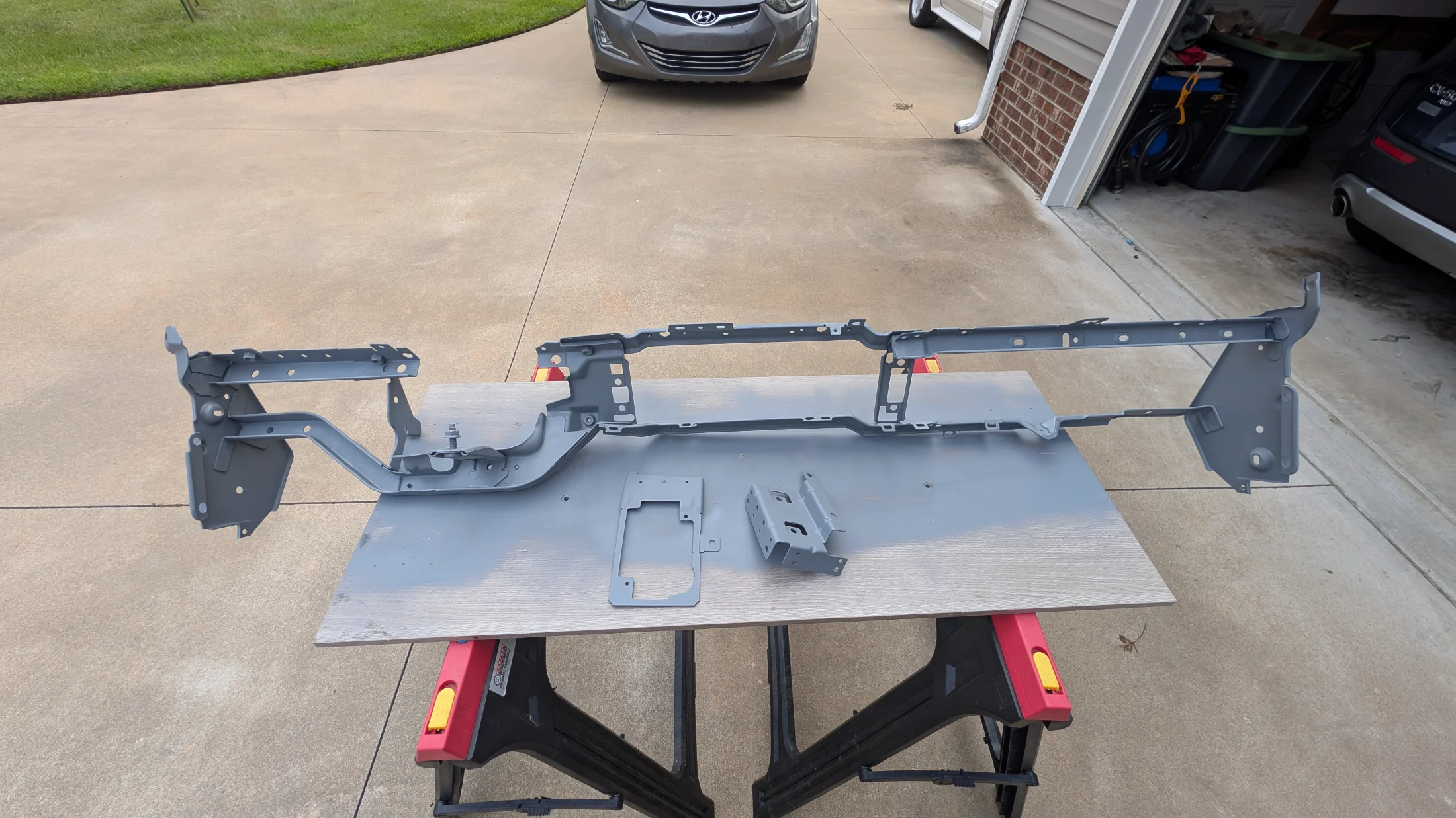

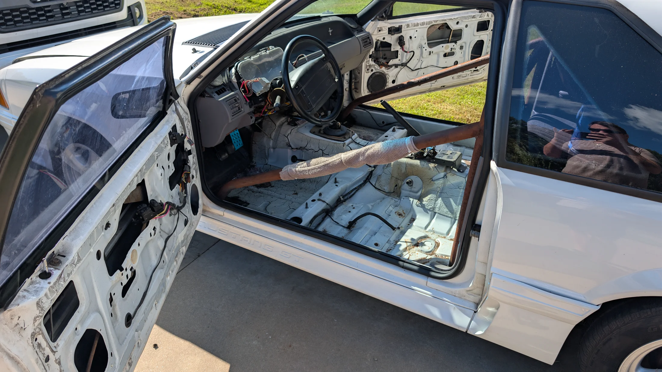

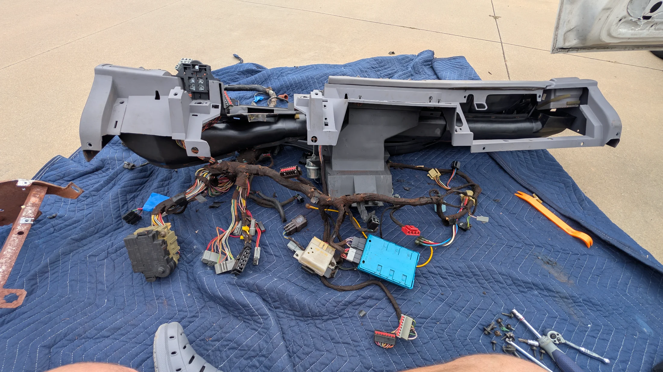

Hey y'all hope all is well. Sold the tubular K member as I didn't have any info on it. Have some progress on my project finally. Removing the interior currently to replace carpets, and replacing heater core and evap. I got the HVAC box all restored cleaned up and all seals replaced.
As I was disassembling the dash I noticed surface rust on the frame of the dash. I want to remove the dash completely so I can properly take care of the rust and paint it to prevent future rust but damn all the videos I've seen I have to remove the wiring harness???? Seems like a lot of work but will do it if I have to.
My question is have any of you restored the metal under the dash without fully removing the dash or have any tip and tricks for me?

Dash “cover”, frame and harness all come out as one unit. You remove the cover, then the harness, some brackets, and then you are left with the frame.

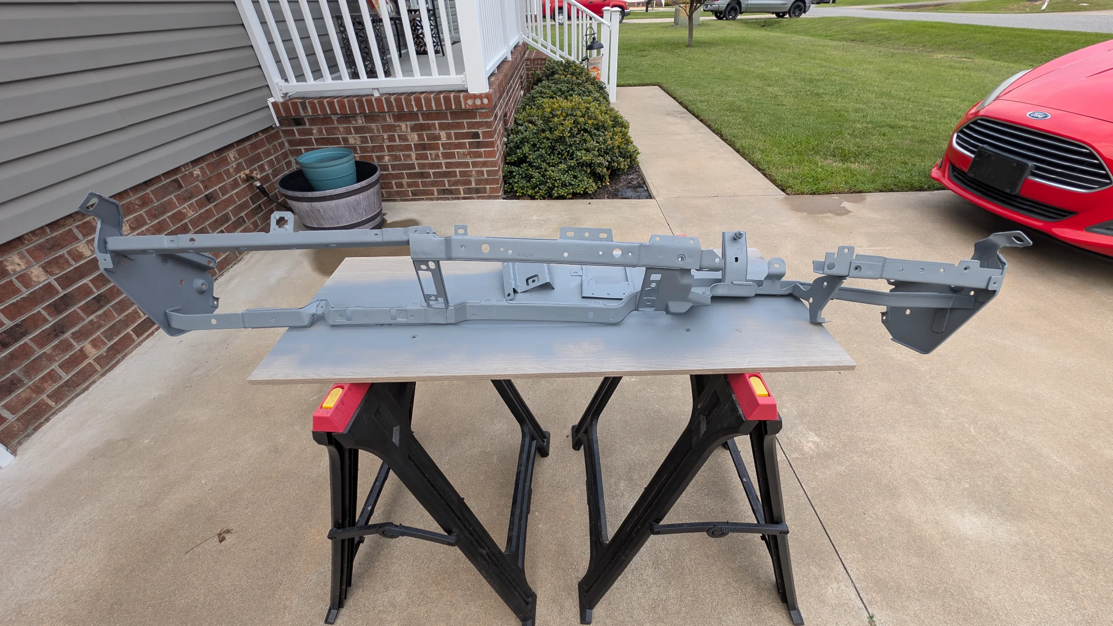

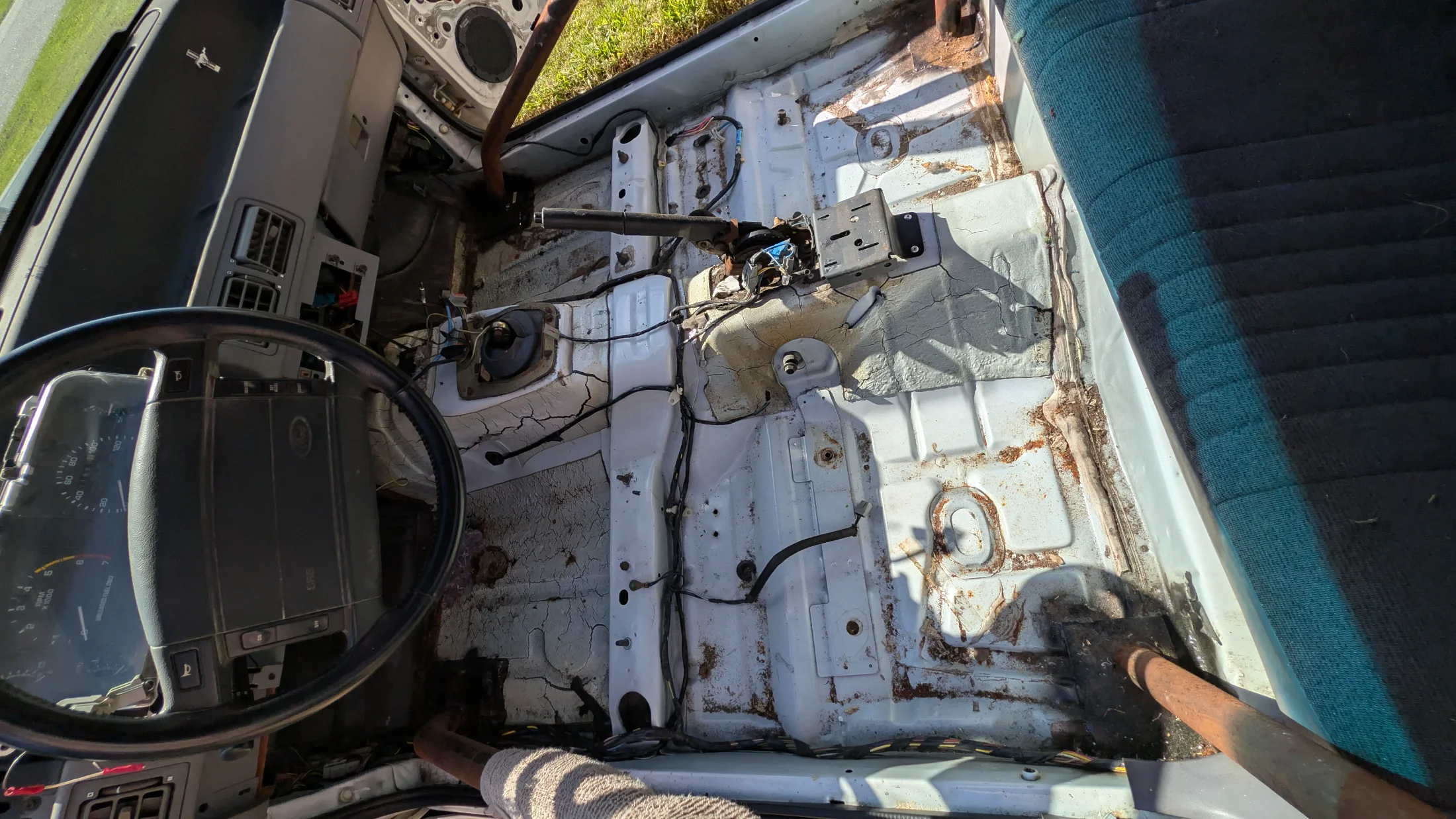

I kind of figured. Should be fun never done anything like this before. But I did it today. Should be fun putting it back in.
