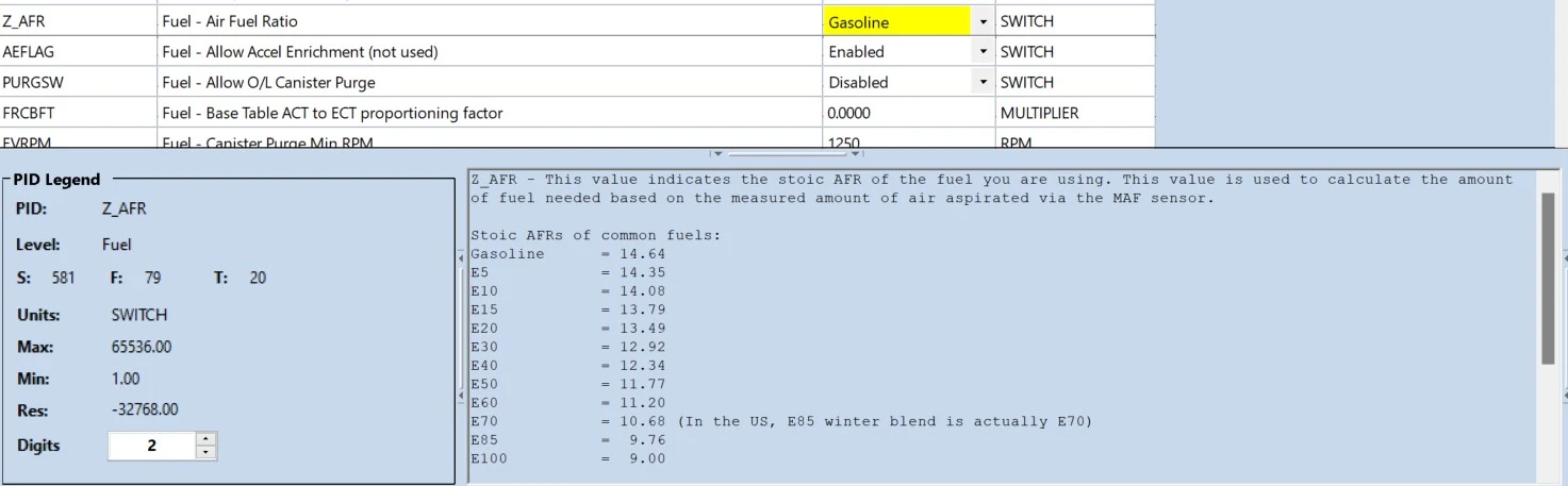

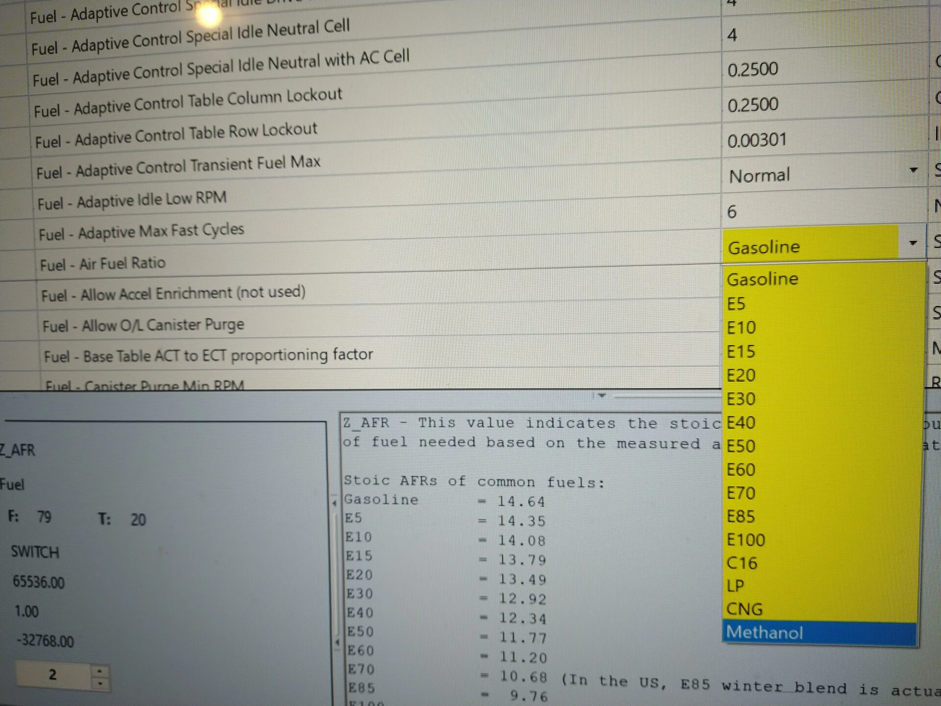

Its not a good idea like stated about the narrowband 02 sensors as it takes a bit more fuel to handle the task and not run lean.....
If you had a way to get into the ECU you can change the fuel to compensate for what you are running.....As you can see as the number in ethanol content goes up the lambda/afr goes down meaning it utilizes more fuel..
In the selection pulldown theres also selections for CNG C16 LP and methanol fuels too....
