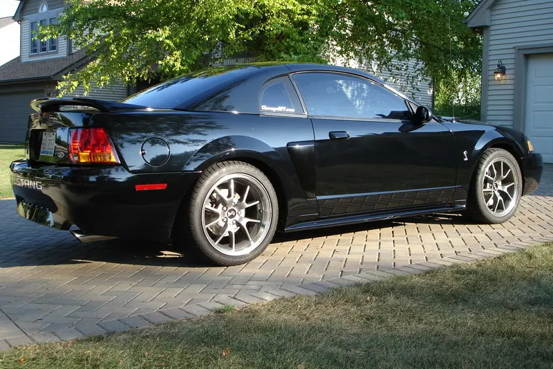

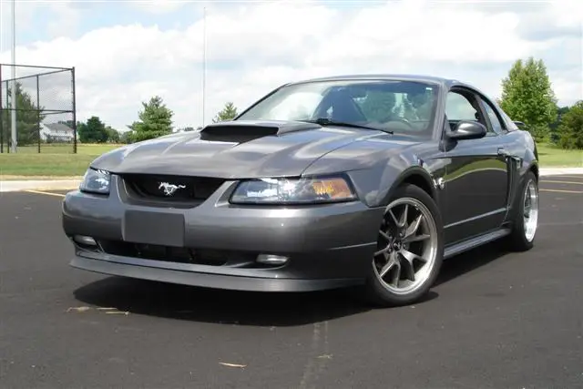

275/40/18 is too tall for the front for that car
i have 275/35/18 and its perfect!!
i used the same wheels/tires on my gt as i did my cobra
and my cobra isnt even lowered as much as yours
GT
Cobra
