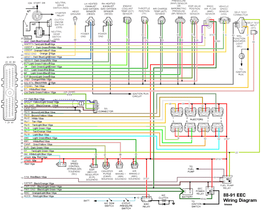

if i am not mistaken it is a duty cycled solinoid. So if you put your meter on the other side youll probably see 1/2 voltage on the other wire so about 6. when it is commanded on. For some reason your evr is commanded on all the time. I wouldnt rule out a bad evr quite yet. Just make sure you dont have a short to the ground since on the other side. If you dont i would try another evr and see what happens if you do i would repair that ground.

The computer provides the ground. It switches the green wire from battery voltage to ground many times a second. Varying the duty cycle changes the vacuum output.
Diagram courtsey of Tmoss &Stang&2birds.
See http://www.veryuseful.com/mustang/tech/engine/ for more info
I am assuming your putting the meter on ground and the other on the green wire. With engine running at idle youll see voltage at the ground because there is no ground. I dont know if this makes sense. You are providing the ground with your meter. If you had a ground the solinoid would drop the voltage and wouldnt show voltage. (since its a duty cycle solinoid your meter wont refresh fast enough so you will see voltage when its on itll probably be around 6 or so..) You may have just got a bad solinoid that is mechanicaly stuck open. Unplug the evr and remove it and see if you can blow through one of the ports out the other. If you can blow through it then the solinoid is stuck open and you need a new one.
