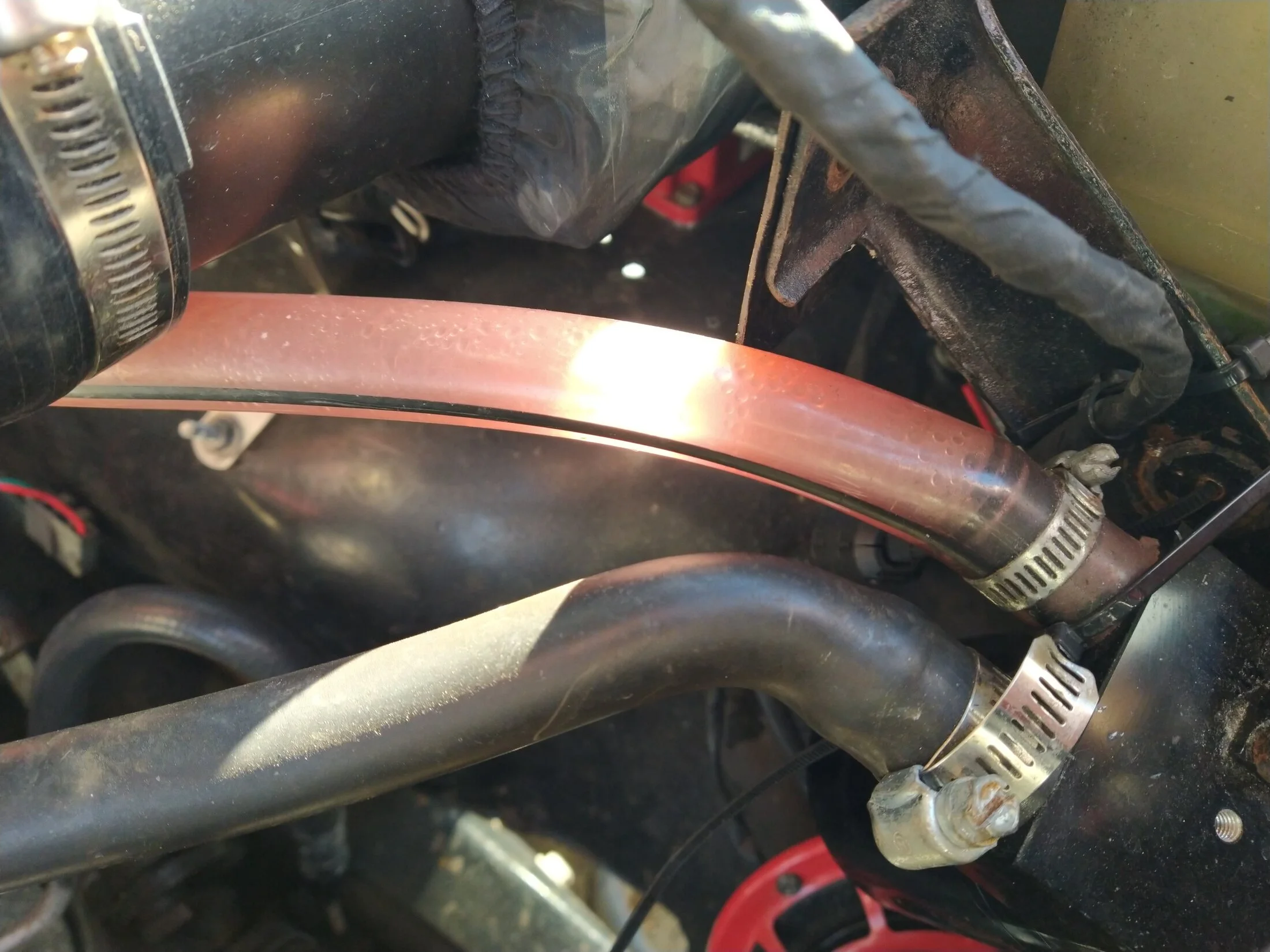

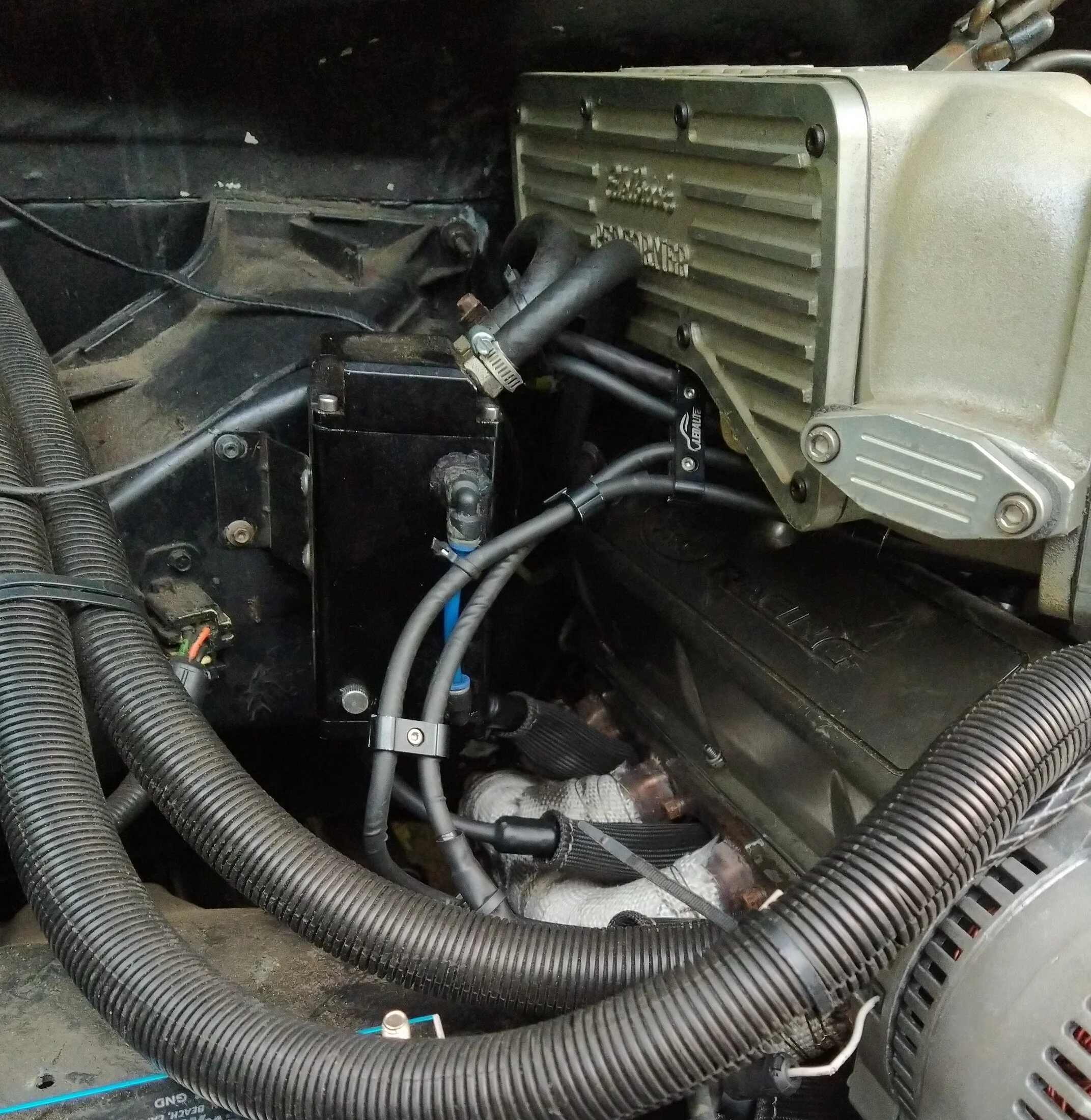

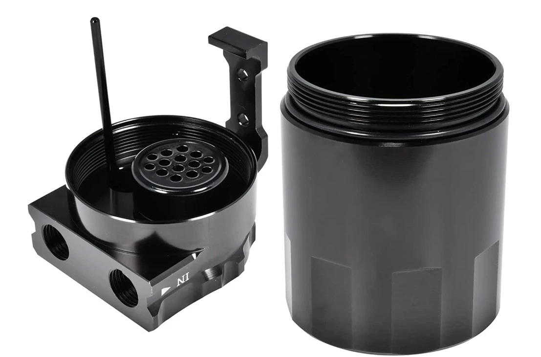

Another point you brought up is the crankcase breather........I NEVER leave my crankcase to vent out on its own and heres why......
Look at this picture below of my see thru breather tube that goes to my very tiny but very effective catch can that I modified with a draincock from a radiator and have to drain every 2-3 days plus the water is always clean and clear but smells like paint thinner...
Another thing to point out is Im running tall aluminum valvecovers and Im also running the internal baffle plates inside both covers to keep oil from going inside and I also run a different type of catch can on the PCV valve side too thats made for filtering oil out from the higher suction and whats evacuated resembles pancake batter............LOL

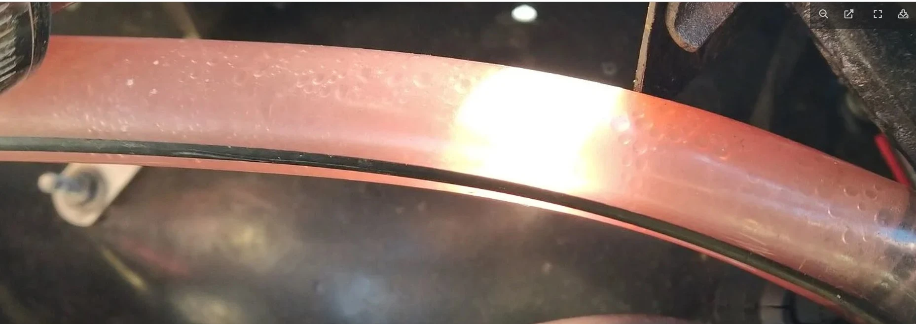

The pictures below were taken after going on a 1hr run.....
Do you notice the humidity inside the see-thru tube.....?
The suction of the intake removed that moisture...Just letting the crankcase vent out on its own so pressure will do its job but working against gravity will do very little to expel that water before turning to steam and steam is no good for bearings/ piston rings...
