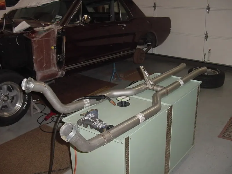

I don't know about the Magnaflow kit, but I had to modify the H-pipe that came with my Flowmaster kit to make it wider to clear the AOD.
mine works. header selection is critical for clearing the pan of an aod and also the kit is designed for long tubes that dump parallel to the car floor. Shorties, mid length and long headers that don't point straight towards the back require some bending and/or additional piping to connect. I am happy with my magnaflow system.
