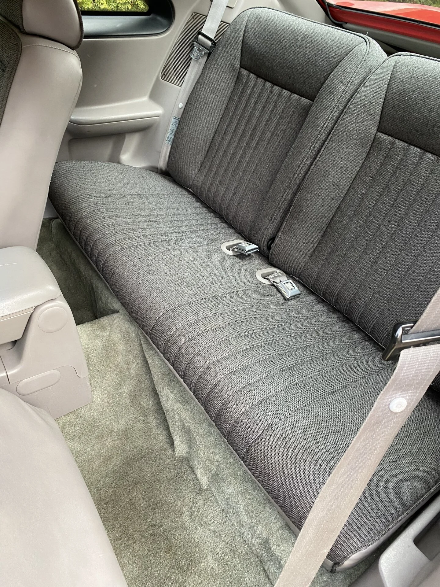

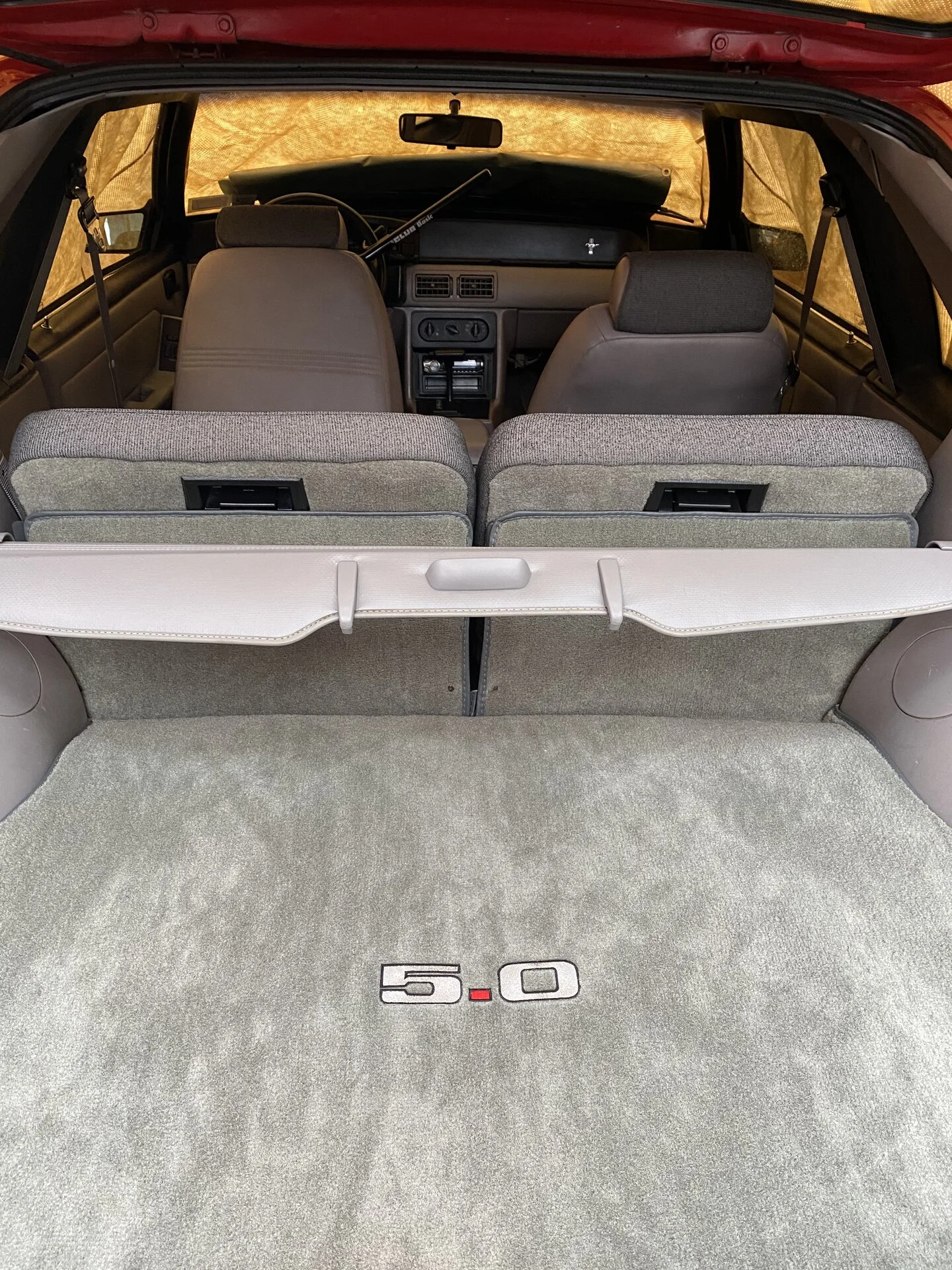

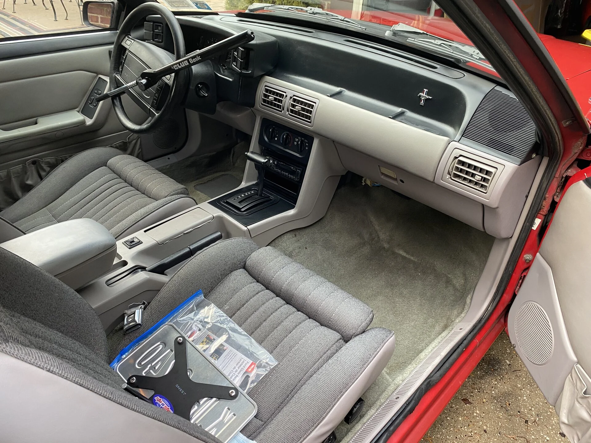

Wow, that’s nice and clean! Is the interior in as good shape as the outside?
Thank you. I appreciate that. The interior is pretty clean. Does need some scrubbing when the weather gets warmer around here and I picked up some SEM Titanium paint to spray and make everything match. I have the 5 different shades of gray thing going on right now. Lol lots to do when the snow goes away over here.
