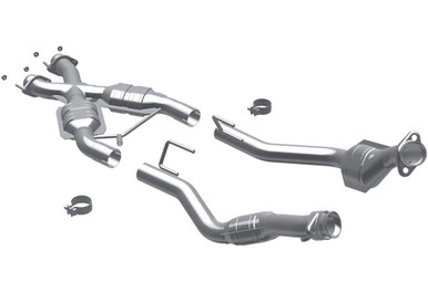

Here's a Magnaflow X-Pipe 2-1/2" Fox Body exhaust for ya:
Not cheap but it is stainless and very nicely done up. This does come with both cats, too.
Summit Racing is showing a $75 rebate:
