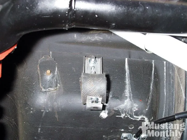

I always start from the front and work my way back. The factory hangers attach to the rear of the mufflers and on the body in the same vicinity as the seat belt anchors. See photo:
The other set of hangers attach to the tailpipes and the inboard sides of the rear subframe rails just ahead of the leaf spring hangers. See photo:
