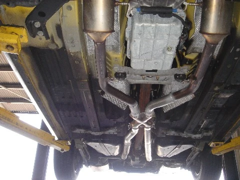

yep 2.5 is just fine order the left pipe from ford and the brackets get an x pipe and the gt takeoffs and for about 450.00 total your all good :)
