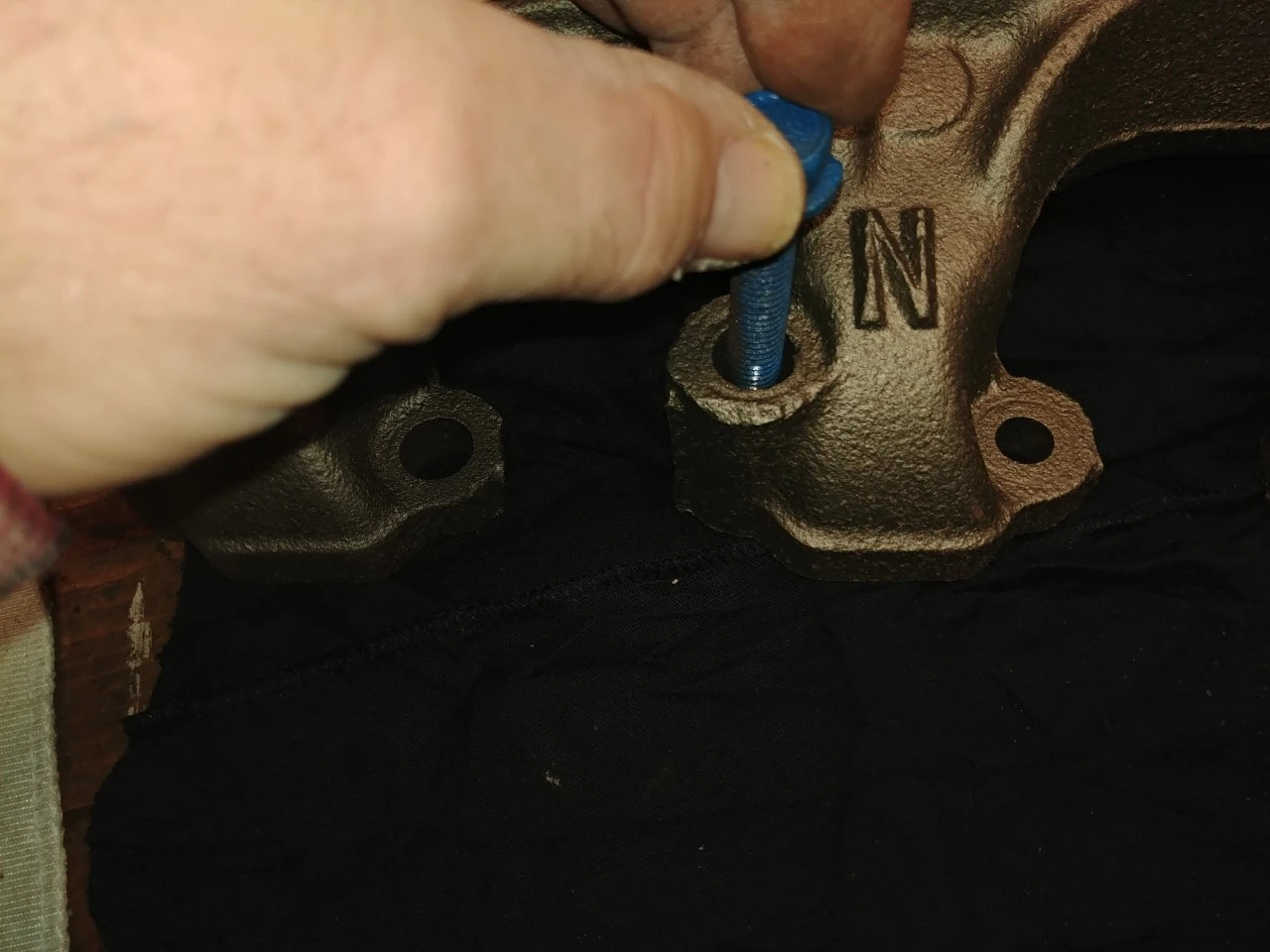

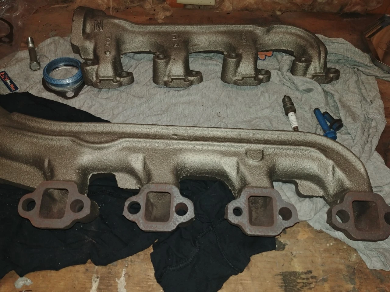

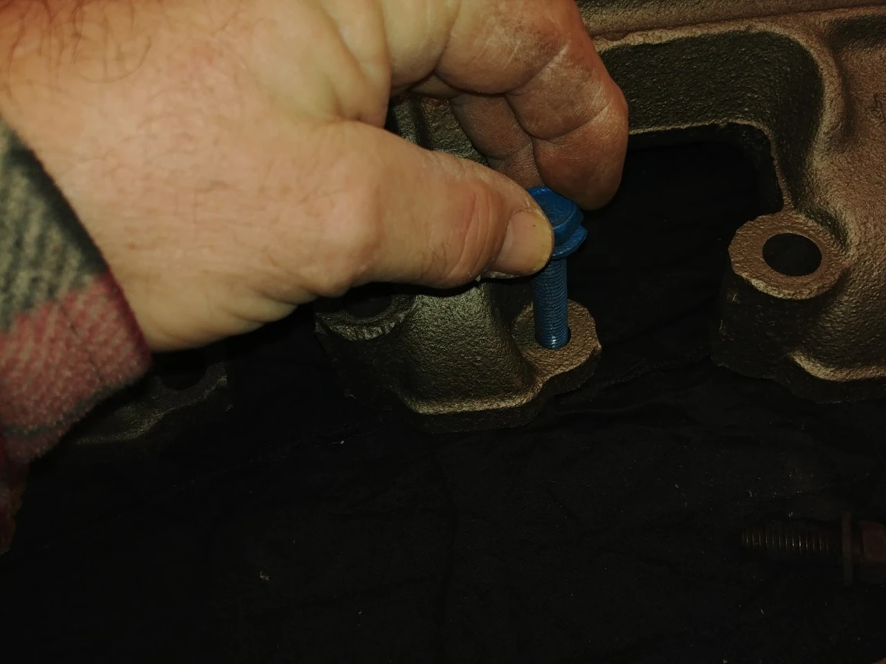

hi just noticed your post,i am up against the same thing.my motor motor never had the manifolds on it.so now up against the same problem.did you have any luck finding the bolts.

@2Blue2 said, that he thinks the bigger bolt holes are needed for heat expansion (exhaust manifold is hotter than cylinder head; manifold will expand more). The diameter/size of the bolt is defined by thread size in the cylinder head and they are the same for all bolts. Just buy bolts in the right length and don't mind about the bigger bolt holes.
You can see on your last picture that the impress of the bolt head has the same diameter on both (small and big bore)...
