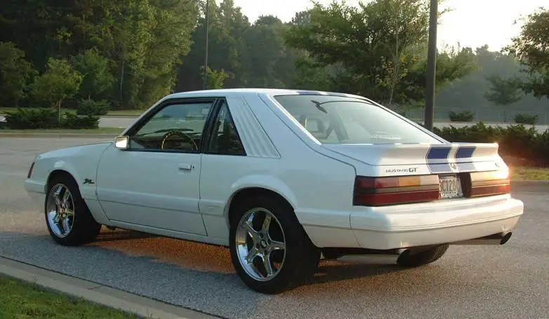

Personally, I think the 2.5" tips are outdated. While they looked decent from the factory back in the 80's, they just look puny by today's standards. I have been running a 2.5" system with 3.5" tips on my Fox for years now and I think they look just right and I have received many compliments. They certainly do not look out of place on my '85 GT and, if anything, provide a more menacing look from the rear. :nice:
But to each his own.

Those do look nice. You should see mine though, i mean they are REDICULOUS HUGE. lol. What's really bothering me is the noise level of my stang. The drone is killing me. I think if i ditch the tips it would make a huge difference. While i'm at it though, i really need to lose those old manifolds for some headers, and an X or H is a must have.
