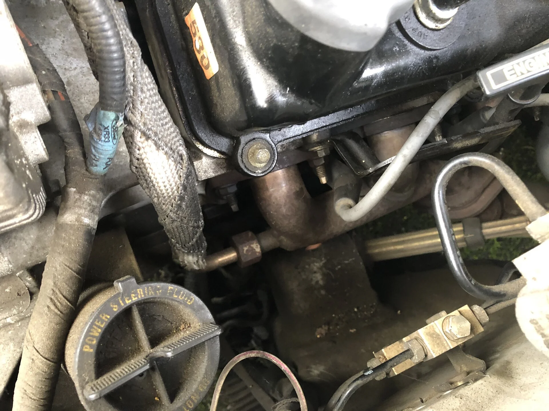

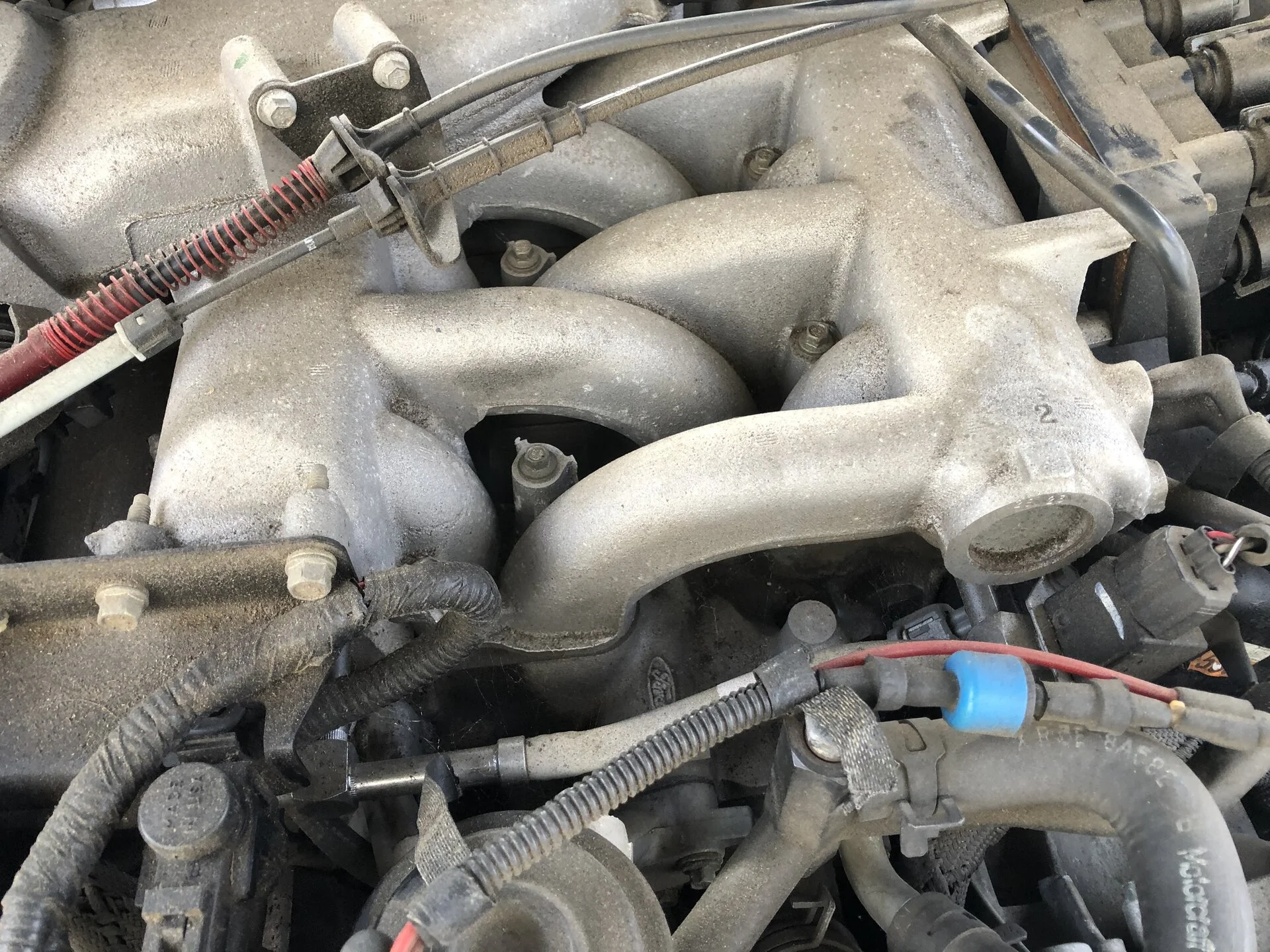

Here are a couple pics, one showing the top of the engine and one showing the shorty headers or whatever you call them. IMG_5178.webp IMG_5167.webp

Thanks for that info. Do you know if all '99's came with factory shorty headers, maybe that could be why mine has the smaller studs?
If it has shorty headers, they're probably not factory. The ones I'm finding for factory are all like this: 3.8 Exhaust Manifolds Which do seem a touch nicer than the average manifold, but also not separate tubes to a collector like a header. Could be that someone swapped them and ended up putting thread inserts in to drop the size down. Hard to say for sure.
Those are the ones I have on mine in your link which are factory since I bought mine new from the dealer. I just assumed they were called shorties also, just factory shorties. :) Since they are factory, then not all heads are equal because of the stud size difference.
