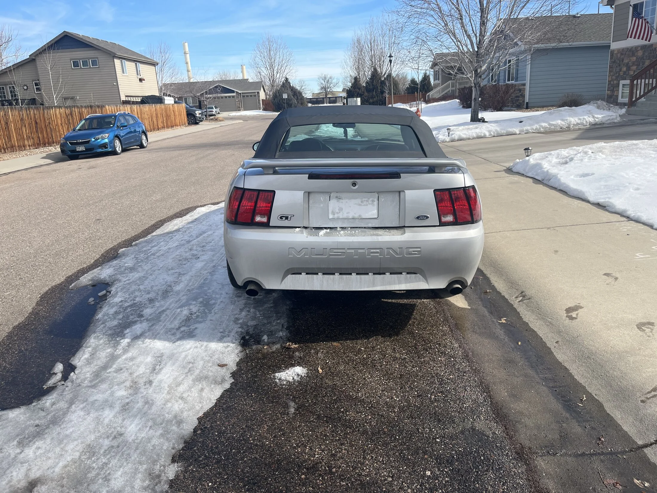

Oh, and post some pics of this fine piece of automotive machinery.

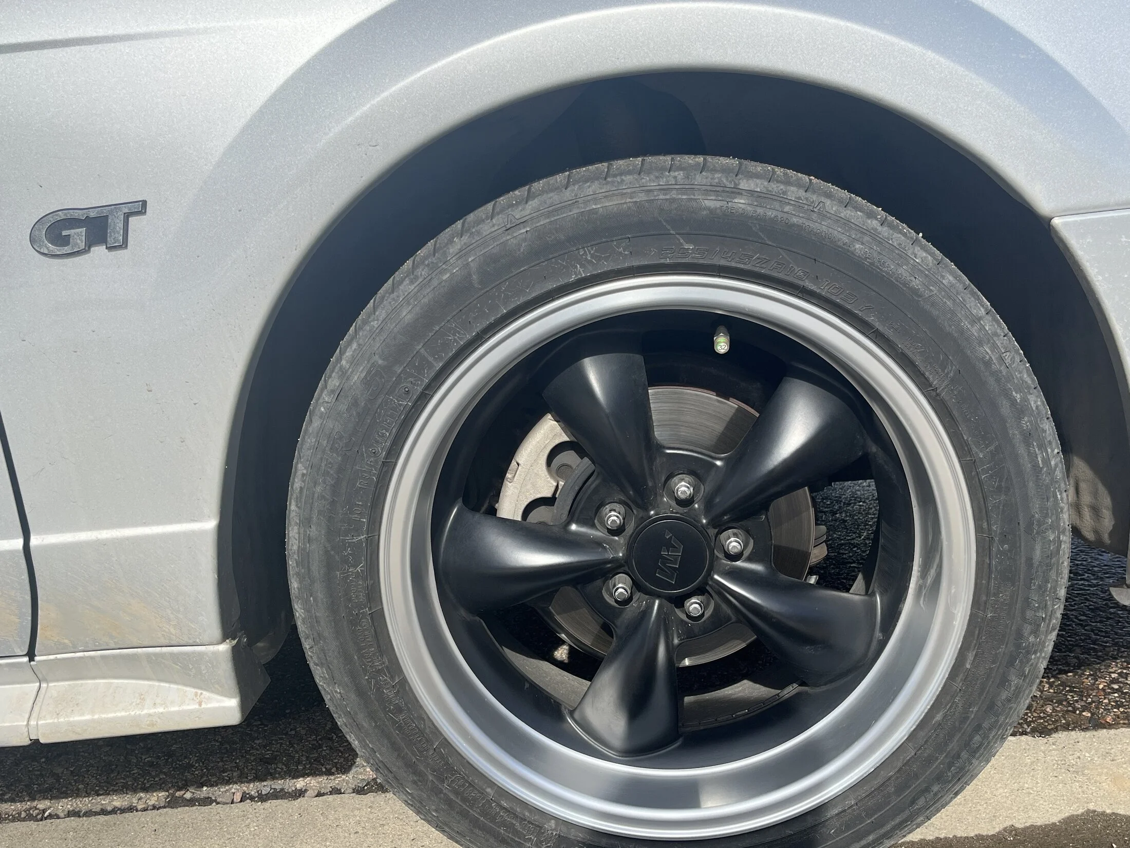

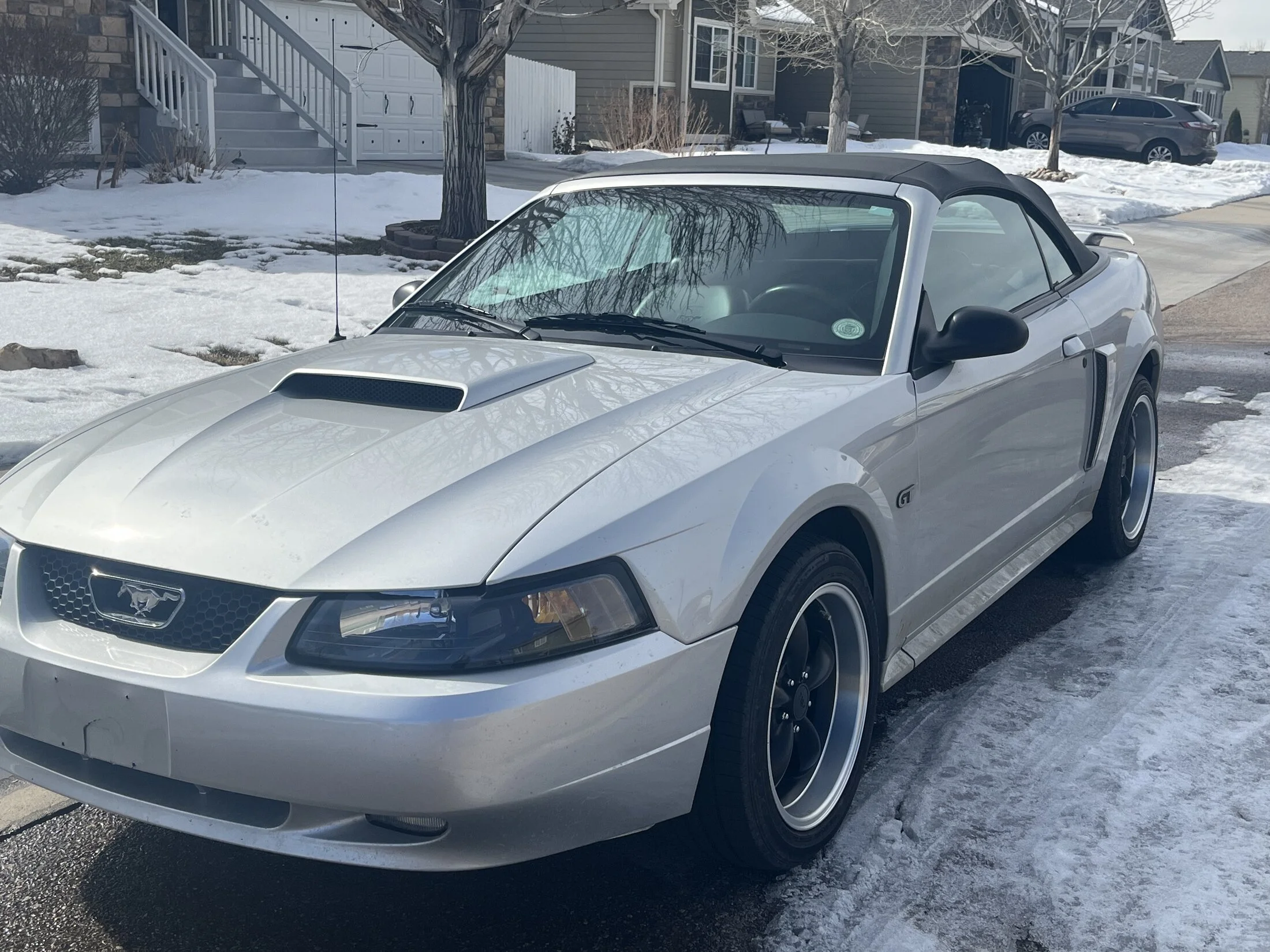

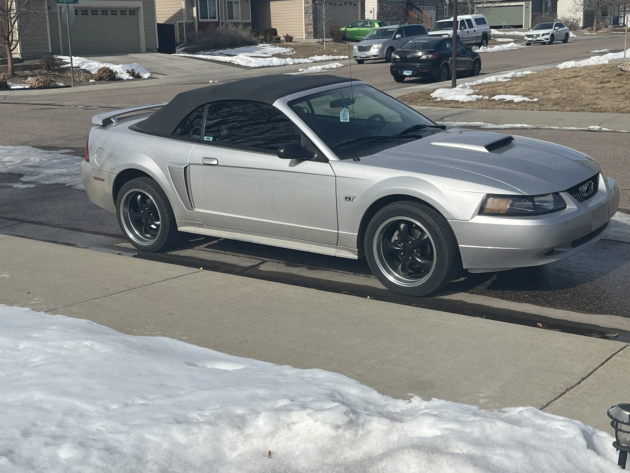

And can I just say how awesome this place is, I’ve never really had anyone to ever talk to about car stuff like I would on here, like everyone always cares and wants to help another mustang owner, and it’s absolutely amazing, lol nobody has ever asked me for a picture of my car or anything so it honestly means a lot to me that y’all care to see it! I think it’s a beast lol just want it to feel like one too, got the metallic silver finish with the black drop top, and some American Muscle rims that fit perfectly with the car, I love it
