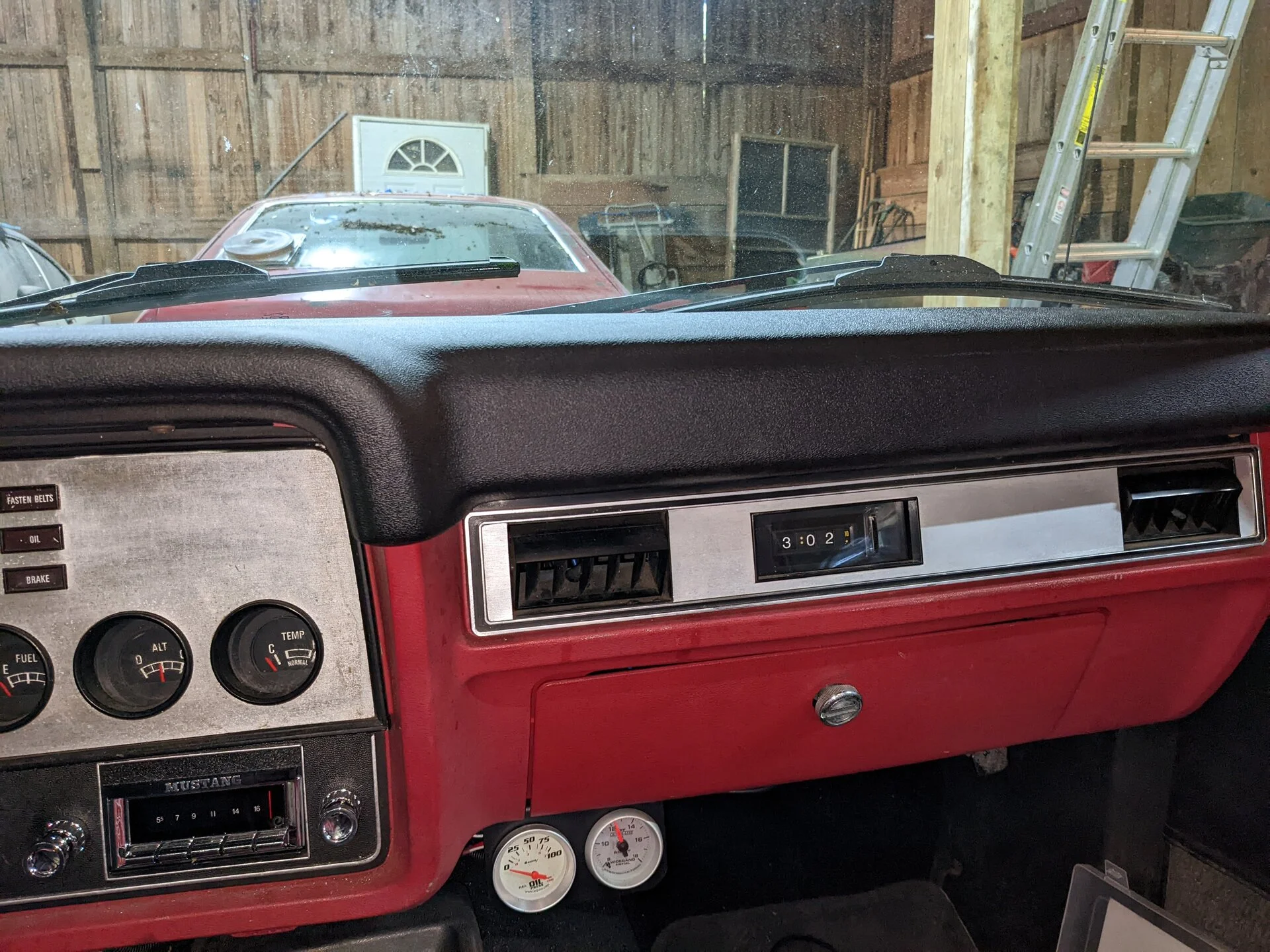

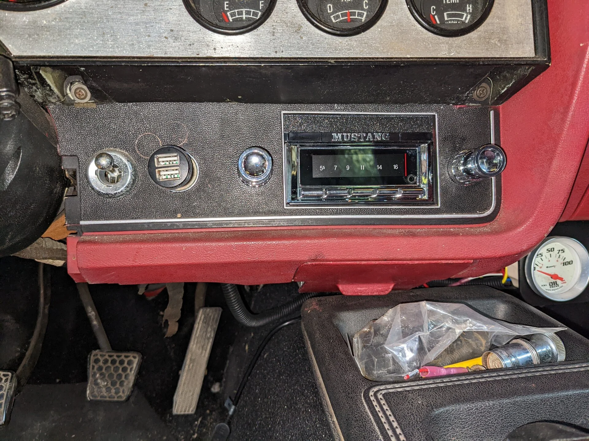

I had some free time I painted the dash bezels with a Krylon silver leaf paint pen. It looks pretty good. Cleaned with glass cleaner then painted it on. It is very close if not an exact match to the factory lines
Before
After
Reactions: Enzio and LILCBRA
The paint pen was easy and looks pretty good. Although now I want the chromed gauge cluster bezels.

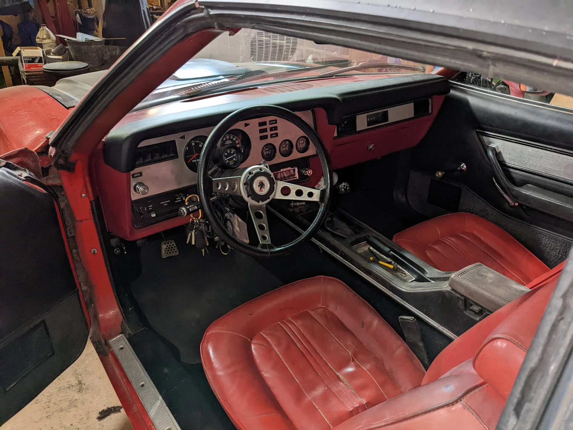

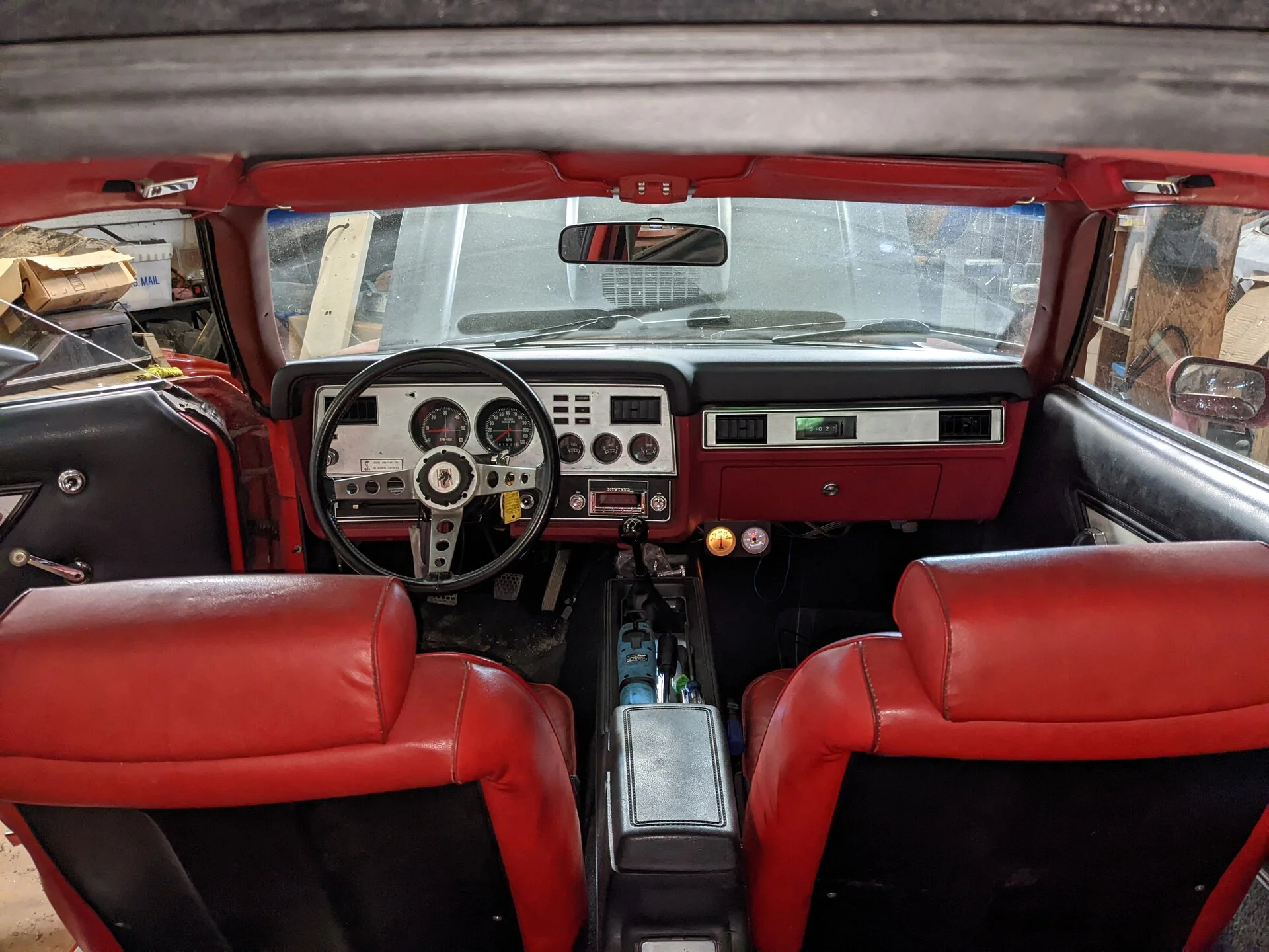

New dash bezel. Was originally chrome trim but in really bad shape. I used the paint pen to go over the old chrome. It looks okay. Not great but better then it was.
Notice the tach!!!!! Column mounted one is gone and factory working as intended!
Ignore the Shelby America logo. It will be gone when I either paint or more likely replace the "stainless steel applique"

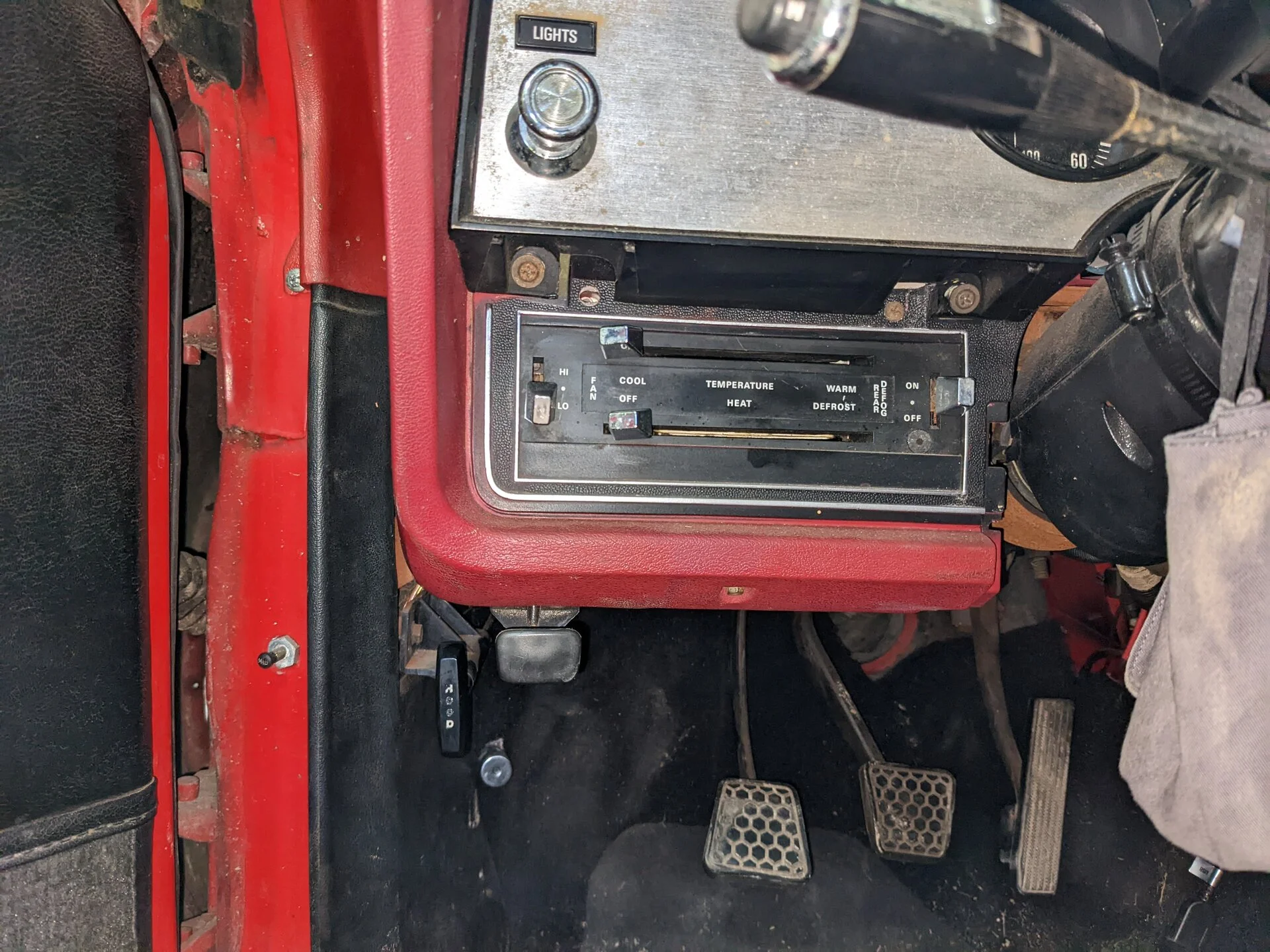

After front wheels are ordered and on the next step is pulling the ac/heater box from parts car and get it rebuilt then installed.
Old.
New.

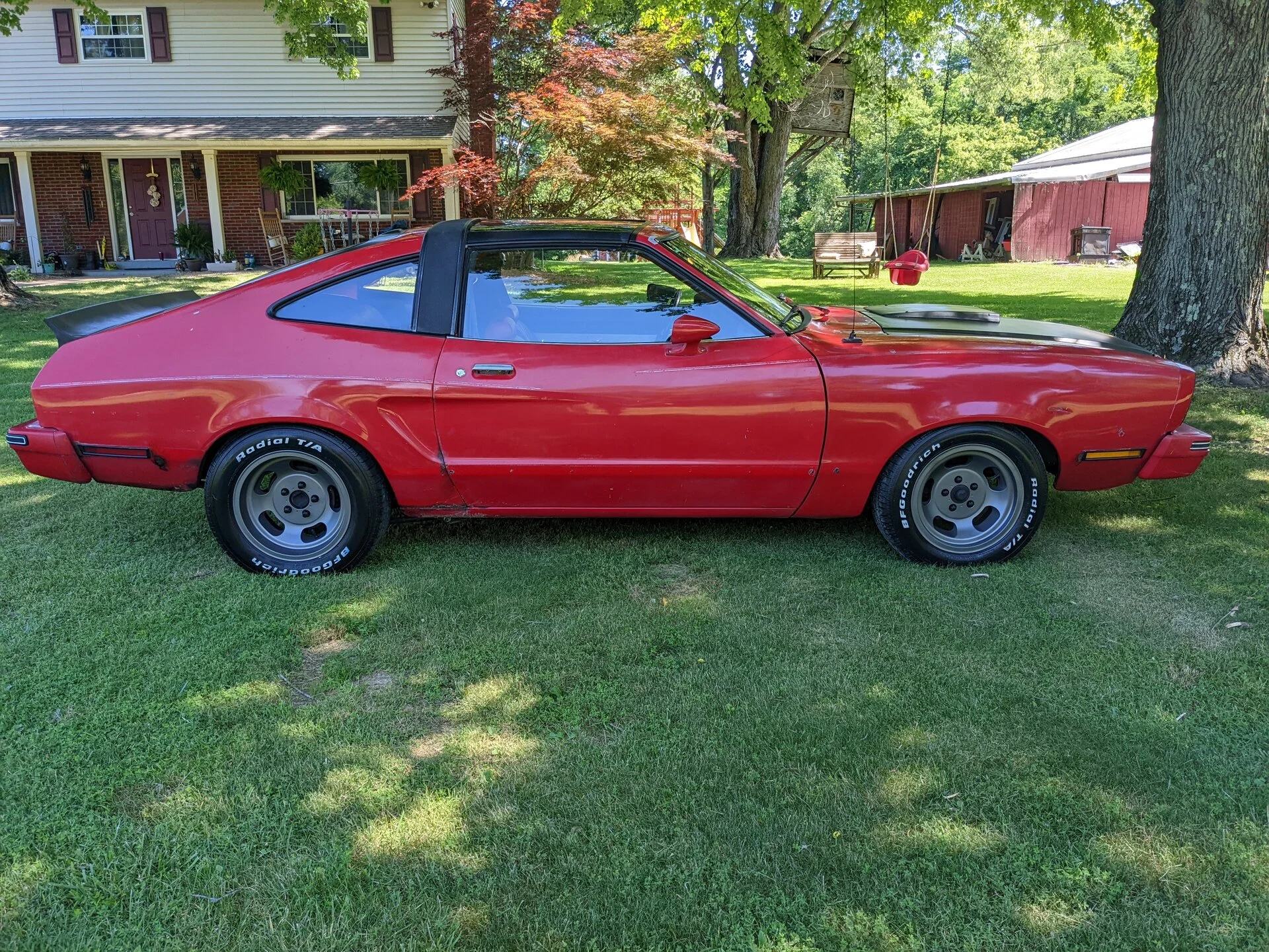

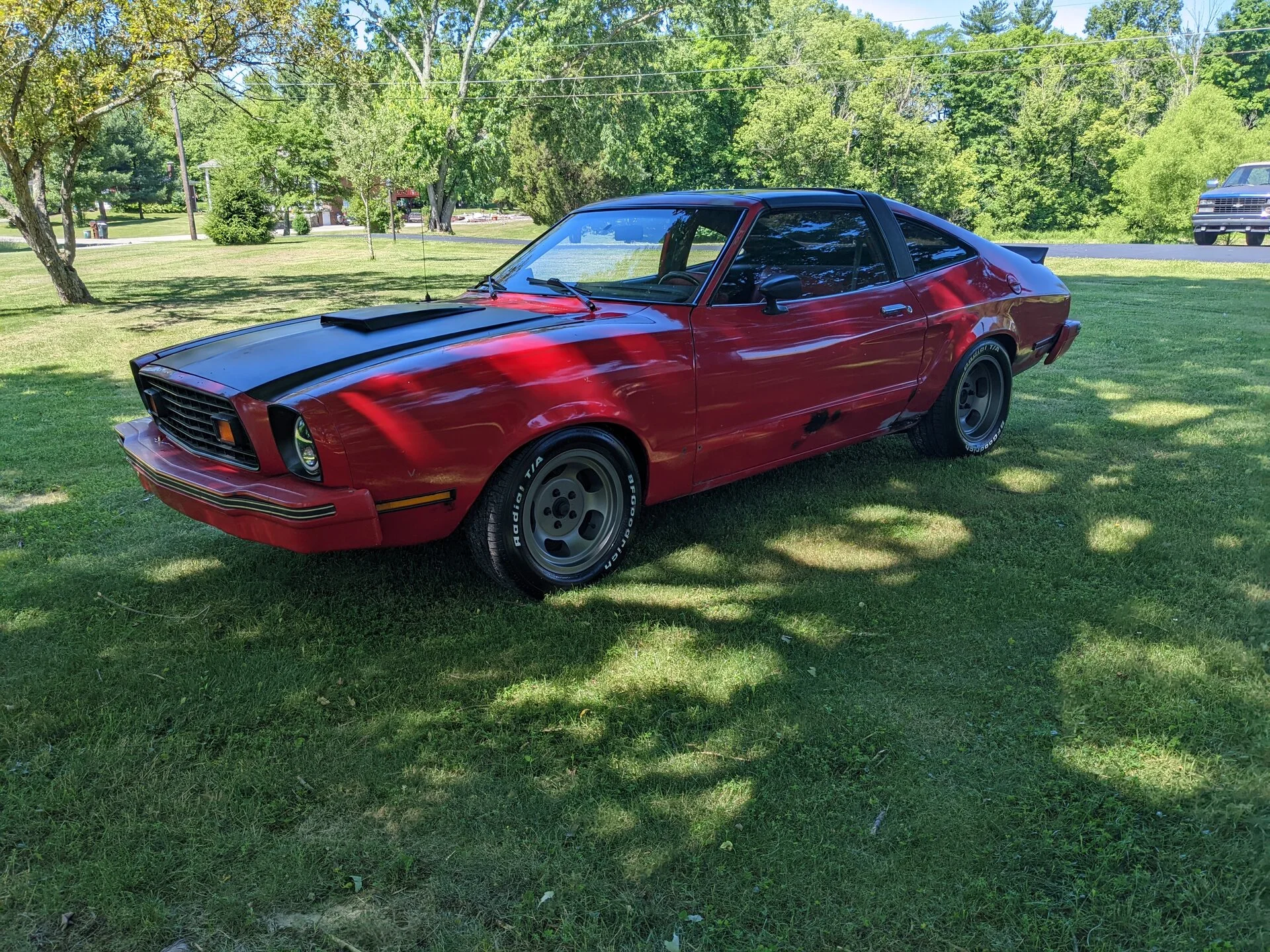

New front wheels were put on a month ago. They did not help vibrations much if at all. I guess I have to get used to them but they look out of proportion currently. Too much front wheel for a small car. Minor rubbing on right front but an alignment should help. That wheel sits a little too far back in the wheel well.

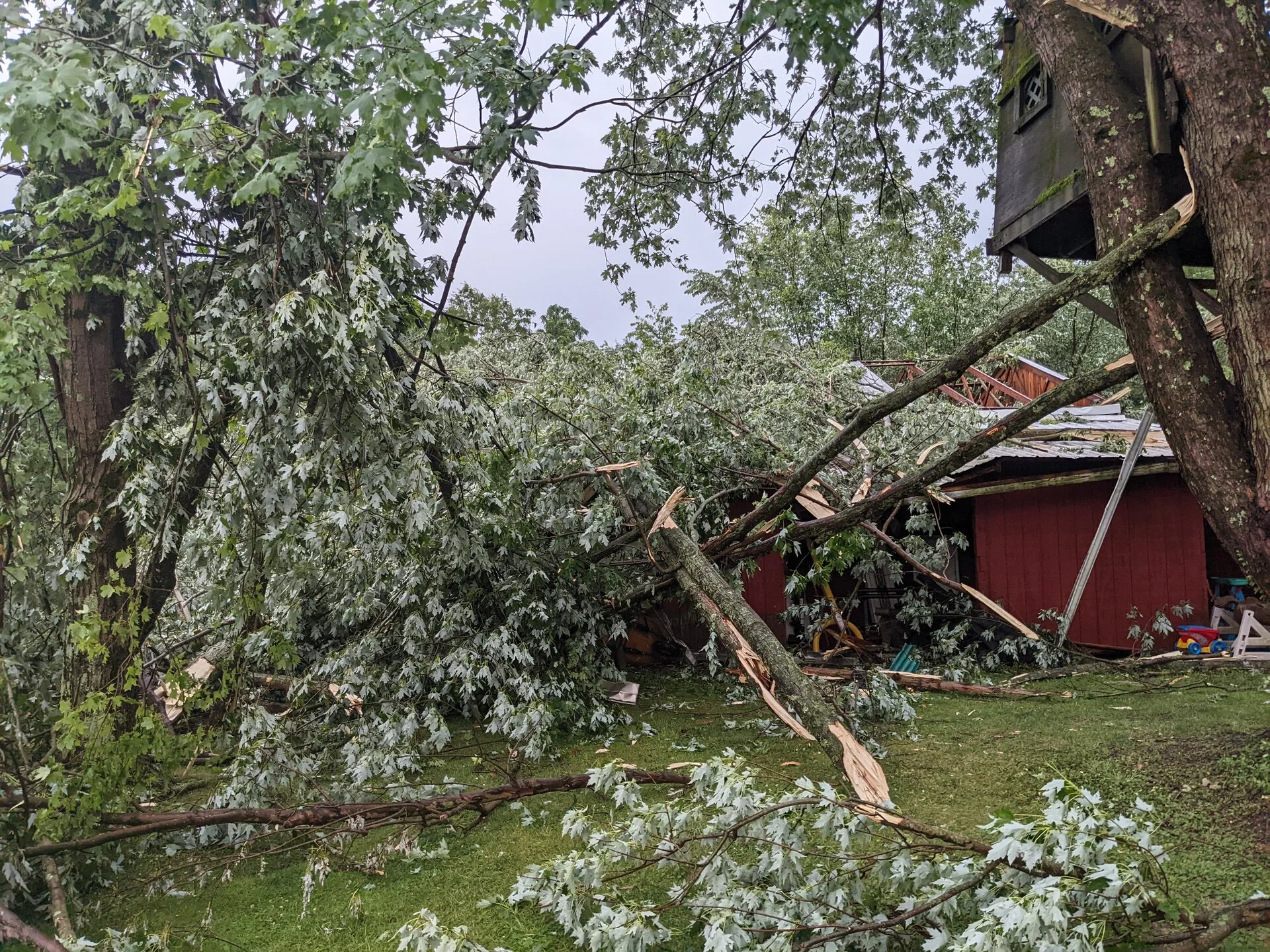

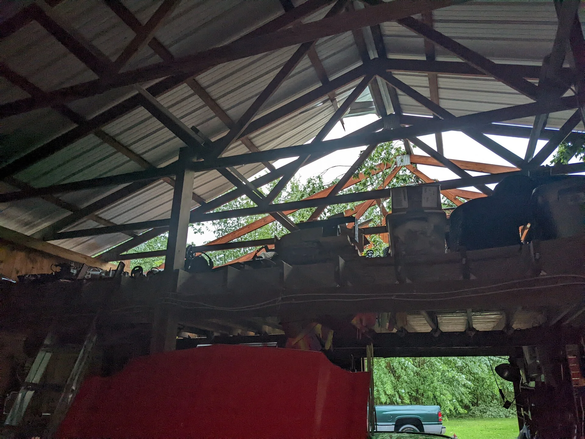

I will be taking time/funding away from the cars to address my newly acquired skylight feature of the workshop. Our pool and chicken coupe need repairs as well. The only damage to cars were this one was being soaked as it was parked under the missing roof when the suddenly acquired skylight was obtained. Being a t top and dried out seals the interior was wet but I got her covered before the carpet got soaked. As well as a slightly damaged hood from my sons car. It was not bolted on and flew about 40 feet. It has a gouge near the scoop but looks straight.

If there's a bright side here it's that the treehouse looks to still be intact. ;)
Looks to be a lot of clean up and a LOT of work to be done. I'd offer some help if you weren't literally halfway across the country.

Treehouse was being held up by 1 board and 2 lag bolts. It was drooping down about a foot on the one side. We had to pull it down as it was barely holding itself up. I was afraid it would come down on us while working under it. It's a pile of ashes now.
We have most of the branches cleaned up. Just waiting on callbacks from contractors not affiliated with our insurance company. All in all we are lucky. The house only has minor damage. Some of our neighboring homes were destroyed. We have a few outbuildings damaged. Very minor compared to what could have been.

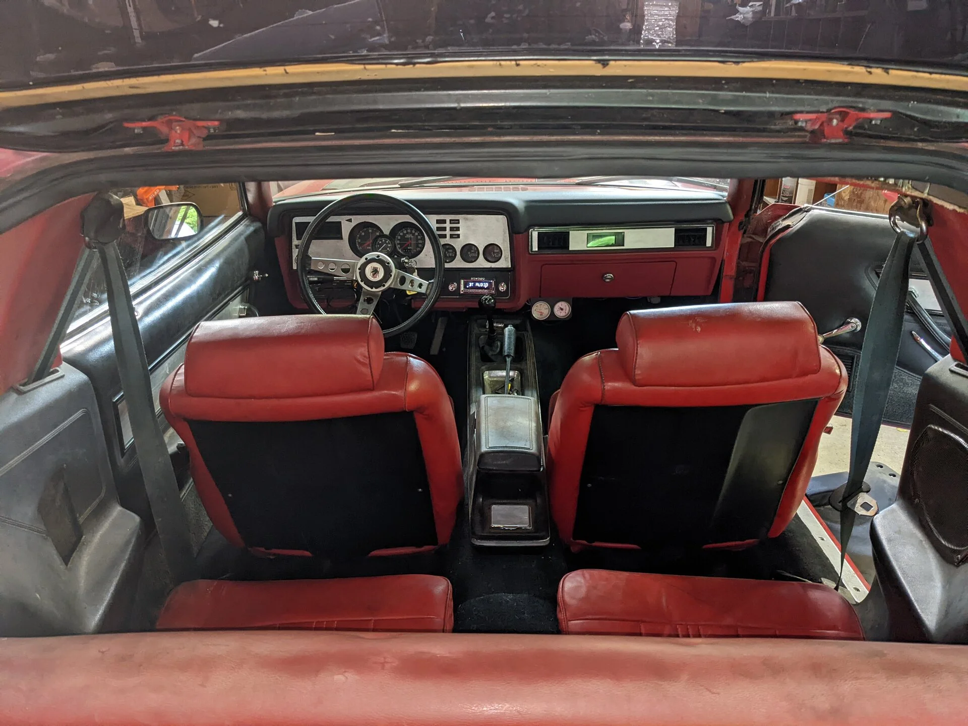

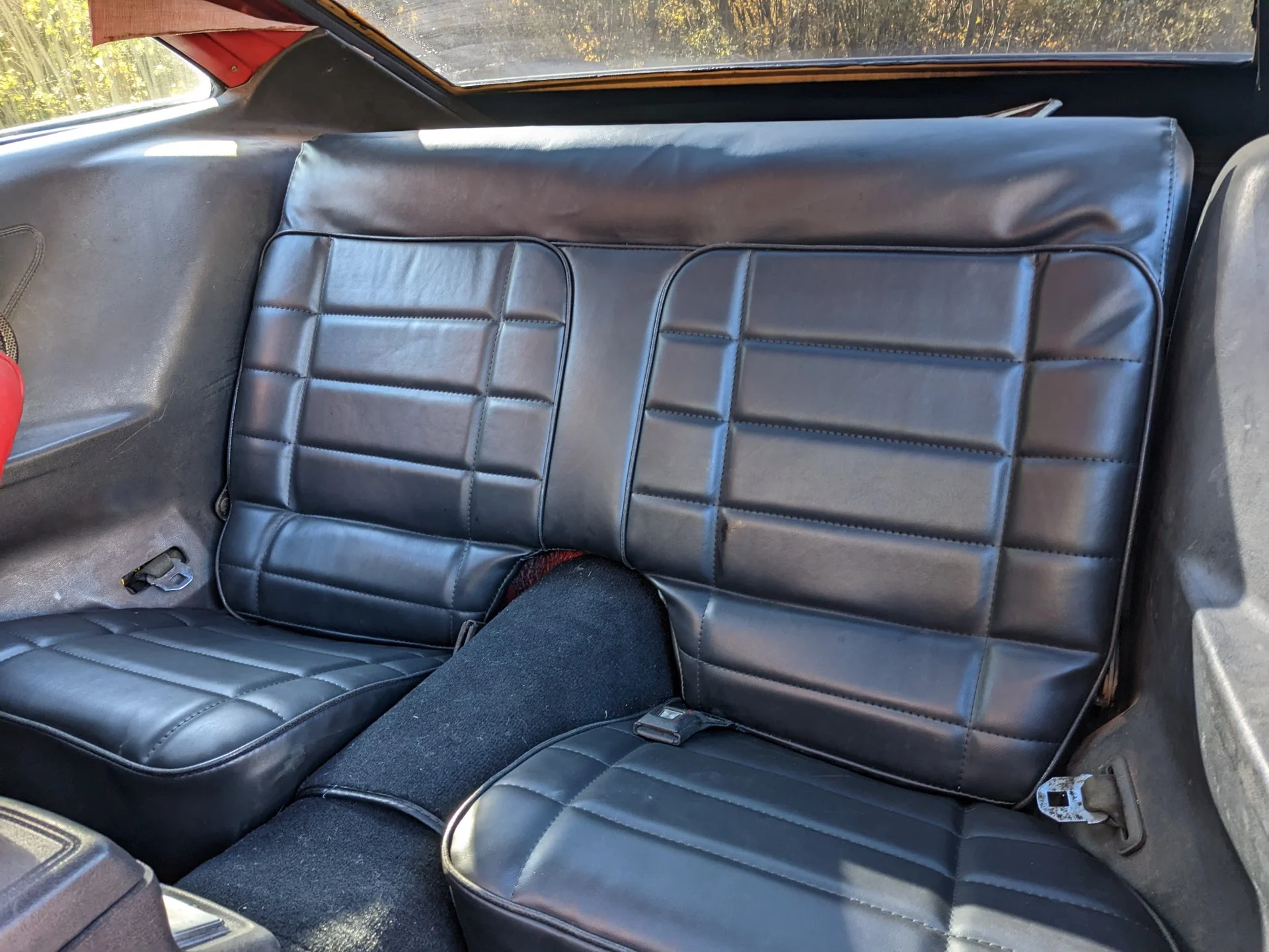

Rear seats are mostly recovered. After doing the rears I am debating on paying someone to do the fronts. Do not try on a cooler day. It was about 60 degrees and the material had no stretch. I did the bottoms inside and they were pliable. I needed air for the stapler on the rears and worked outside in the sun to try and get it more pliable. It needs warmer temps to stretch at all. The plastic clip sewn onto the back seat cover is in the wrong place. Makes that part about an inch too long and doesn't pull the material tight. You can see a wrinkle up high but that will be fixed by coming up with a solution for the plastic clip. I had to buy a 20ga air stapler. Hand stapler will not penetrate the seat backing. Get short staples. I used 3/8 staples and they came through the back side. It's hidden when installed but there are alot of sharp points back there now. The seats come with a cheap hog ring pliers. A nicer pair is recommended. It worked but wasn't as easy a nice set of pliers would have been.

I love the rear seats! very well done.
