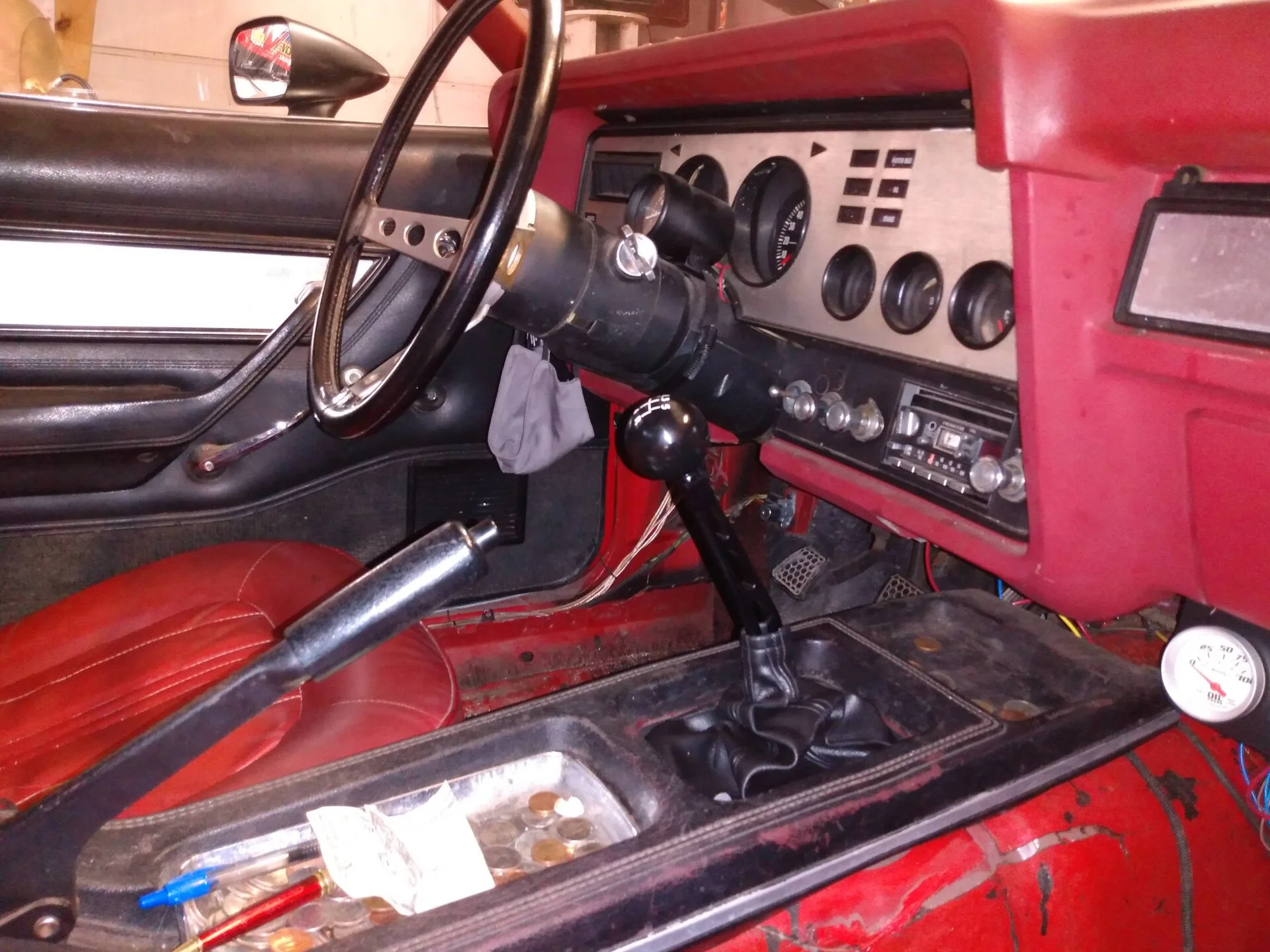

How is your shifter boot looking?
DIY shifter handle is easy to do, if you can borrow a tube bender.
img_20210115_173412-jpg.670303
Done with that tube bender (except it is yellow):

I received my replacement shifter. They even comped me a shift boot. I went with the Lokar 6" 30degree arm. Looks great and location is now perfect. Modern Driveline really stepped up.

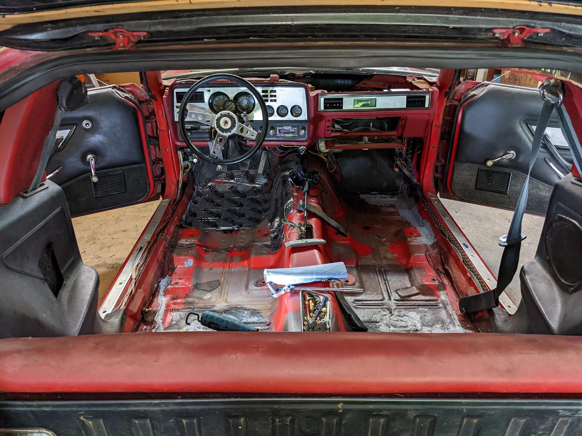

Seats are out and most of the rubberized noise dampener has been removed. I found a small amount of surface rust in drivers floor. Treated that with coroseal. Wiped floor clean with degreaser then glass cleaner. I did remove a significant amount of loose seam sealer. I guess I will have to replace that before installing the killmat. Two steps forward and one step back.
I did not make as much progress as I had hoped but I did get to drive it sitting on the floor. I now understand why my wife hates that 5 letter S word. Short.

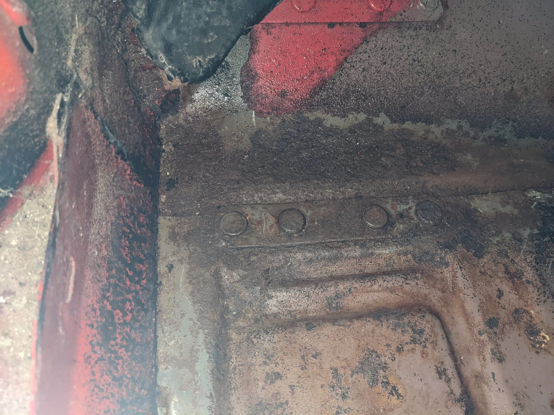

I treated the surface rust that was there with corroseal. Looks like moisture from wet shoes or possibly water intrusion around the bolts for the torque boxes. I sealed the seams paying special attention to the rusty area. It says paintable in 30 minutes but it takes a full day to actually dry. I tried using a caulk gun but wound up smearing it on by hand as the gun doesn't push the sealer into seams. These two steps caused a few days delay as they dried.

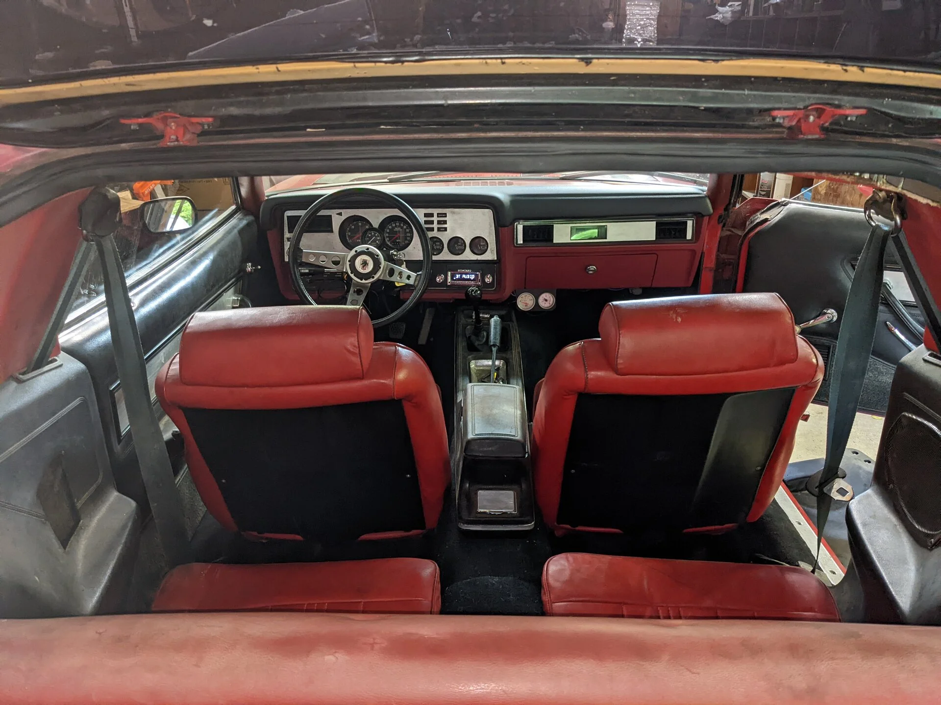

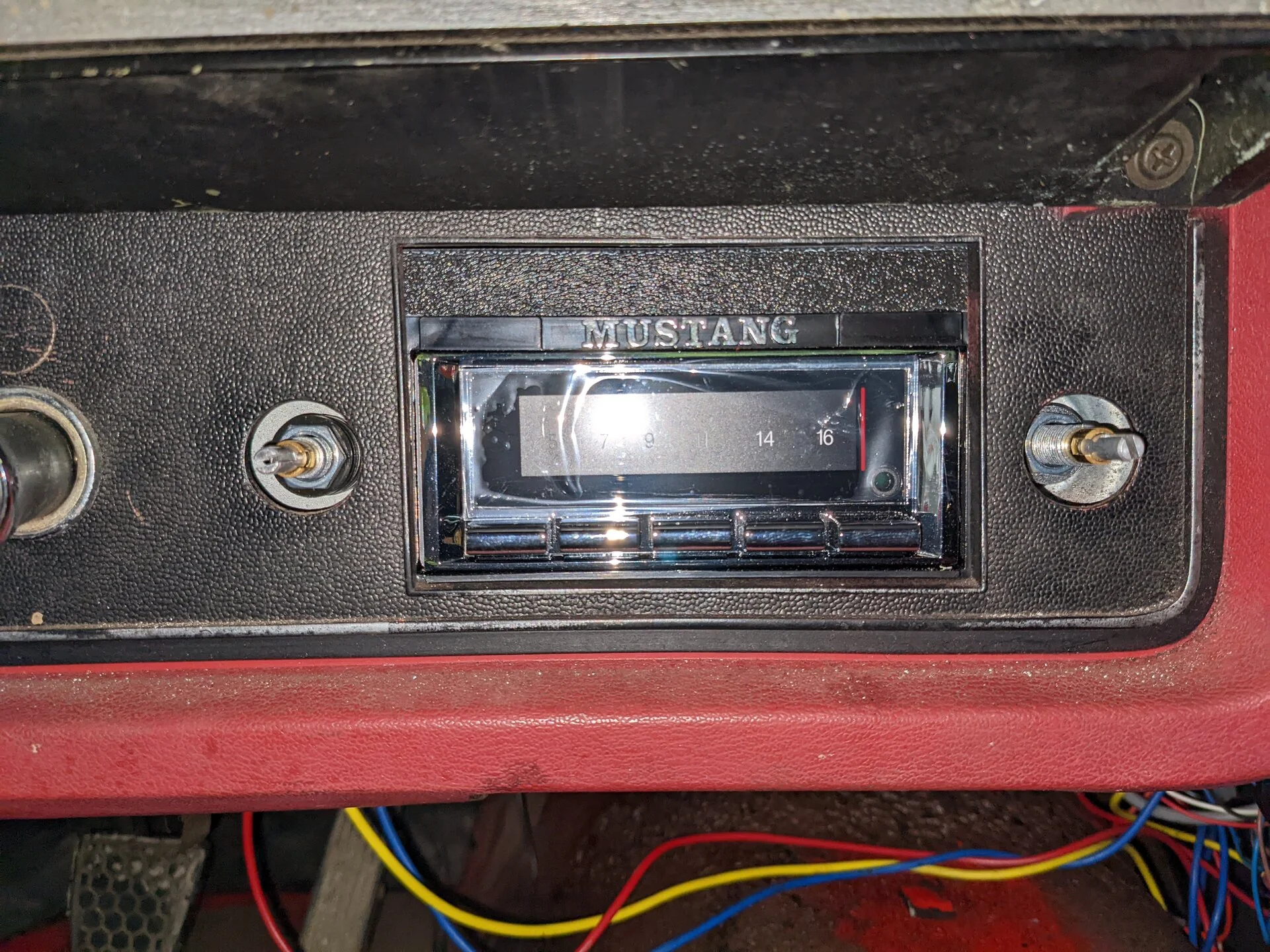

I now have a working stereo! I only used the fm radio during testing but the usa740 is installed and looks great. A little too modern but it's the best match in a new radio I could find. The lettering on the display is hardly noticeable in use. It comes with the correct filler piece installed and has spacers for our odd radio mounting. They did not just label this for II's. It's setup just for us out of the box.
I took a bunch of pictures but they were all cloudy from the lens protector I put on my new phone. Here are the ones that turned out okay.

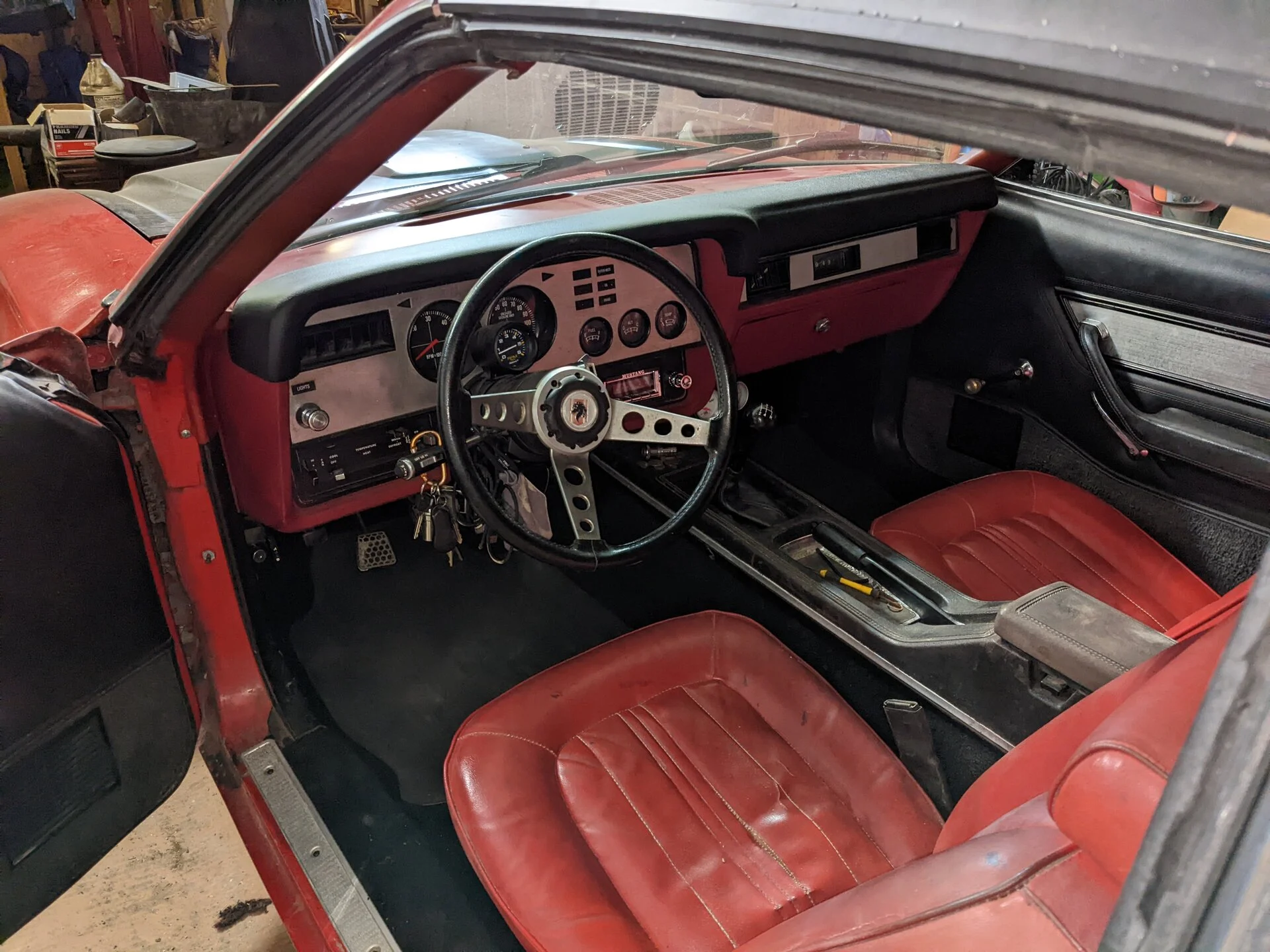

Carpet is installed. It's chilly and cloudy here this morning so the carpet was a little harder to manipulate. If your installing your own, trim the carpet. Then tighten down the threshold trim then install the outboard seat belt bolts. The carpet is just wide enough to be captured by the threshold trim. When doing the inboard seat belt bolts it pulled the carpet from the threshold trim. I had to remove the inner bolts and do the outboard bolts first. To keep the carpet under the threshold trim I kneeled on the threshold trim as I tightened the Inboard ones. I imagine a warmer day may make this easier.
I put the dash cap on. Its not glued yet as I am debating if I am going to paint the steel portion. It is a snug fit without the glue. I was planning on having an all black interior but am warming to the mismatched interior as it matches the body. I have the v6 t top which has black interior and hounds tooth seats. The tracks and brackets are rusty but the seats are in better shape than these red ones. Its a cancerous mess but I have a hard time stealing parts from a complete car.

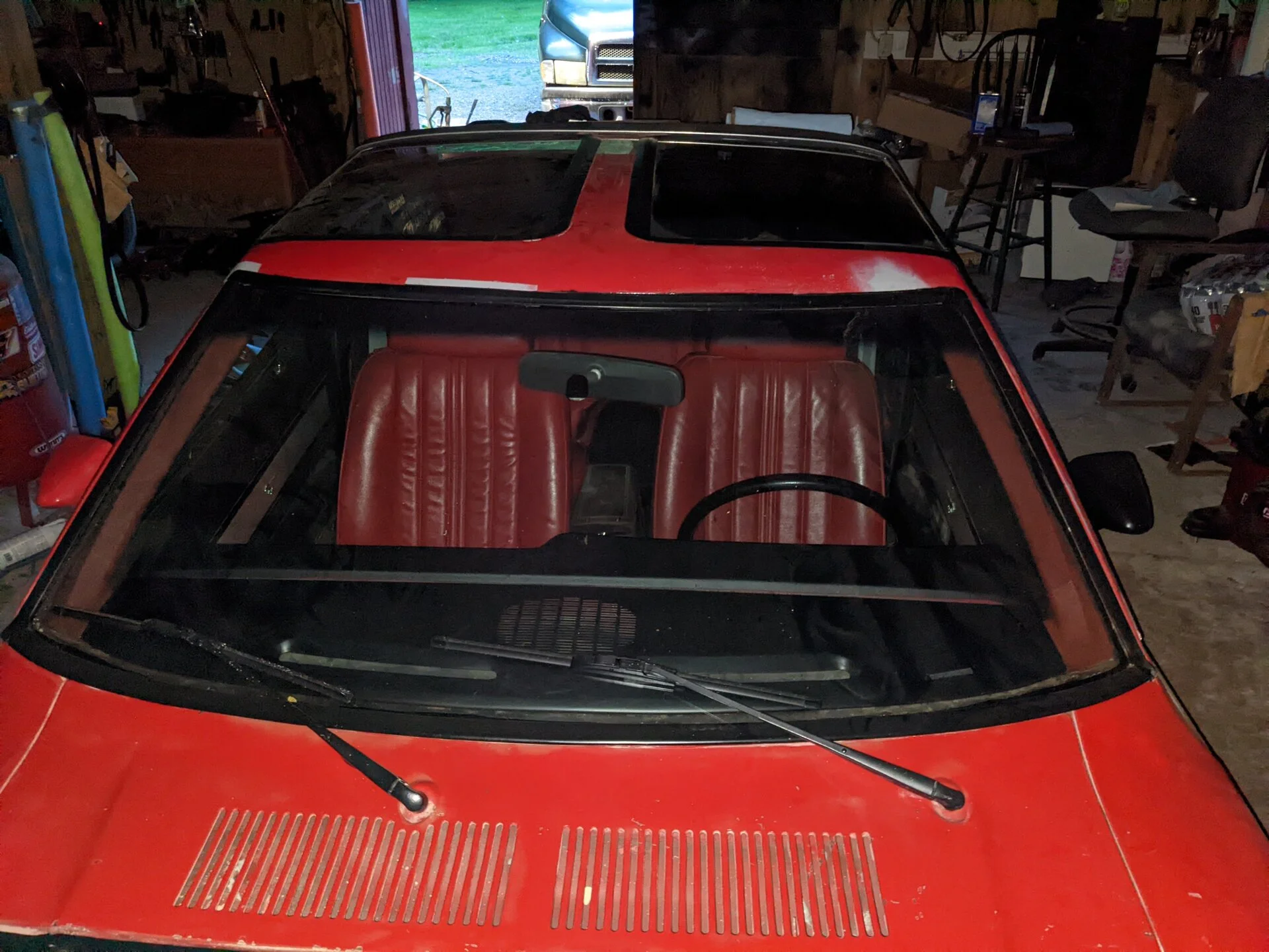

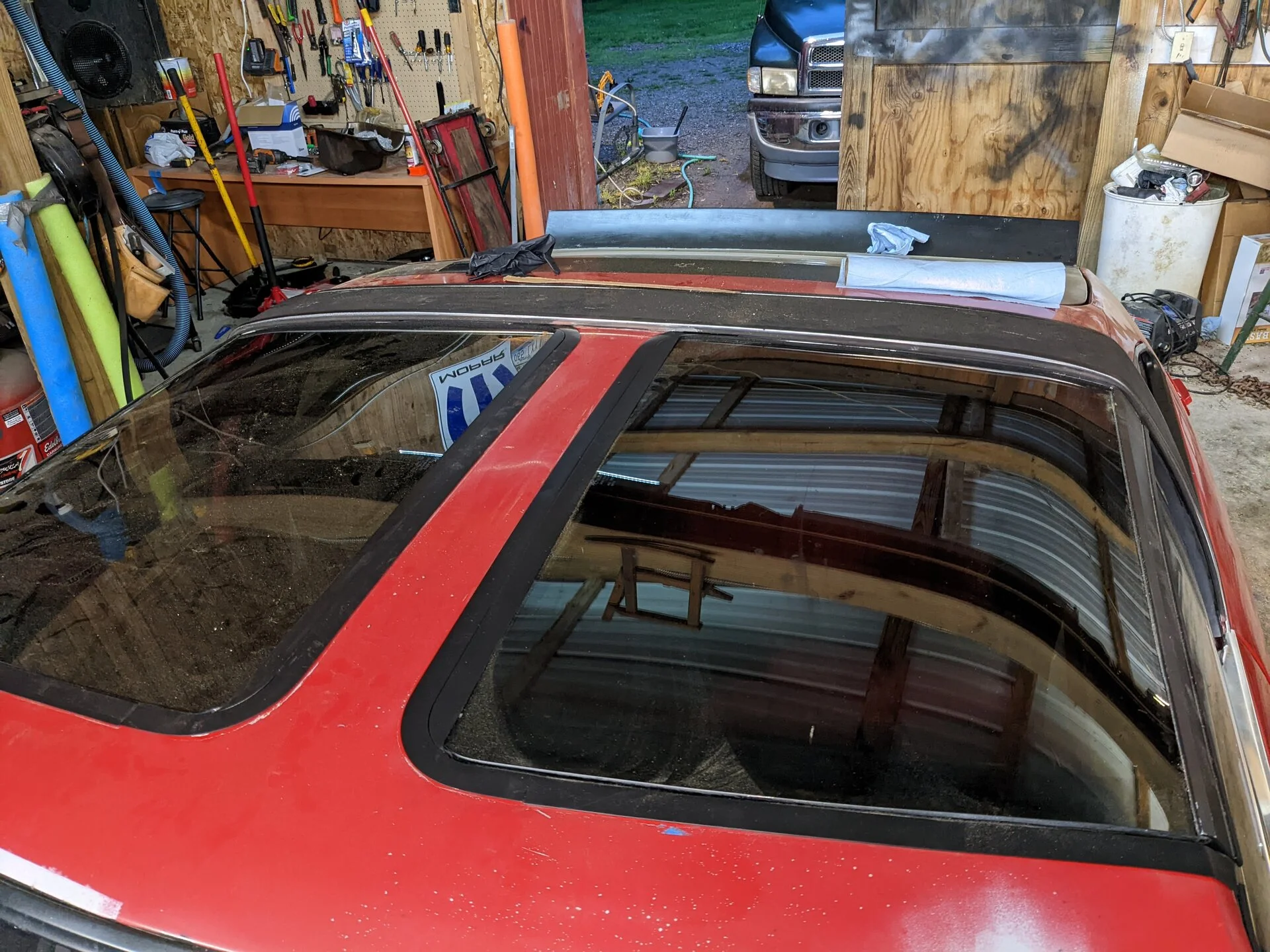

T Tops are done for now. I painted the original trim pieces and riveted them in place. Installed some 1' wide thin felt. It looks similar to the factory stuff. Fist time I have seen the top finished. It looks good. My pics haven't updated to my google drive yet so they will be attached to the next post.

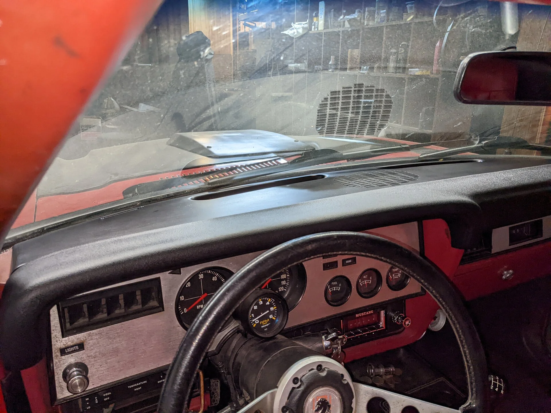

Finished up the dash pad and layed it in place. I will have to paint the original cushion as I can see a red line where the new cover does not cover the old pad completely. I will also have to get a dash speaker. It's empty I can see the back of the red dash through the now black speaker grill.
The roof looks so much better now that I have the t top trim on. I don't think I want the newer felt that deletes the aluminum trim anymore.
Very satisfied with the SEM trim black paint on the dash cap panel. I have not driven it yet but it looks great and being matte finish shouldn't have a glare.
