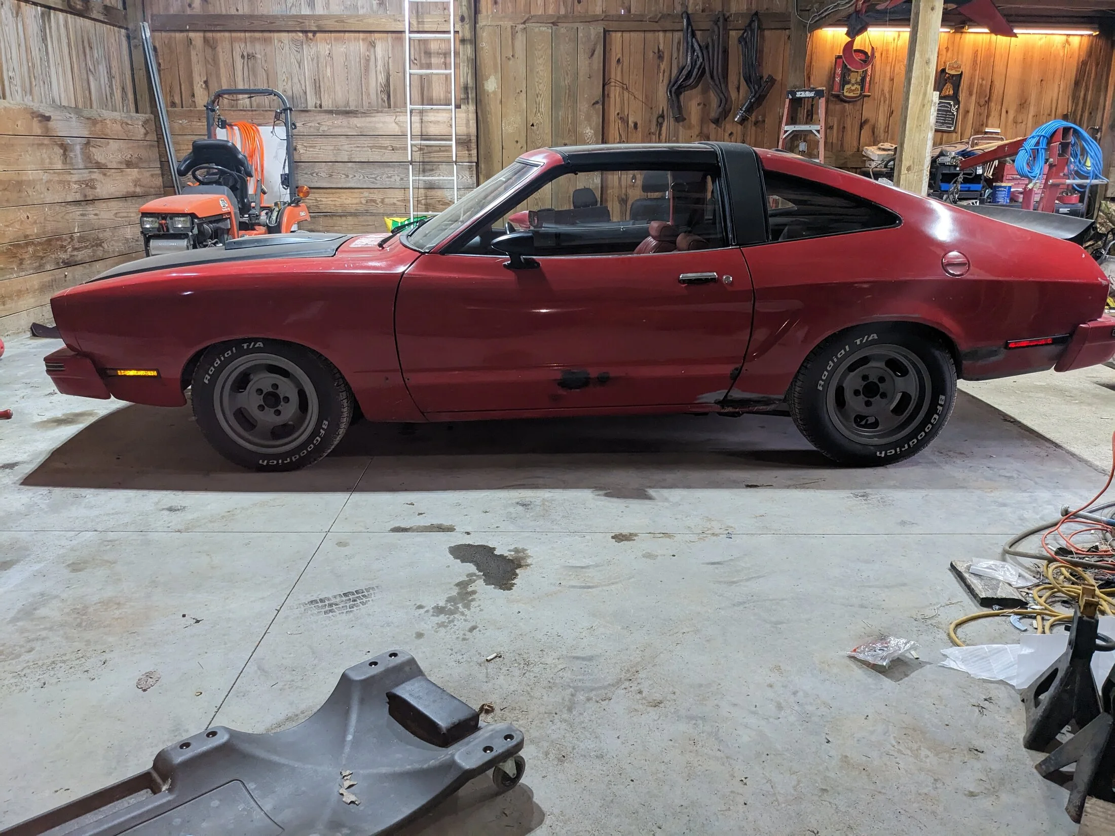

Took another turn out of the push rod. I am now 1/2 to 3/4 turn shorter then I was to start this round. Drove for around 45 minutes. Mostly 35 to 60 mph on back roads. I still have a mild vibration around 60+ mph although it is much better than it was. I would not be worried driving at highway speeds now. Not a shimmy or even hint of pulsation when braking. I wonder if the heat build up / expansion caused the pads to grab vs rotors to warp? I still want new rotors and pads. These have to be heat damaged or glazed. Wonder if the rotors are not balanced correctly? These are obviously a big part of the vibration I was chasing.
Even though I have the push rod shorter than before the pedal feel is much better. Not as good as when they were grabbing but much better than before I started this round. The only change I made was the one wheel cylinder. Only because I blew it apart hitting the brakes with the drum off. I don't see how that helped the pedal feel but maybe something was not right with it from the get go? I made no adjustment to the shoes while apart. I did bleed the brakes again but that was done several times by me and the shop up the street once.
I cannot get over the improvement from the coil overs. The front end is quieter. Handles better. Ride is so much better. I can feel the need for a rear sway bar now. The front end stays planted while the ass end plays catches up. I love how low it is sitting although it rubs when going through heavy dips or with a passenger. I will have to raise the front end for a daily driver but nice to know I can drive it low like this for the mythical track day I will never take it too.
Reactions: Enzio, 2Blue2 and LILCBRA

Looks good! But I might be a little biased as it looks like it sits like mine does.
Reactions: IICrew

Mar 8, 2023
#271
  • Mar 8, 2023
  • #271
They both look good!
Reactions: IICrew, Enzio and LILCBRA

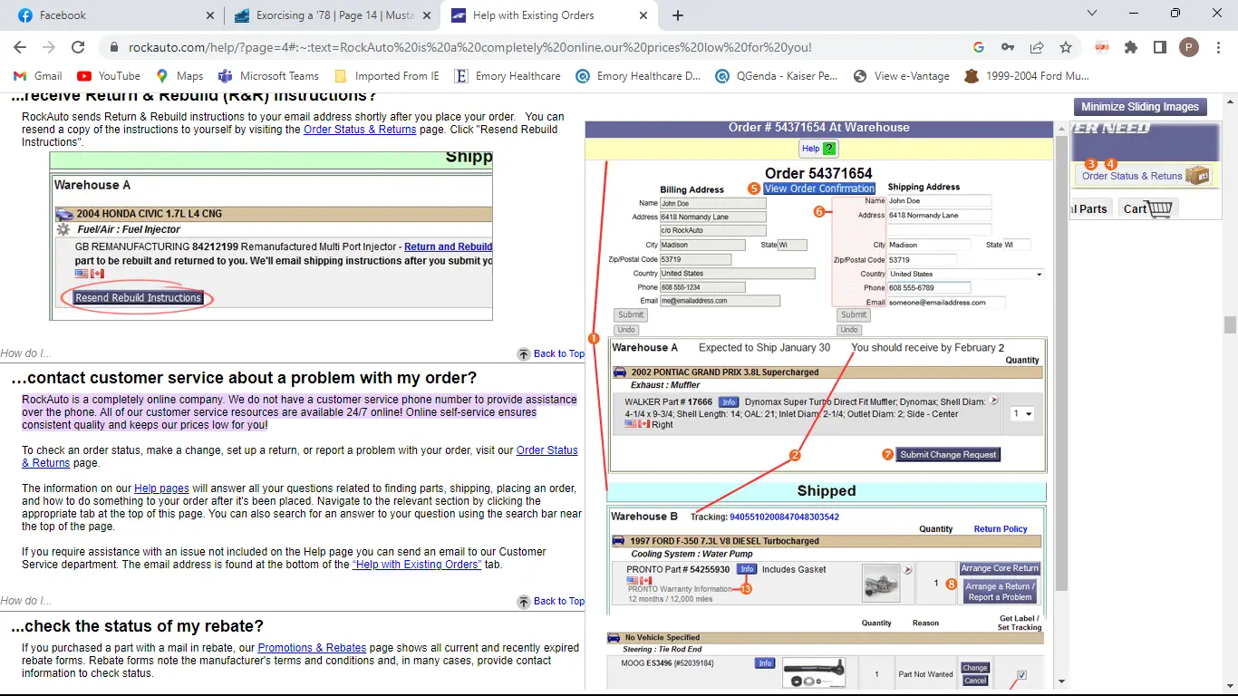

Ordered Sachs shocks from Rock Auto. Webpage had a note it's the last 2 left. So I jumped on them. I received my shocks yesterday yet today the webpage still says last 2 Sachs shocks.
Not that they are lying since I received TRW shocks instead of the Sachs I ordered. Their website does not even list a TRW shock for the II.
Funny thing is I have not found TRW shocks when searching for Mustang II rear shocks anywhere. I did find this part number for a 73 Mustang rear shocks. The 73 is one of the heaviest of the early mustangs. There is no way these shocks can be tuned for both the heaviest mustang and the lightest. Wonder if thats why the KYB are so harsh. They are meant for a car that weighs close to 4,000 lbs but since they physically fit they are listed for a car weighing under 3,000 lbs.
I spent the last 10 minutes trying to find an email address for Rockauto. I cannot find it on their site. All I can find is start a return. I want to talk with someone. Is the listing wrong? If so which listing. Why did they send me a part that they do not even list as an option.
TRW is owned by ZF now too. I guess that is why they sent them. Does not answer my other questions.
I have never had a problem with Rockauto so never needed to contact them. Now I am doubtful I will ever order again from them. If you make it difficult to contact you I don't want to do business with you.

Hope this helps! Their support email is at the bottom of the page. I just googled "contact rockauto customer service"
Help with Existing Orders
RockAuto ships auto parts and body parts from over 300 manufacturers to customers' doors worldwide, all at warehouse prices. Easy to use parts catalog.
www.rockauto.com
service@rockauto.com
You'd think they'd have a link somewhere more accessible....
