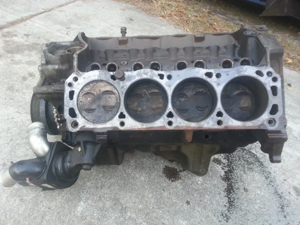

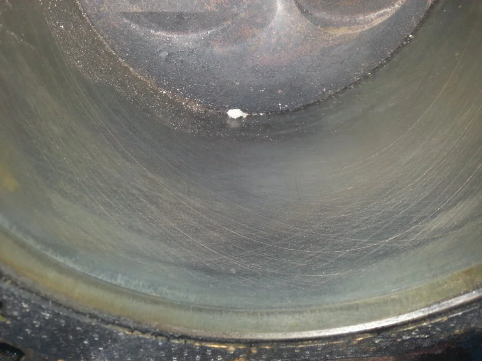

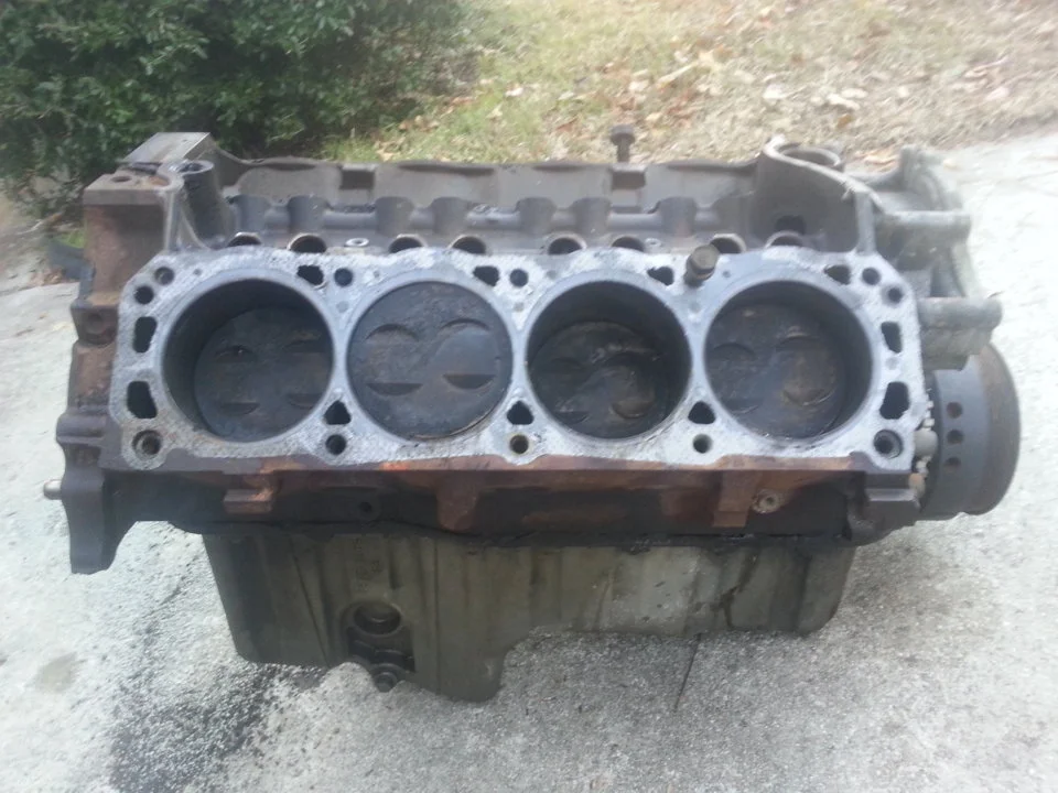

Had 110K on it. Whom ever owned it, appeared to take care of it. Anyone know if the oil cooler can be used in a foxbody?

My oil pump is a Melling High Volume, barely a year old. I cleaned it and flushed it out with fresh oil. My timing chain is fairly new as well. When my N41 walked and took out my drivers side lifters, I replaced the chain when I installed the F303. The new block had pretty good looking rod and mains, but yes I am replacing them with new. I am also putting in new cam bearings. I pressure washed the new block and got it completely cleaned up. Use a wire brush attachment and cleaned the carbon off the top of the pistons. So its starting clean. Tomorrow I am going to flush out the oil journals. I tore my block back apart. The front main bearing was trashed and the brand new (week old) rod bearings are all destroyed. The knock I was still hearing was that main bearing.
