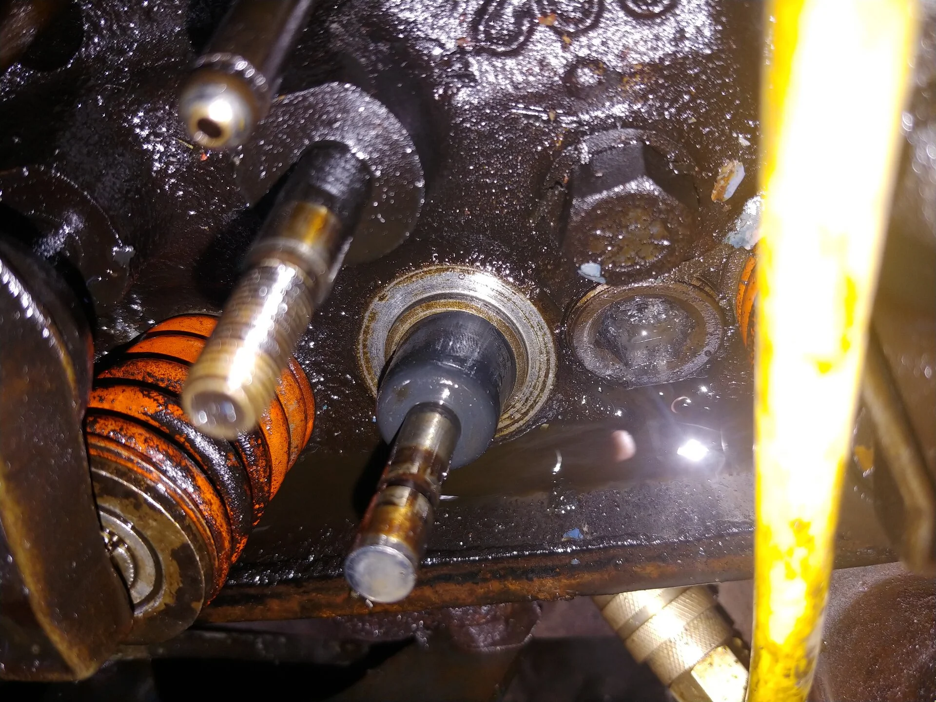

UPDATE: I replaced the valve springs on the 302 in my mustang last weekend. All but one cylinder were totally wasted, I think this car sat for a long time before I started working on it.
Unfortunately the car still smokes.
I tried unplugging the vacuum modulator line to the carb because I heard this could suck trans fluid in, but this did not help the smoke.
Next I did what I should have in the first place and did a dry compression test on every cylinder, it was bad but a consistent 105 psi on all cylinders.
My symptoms are bluish smoke not so much when idling but on/off throttle.
The other problem could be that I used the wrong valve stem seals, I used fel-pro SS 13364-1 for the intake and SS 13807-1 for the exhaust valves. I can guarantee I used the wrong exhaust valves, the ones advanced auto parts listed were way off (compared to the ones that came off the one good cylinder) so I used similar seals that I had laying around for my 351W. Attached is a picture of one of the umbrella seals I used for the intake. My understanding is that they should have a snug fit on the valve and not interfere with travel limits, but other than that what else should I have looked for in regards to bad fit?

Guides leaking tend to smoke 1. at startup, especially parked on an incline. 2. When you let off the accelerator and vacuum pulls oil past them into the combustion chamber. Without measuring parts, I suppose you can move a piston to tdc, remove one spring at a time and check for valve play. A bore scope should also show excessive oily carbon buildup on the back of the valves.
105 psi dry sounds low to me. Did you squirt oil in and retest wet cylinder pressures?
