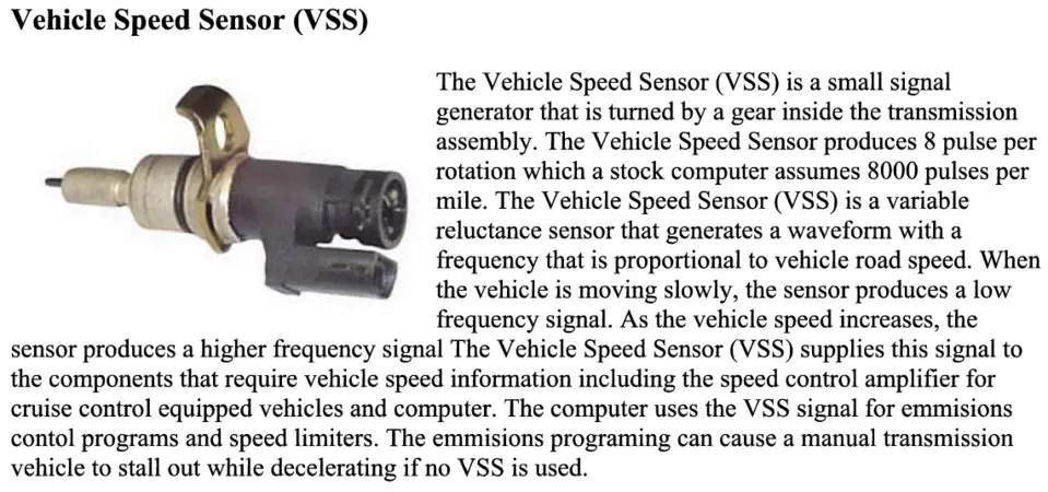

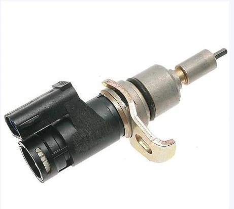

Here is Ford Fuel Injections Info on the VSS. May or may not work with my NP205.
Above here is the picture of the adapter I heard "may" fit my NP205. For $30 I will try it if its determined the 8.8 absolutely wont work.

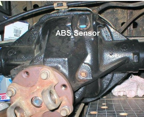

Above here is a pic of the explorer 8.8 ABS/VSS sensor. This supposedly has an identical signal output as the VSS using the tone ring that is on the carrier. I already have this, so if I can use it, much easier, and I can include it with the wire run to the back of the vehicle. No one can confirm though. I was not sure if there is an EEC IV version of this sensor from another vehicle I can stick in my late model 8.8, or if I can just use the ground and the pulse output since I dont need accurate speed to the EEC, just speed in general so it knows I'm moving. I have repeatedly heard the pulses generated are the same on all OBD2 @ 8k pulses per mile. If that is also true with the EEC IV, then this should work fine right?
Thats whats annoying. This seems simple enough, but since I'm wiring everything in the back with the body off the frame, I do not want to waste time hooking this up if it wont do the job.

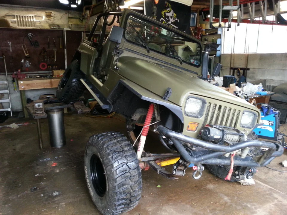

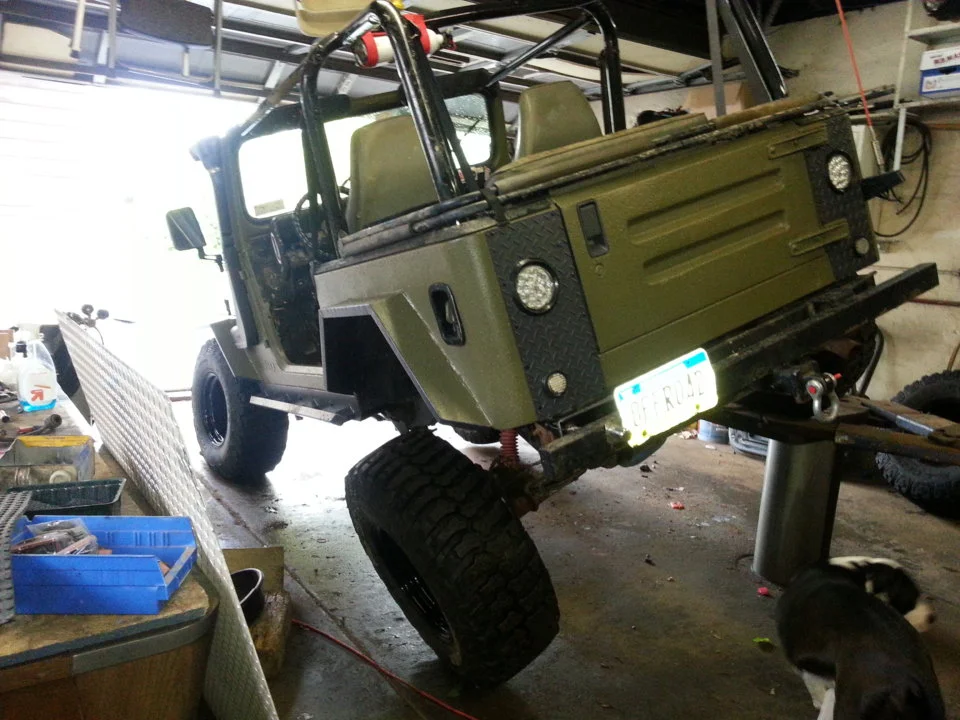

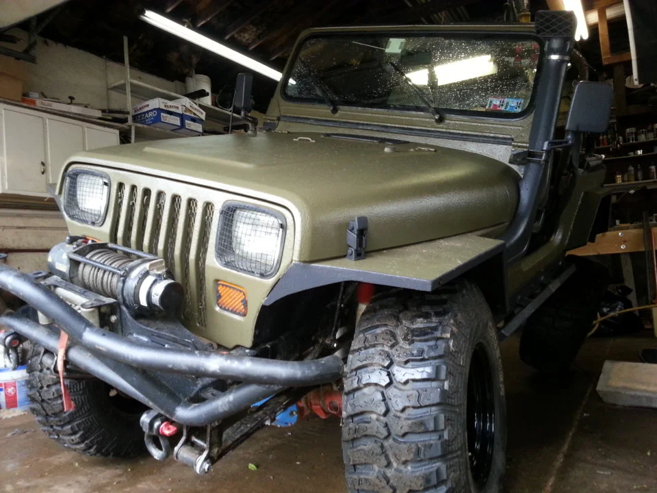

Figured I might as well throw in a few pics of what this is going in. I think these are the cleanest pics I have. Thats on 33's. Not enough power for the highway with the 7" lift when driving through the mountains. A V8 made more sense than a regear.
Thats the cleanest it ever was BTW. Just flex testing with my lift after the last drivetrain rebuild I did before tearing it apart again.

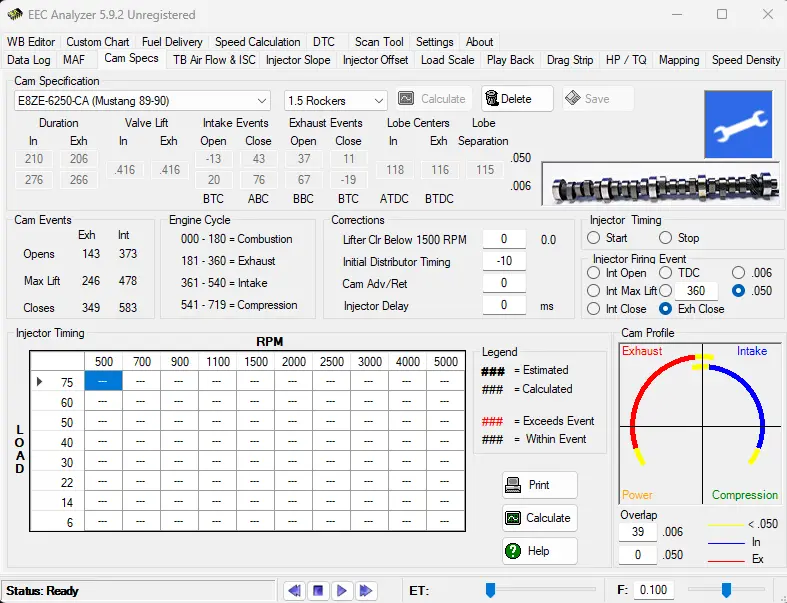

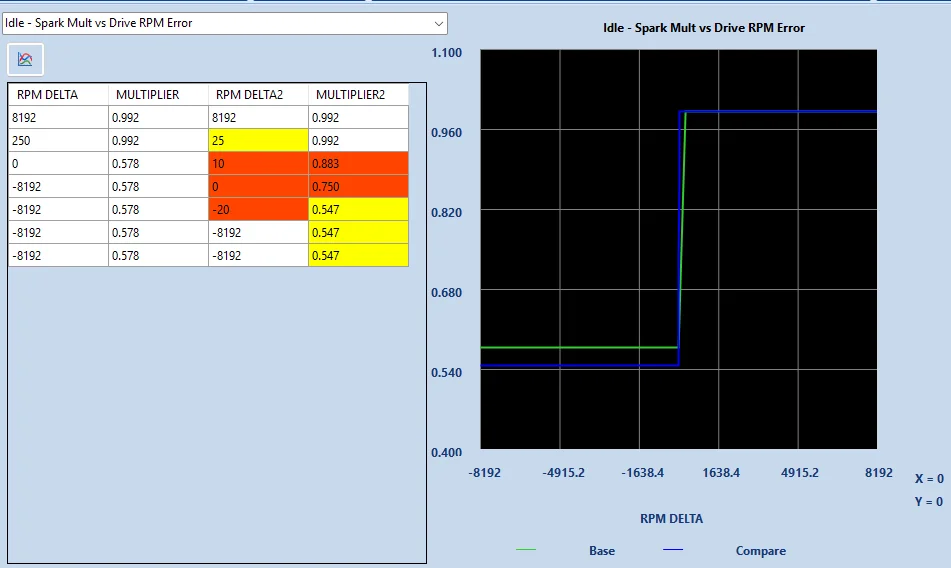

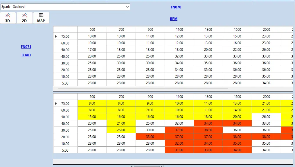

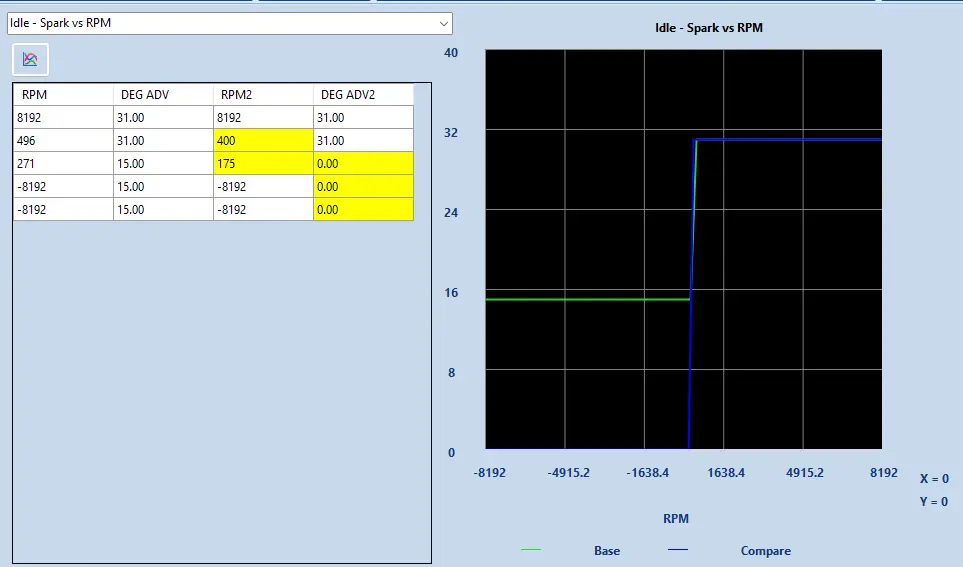

I know this is an old thread but the info Im about to lay down still stands to this day...

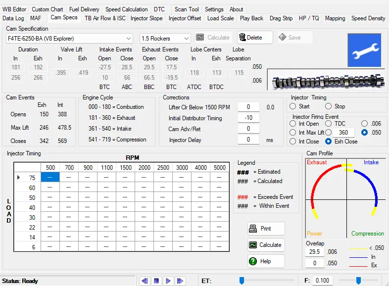

Anytime you waiver from the engine and camshaft that came with you must tweak the parameters to match the camshaft..

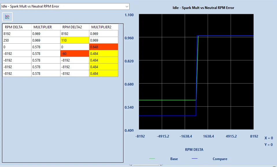

When I did my 1993 351w swap with F4TE Explorer Roller Camshaft running on an A9L I had to rescale alot of the parameters especially the fuel injection timing table and alot of the ISC settings like neutral idle air and drive idle air aswell as 'Idle - Spark Mult vs Drive RPM Error / Idle - Spark Multiplier vs Neutral RPM Error.
On my Mustang GT engine the camshaft specs with fuel injection timing table looked like this............As you can see the Mustang GT cam had alot more overlap than the F4TE Explorer camshaft a lil lower down..

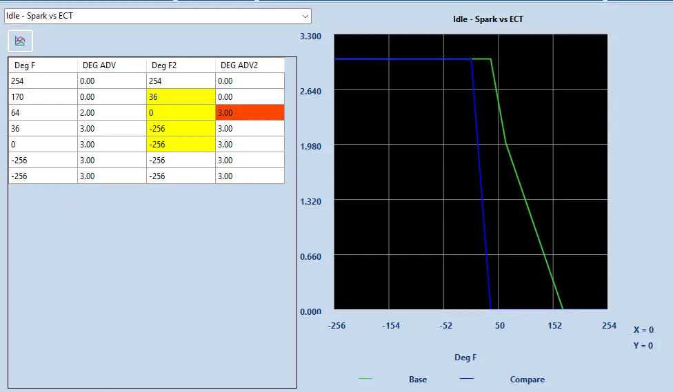

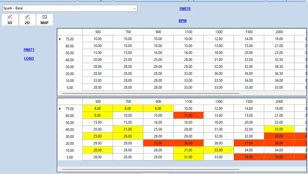

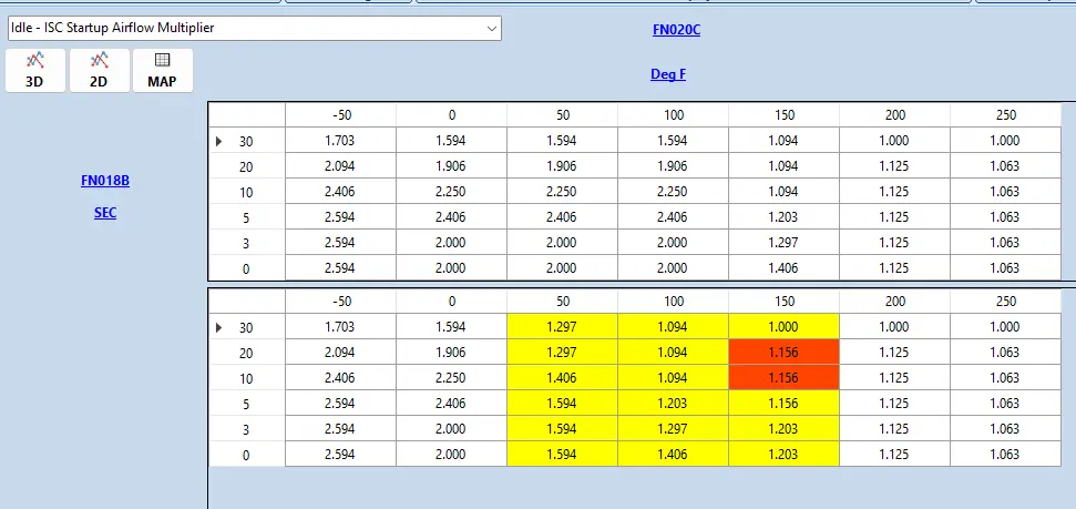

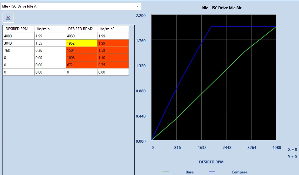

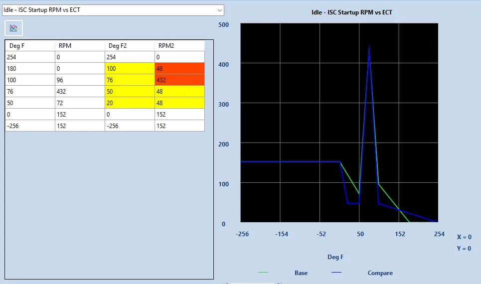

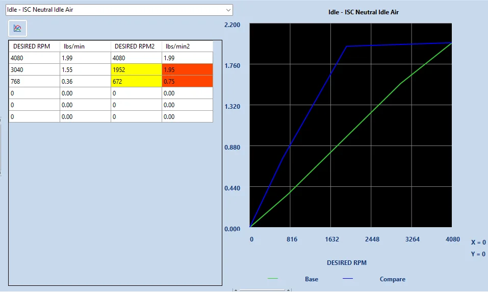

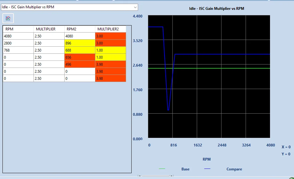

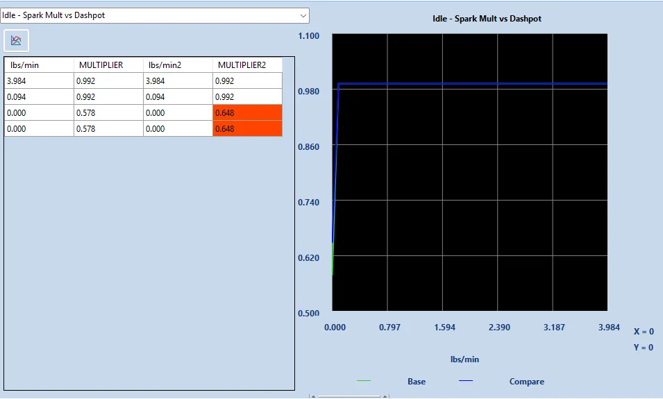

Other things I had to do was rescale the fuel startup tables, and spark tables too to stop the engine from running rich and stop surging especially in stop n go traffic.....
My values are on the leftside on some posted below and also the upper quadrant...The stock A9L values are on the right or the lower quadrants...
Screenshot 2025-06-07 211813.webp Screenshot 2025-06-07 211724.webp Screenshot 2025-06-07 211651.webp Screenshot 2025-06-07 211450.webp Screenshot 2025-06-07 211427.webp Screenshot 2025-06-07 211400.webp
Screenshot 2025-06-07 211321.webp Screenshot 2025-06-07 211242.webp Screenshot 2025-06-07 211200.webp Screenshot 2025-06-07 211132.webp Screenshot 2025-06-07 211052.webp Screenshot 2025-06-07 211026.webp
It would be alot easier to put the same spec camshaft from the Mustang 5.0 engine into the Explorer 302..............
Like stated above I know this is an old thread but is still able to be found in an internet search and doesnt seem to have the answers that most who do a similar swap needs.............
