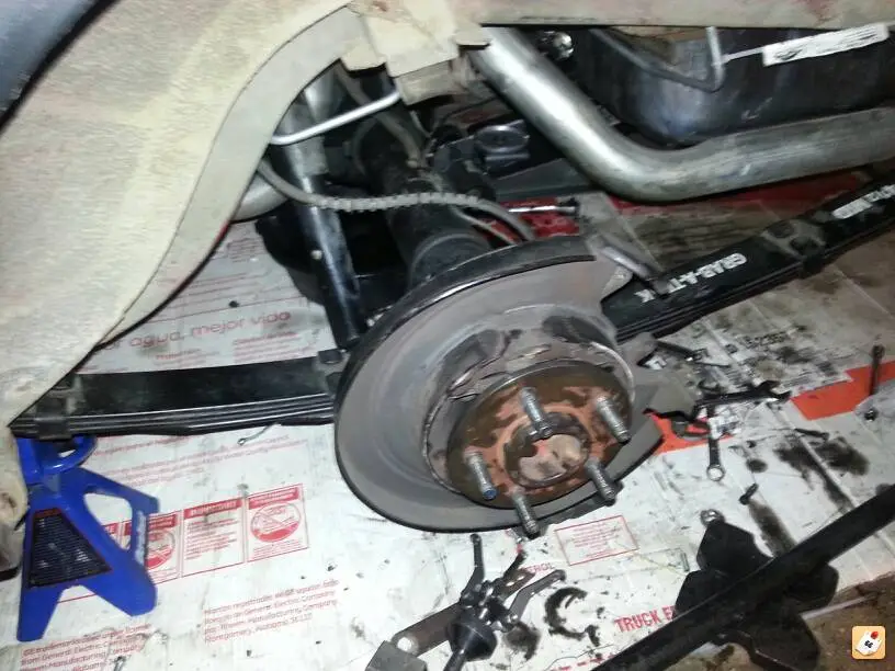

I put an explorer 8.8 in my car. Axle is 2" too wide, and the diff is offset 4". I cut off the ends and swapped them side to side after removing 2" from one end welded them back on and called Moser for a new set of axles. It is not quick or simple, but it is a great axle, and I have a whole lot less in it than a 9". 31 spline, 3" axle tubes and big bearing ends, disc brakes already on it and a good selection of diffs and gears. What's not to like?
one of the easier swaps i did...96 explorer rear in my 66.. cut the old perches off..placed rear on leafs centered it under car..measured ...put new perches on and welded them in..at stock pinion angle
used the rear flange from the explorer shaft on a custom alum driveshaft..though u could prob cut your stocker down..and use the explorer flange with a 3030/3010 u joint
the offset carrier was no biggie..i used 96-2004 mustang wheels which had the perfect offset for the rear..
my car is lowered..the u joint hit the tunnel..i clearanced it with a BFHammer..solved and doesnt look bad..
for about $200 I have an 8.8 rear nearly as strong as a built 9 inch that would have cost over two grand..it has five lug, disc brakes,31 spline axles, 373 gears and trac lok....best mod on the planet
