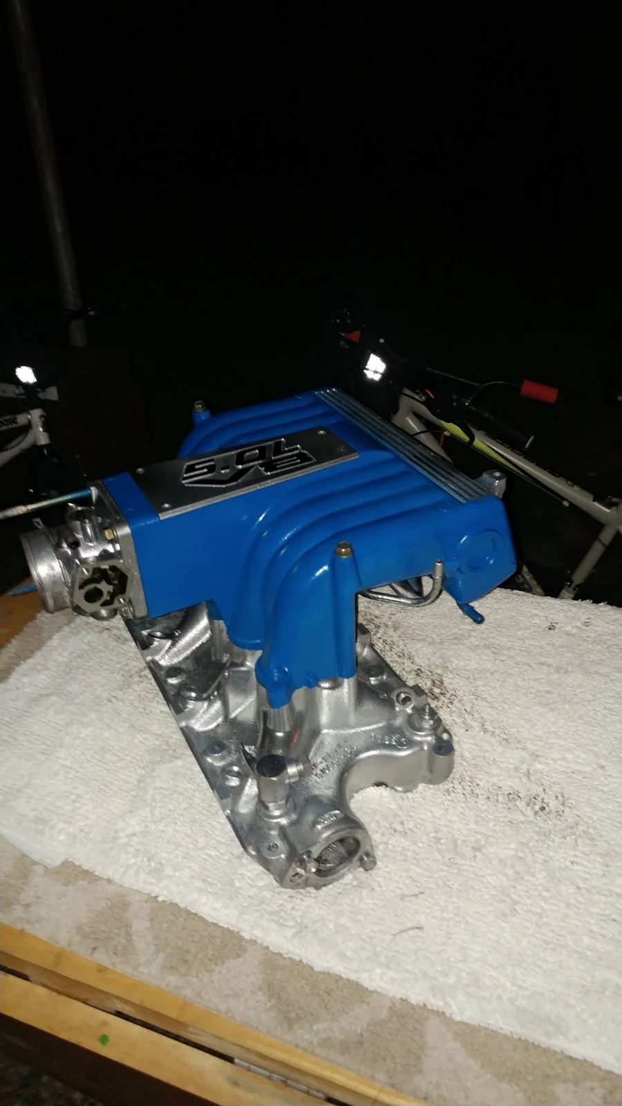

ok got the intake all cleaned and painted it, looks ok, I also put the 65mm tb on it from the explorer, can I run the tb just like how it is on there or do I put my stock egr on there or do I buy get 65mm egr spacer, I also started working on the gt40 heads I,m going with the same color,im waiting on my trickflow springs and rollor rocker to come in, also does anyone have any suggestion on which cam would be good, thanks

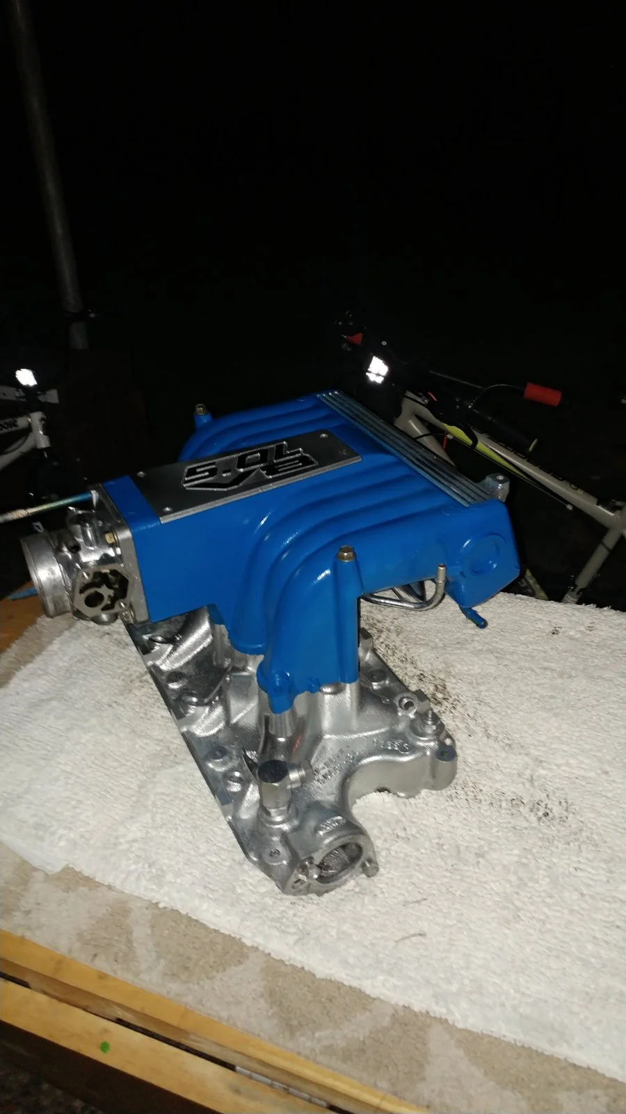

ok but do I have to run a egr unit at all, iv seen pictures of people not running one just like mine in the picture, don't know if it matters but my whole smog system has been removed,thanks guys for any help
No you don't have to run the egr, you will have to either make a bracket or buy a spacer that will let you bolt the accelerator bracket on. I did the spacer thing years ago, I put the egr back on, don't remember why.
