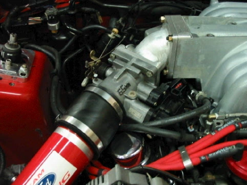

TB attached....bolted the throttle cable bracket and thats cool and lines up...

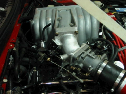

EGR....you can see the mother just touching the VC....i have the b-off plate on...not gonna dub with the EGR, but it looks like everything would line up as the stock upper...

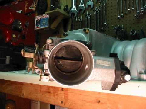

Mac adapter with the TB installed...i had to blend this in some once i opened the throttle blade...overall its a nice sweep thru it...for blending all 3 together....i couldn't leave it mis-matched....

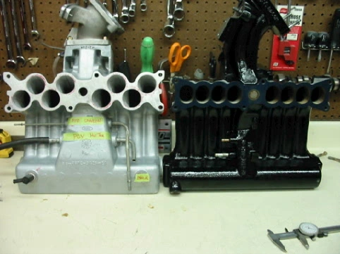

Ex versus stock ports on the upper....the GT40 is much nicer than the stock one...the lower is the same to boot...these were both gasket matched...

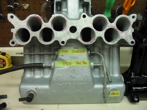

Vac line routing....i lost the vac connector on the stock elbow...i would have to drill the Ex and tap it to get the Vac Tee/ FP/EGR feeds...
you need 4 vac feeds...i gave then all separate feeds...little mod work yet to do routing the lines....

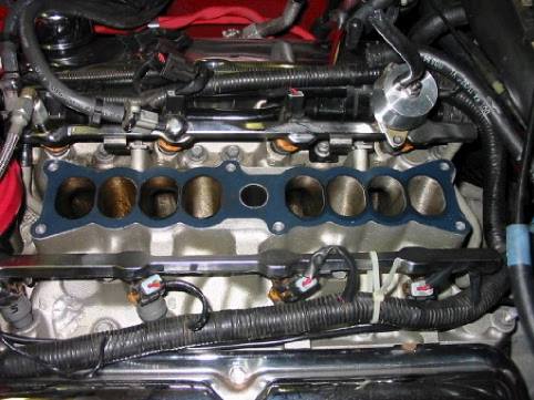

Hey Tom...check this pic....whats up with the back cylinders??? everytime i pull this i see the cleaner ports out back???? looks like the fronts get more fuel...
took this one to show you...

Somehow your PVC gases must be finding their way to the back side of the intake. It's oily residue right?
RIO5.0
Feb 16, 2001
6,892
128
N.H.
Nov 11, 2003
#32
  • Nov 11, 2003
  • #32
Yes its oily....it worse this time since the heads went on....maybe its not venting enuf???

The PCV valve vents engine pressure, which normally comes from blow-by. Maybe you added some compression with the heads and increased blow-by some. I wonder why it's showing a bias to being sucked into the rear runners. That would seem to indicate more blow by at certain points in the 8 cylinder firing order. Done any compression tests lately?

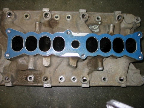

Tom....thinking back, my old motor showed the same thing when the upper was removed. that was prior to the heads??? so its nothing new..
look at the original intake i removed...it was pure black all around??? maybe the ports are to smooth..and its causing it...

all stock unit...

Rio - i get the same oily residue in my intake...

  • #40
looks like the higher pressure is doing some thing funky....i would think better venting is in order???? have to search around on that.....
Is your as casted??? or did you clean it up any???
