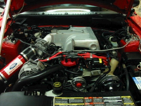

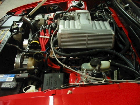

Git a few pics to add so its all in this post...Gonna paint it up over winter, so its kinda stank sanded here and there..

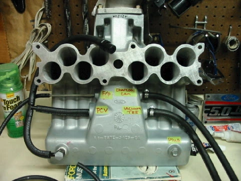

The vac line routing....had to use all the ports with the exception of one that i blocked with a bolt and some RTV...
Edit...on the PCV...i opted to run 8" of line, this will put a "lift" to that line and possibly keep the oil from getting into the intake, thought being the height will suspened it and let the oil fall back versus heading to the intake...remember the "oil mist" in my ports. before this was a level line to the intake...seen this suggested and thought i'd try it out...
