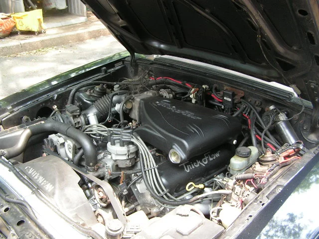

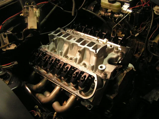

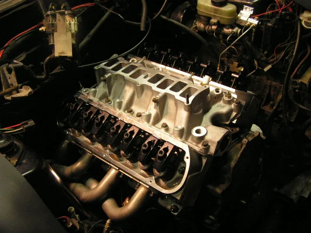

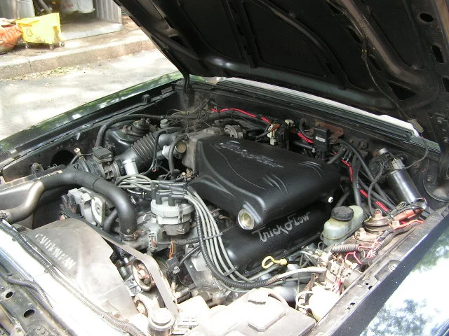

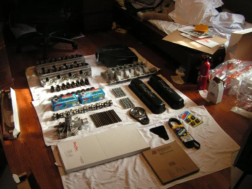

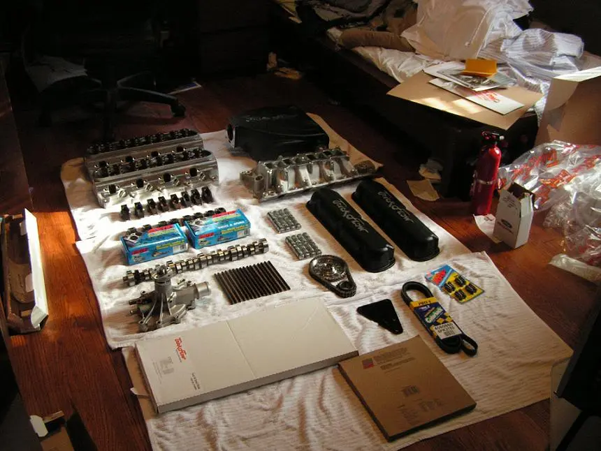

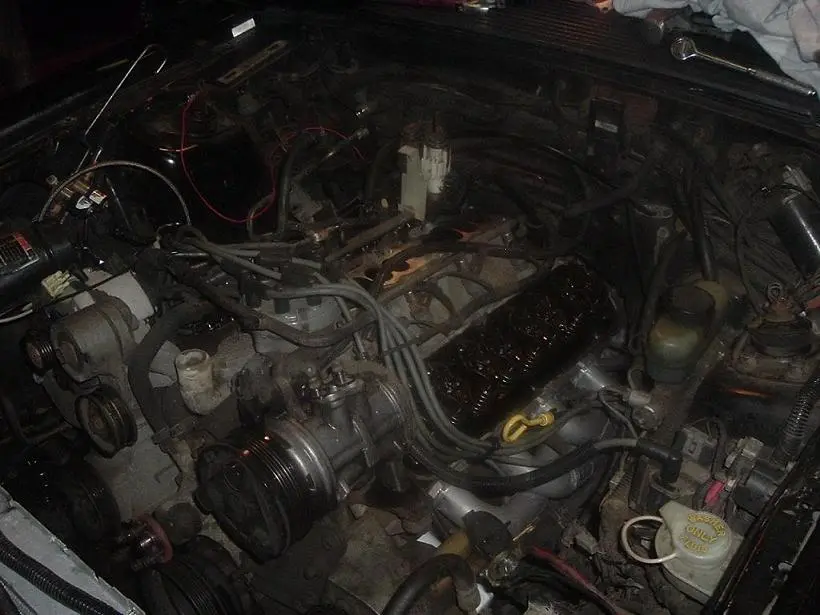

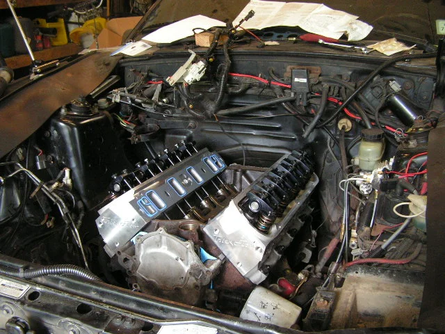

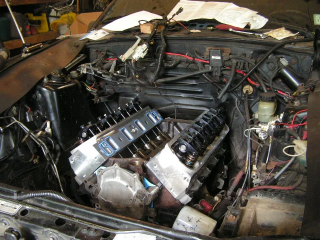

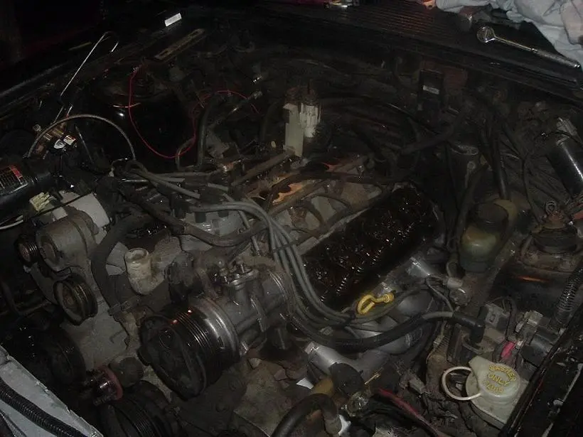

I myself have the TFS top end kit. The difference you will feel between stock and some nice aluminum heads is beyond night and day differences, its not just the hp difference you feel but you no longer hit that wall at 4800rpms, which is nice.
I have a stock bottom end as well, and I do not regret doing it, if the bottom end fails, big deal, new bottom end and swap all the parts over. The TFS kit is very complete and very good quality, the only thing I didnt like about it were the valve covers, you have to drill a hole for the oil fill, and it usually leaks a little bit of oil, nothing major, just annoying.
Overall I love my TFS kit, your getting an awesome set of heads with the kit, a very good cam and matched intake, you really cant go wrong.
BTW, Im running all of this on a stock TB, stock ignition, stock injectors, stock MAF. Works fine and I had no problem walking away from my buddies mach1, and my other friends vortech 95 cobra (6psi). I used to race the mach1 a lot before the swap, and even with an 80 shot of the juice, he would just walk right away from me.
Yes I agree more power is to be had with a bigger TB, and MAF, but it is far from required. I definitally recommend it. All in all, after a new water pump and lifters I spent about 2,600. Best 2,600 Ive spent on my car.
Heres some pics for ya.
Before
After
