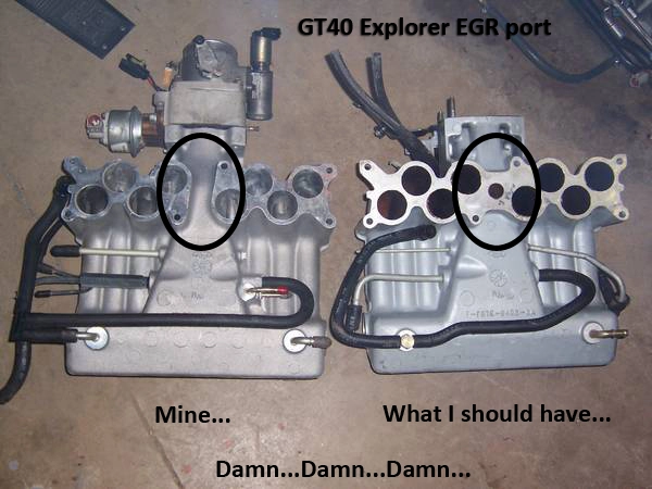

There are two main versions. The early version had provisions for EGR, while the later doesn't. Pretty easy to visually tell them apart. There are minor differences between the two main versions such as vac line placement on the upper intake. Basically, the earlier the intake the easier the swap onto a Fox.
Easy way to determine which is EGR with part number is to look at the lower intake p/n. Look at bottom of this page.
