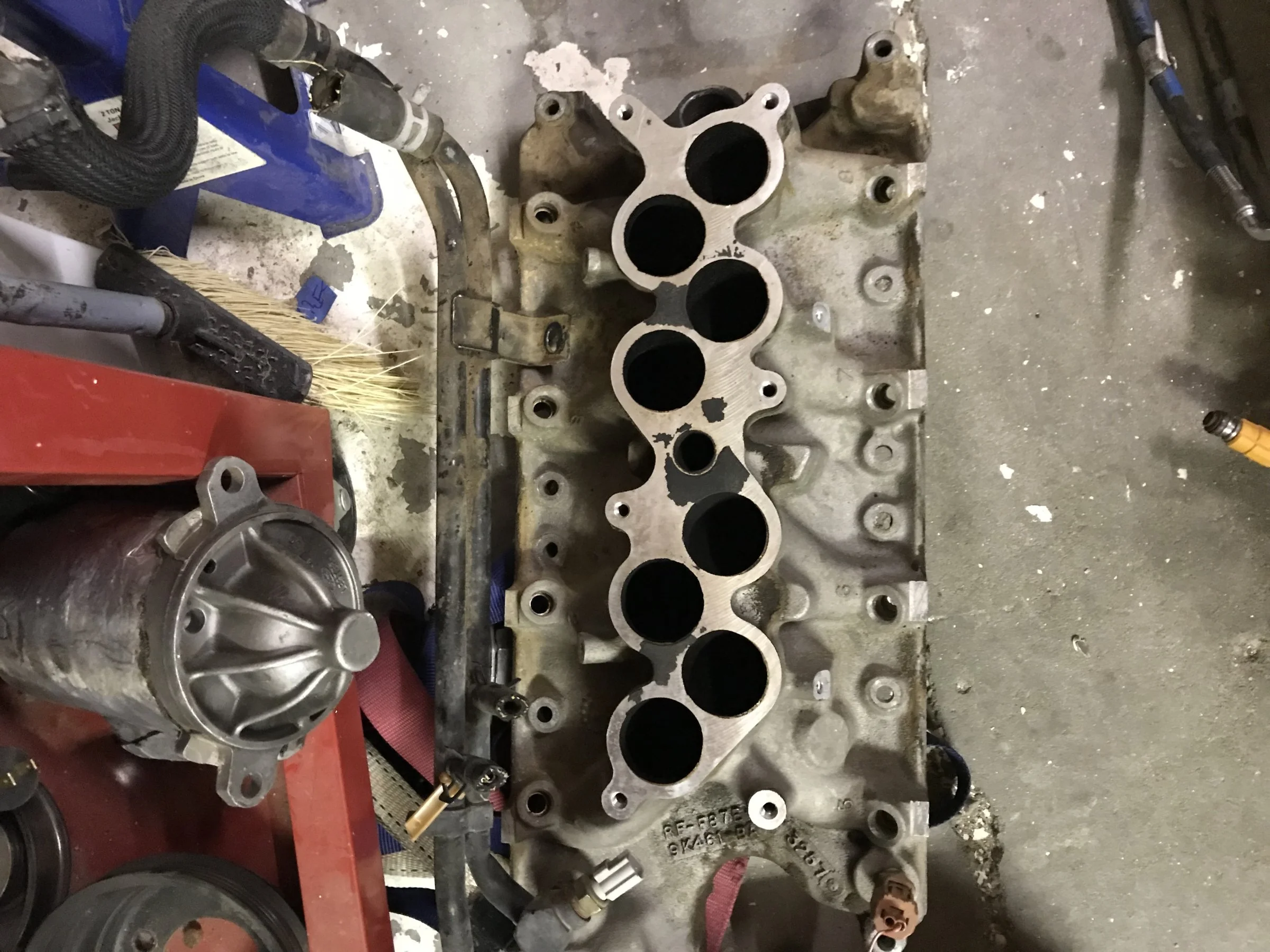

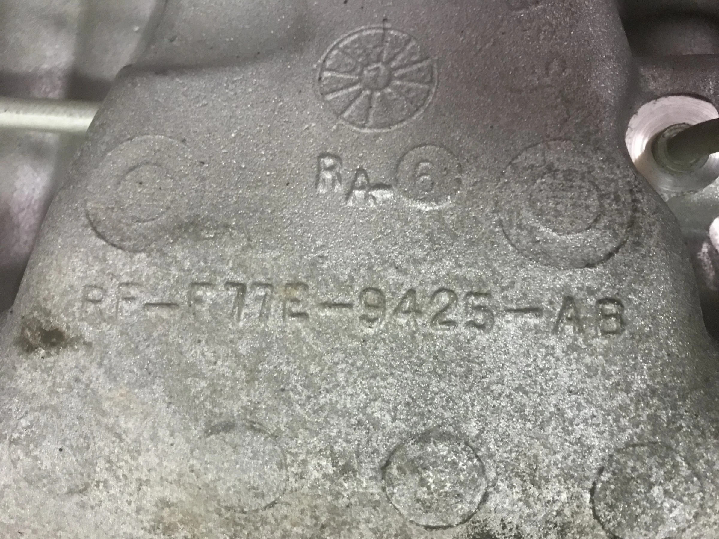

Sorry, here’s my picture.

That's the correct intake, notice the egr passages in the center. I believe the 97 and later intakes have the remote egr.
Oh and I see 3 different posts about explorer intakes from you sir. Let me fixorate that
Thanks man, I suck at posting stuff sometimes. I was worried when I pulled it off the vehicle this morning at pull and pay that it was the wrong one. Funny, it was off a 98 Mountaineer. So just to be sure, that’s the intake I would want to use?

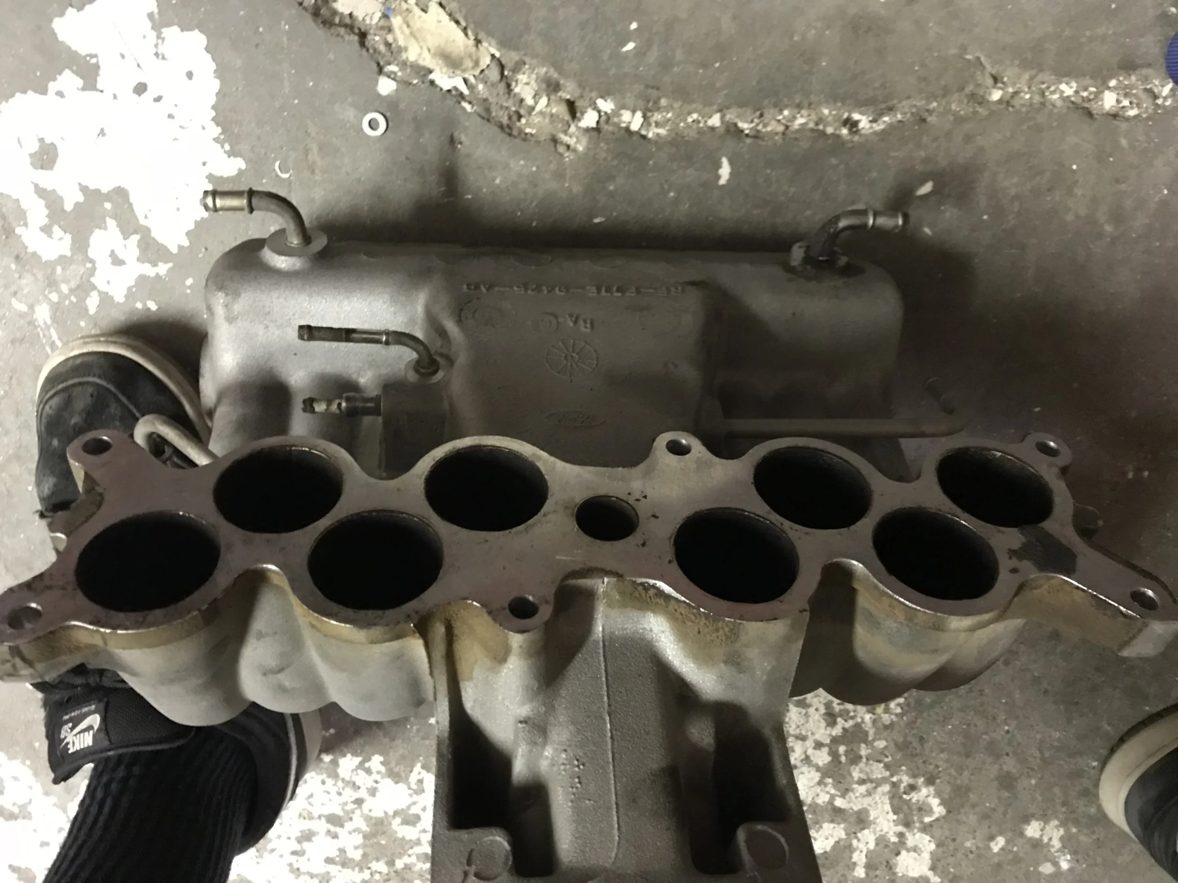

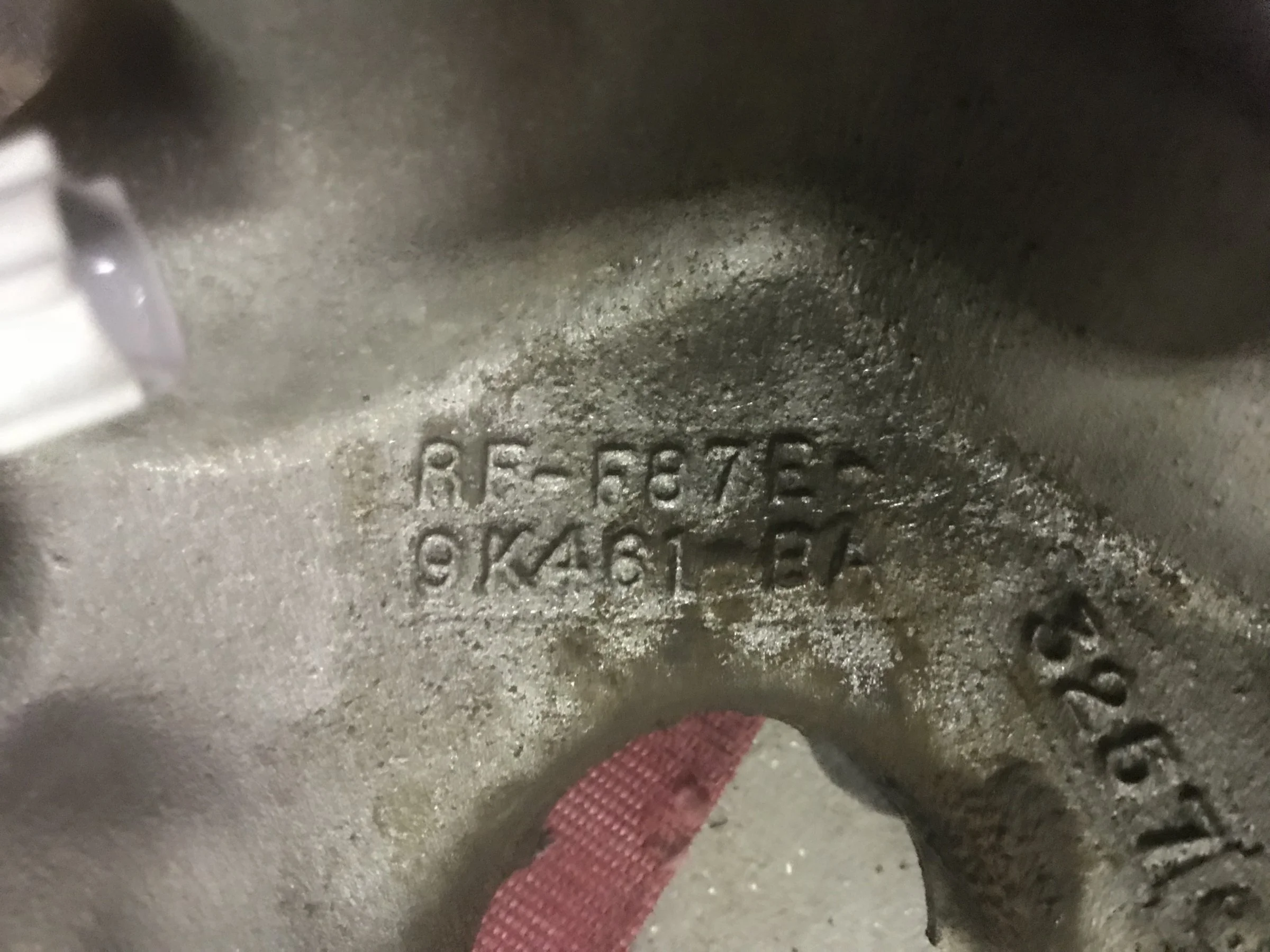

These are the part numbers off the lower and upper intakes.

Cool, thanks guys. I’ve learned a lot the past couple days on these things. I was at you pull and pay, saw one and just grabbed it. I figured I could always return it or sell it if it wasn’t the desirable one. Is there any thing I need to do differently when installing it versus stock?? Or is it plug and play?
