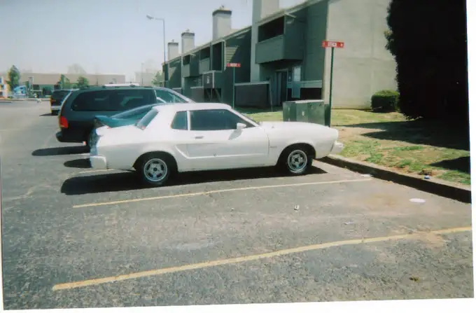

this is eos's car. what spoiler is that on his car? and what would that look like with the front chin spoiler?

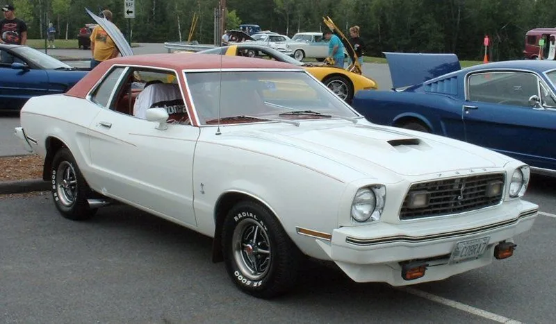

Here's a pic of my old 351 Ghia with a snorkle scoop:

HER spoiler. ;) :p And It was on there when I bought the car. I've been told it was from an early 80's model T bird. But I don't know how accurate that is. :shrug: I'm sorry I can't be of more help.
