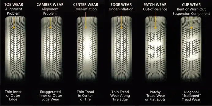

Inside wear can also be attributed to too much toe-in or toe-out.
In fact, improper toe will wear the front tires down quicker than improper Camber angle. Bad Camber takes a while to materialize in the tire. Bad toe can happen in a few thousand miles if it’s severe enough.
It can be aligned correctly, but old worn bushings can allow flex in the a arm as the car pushes forward. This can cause the wheels to toe out. Dial in a little natural Camber (I believe factory spec is about 0.5* in) and it will chew up the insides in no time.
Given the car is 17 years old, you’ll want to check the condition of the bushing and put a pry bar on the arm to see if there is excessive movement
